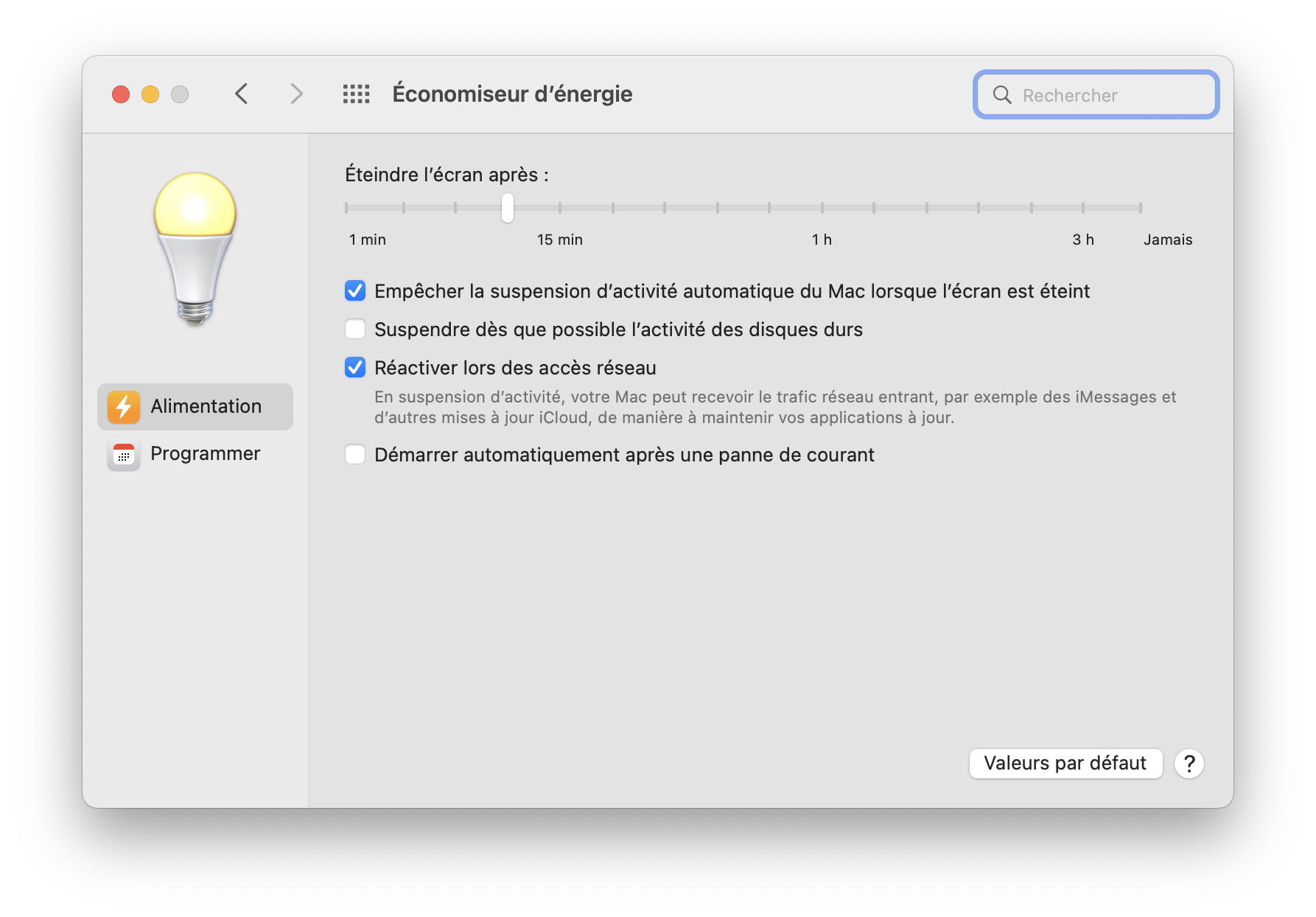

Hi all ! Since I got my M1 Mac mini, I've had bluetooth issues : Laggy/stuttering trackpad.
If it can help, I've solved the problem by doing this :
> Uncheck "prevent automatic sleep" in system settings (sorry, in French in the screenshot...)
> Never use Cmd+Alt+Eject that make the Mac mini in sleep mode (I just turn off the screen)
This way, I almost never had bluetooth issue. Sometimes bluetooth becomes very laggy (don't know why), then I do in terminal
Bash:
sudo pkill bluetoothd
I do it approximatively one time a month because somtimes every bluetooth devices (keyboard, trackpad, headphones) are going crazy (i.e. Very very strong lag)
I'm pretty sure that bluetooth issue is software and not hardware
