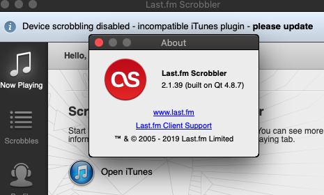

Asking again, nobody here using a Last.FM scrobbler with iTunes on Catalina?
All the ones I tried don't work (even when manually adding the permission at Privacy→Automation
The official app is missing the iTunes plugin

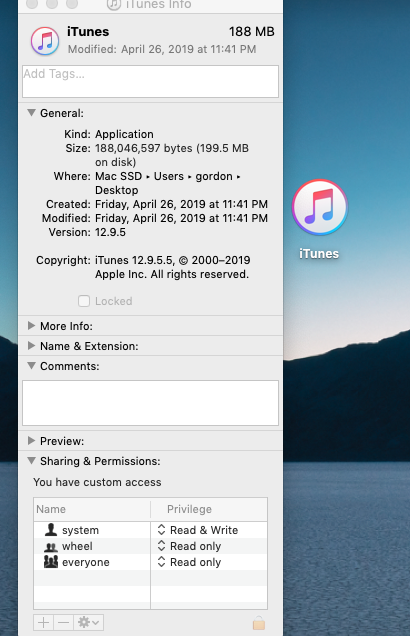

Using the solutions in this thread, I was able to restore iTunes 12.9.5.5 on Catalina.
However, after updating Mac to 10.15.2, iTunes will no longer play songs. When clicking the play button, nothing happens.
I assume when updating Mac, it corrupted the iTunes profile or overwrote or deleted something, or is Apple actively trying to kill iTunes for those of us that found a way to keep using it?
Either way, any thoughts on what probably happened and how to restore iTunes? Obviously, if I have to reinstall iTunes every single time I update Mac, I'll just concede and start using Music. :(
But, if there's a more permanent way to keep iTunes stable for years to come, I'll jump through some more hoops. :)

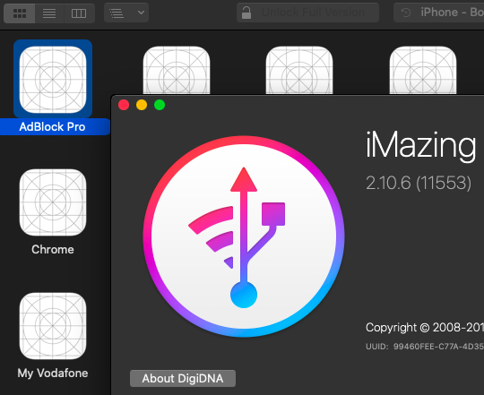

I haven't used iMazing before, but it seems to have the same problem

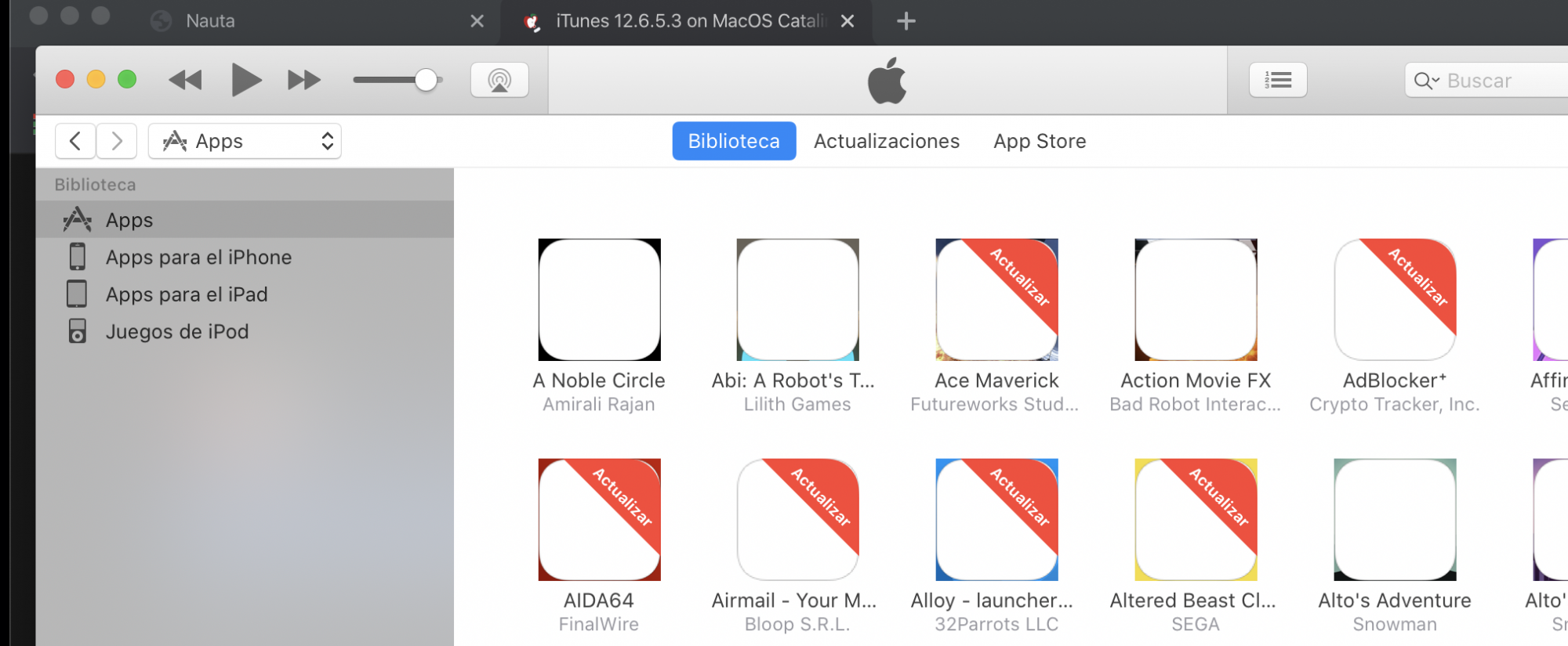

iTunes 12.6 and 12.9 work for me in Catalina 10.15.2 (19C57), try to install the iTunes 12.9 pkg again.
