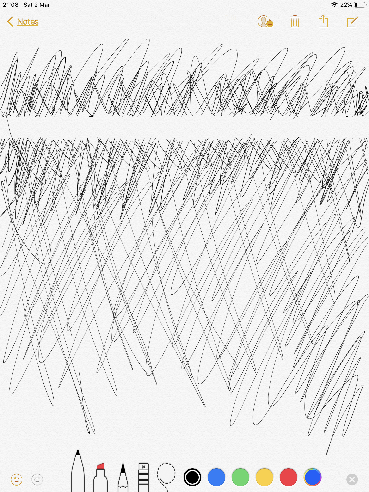

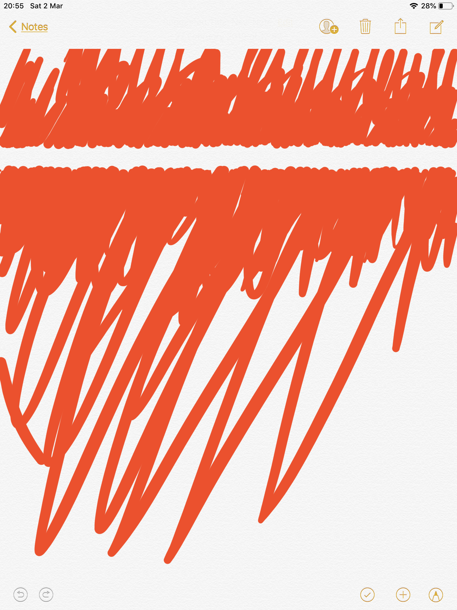

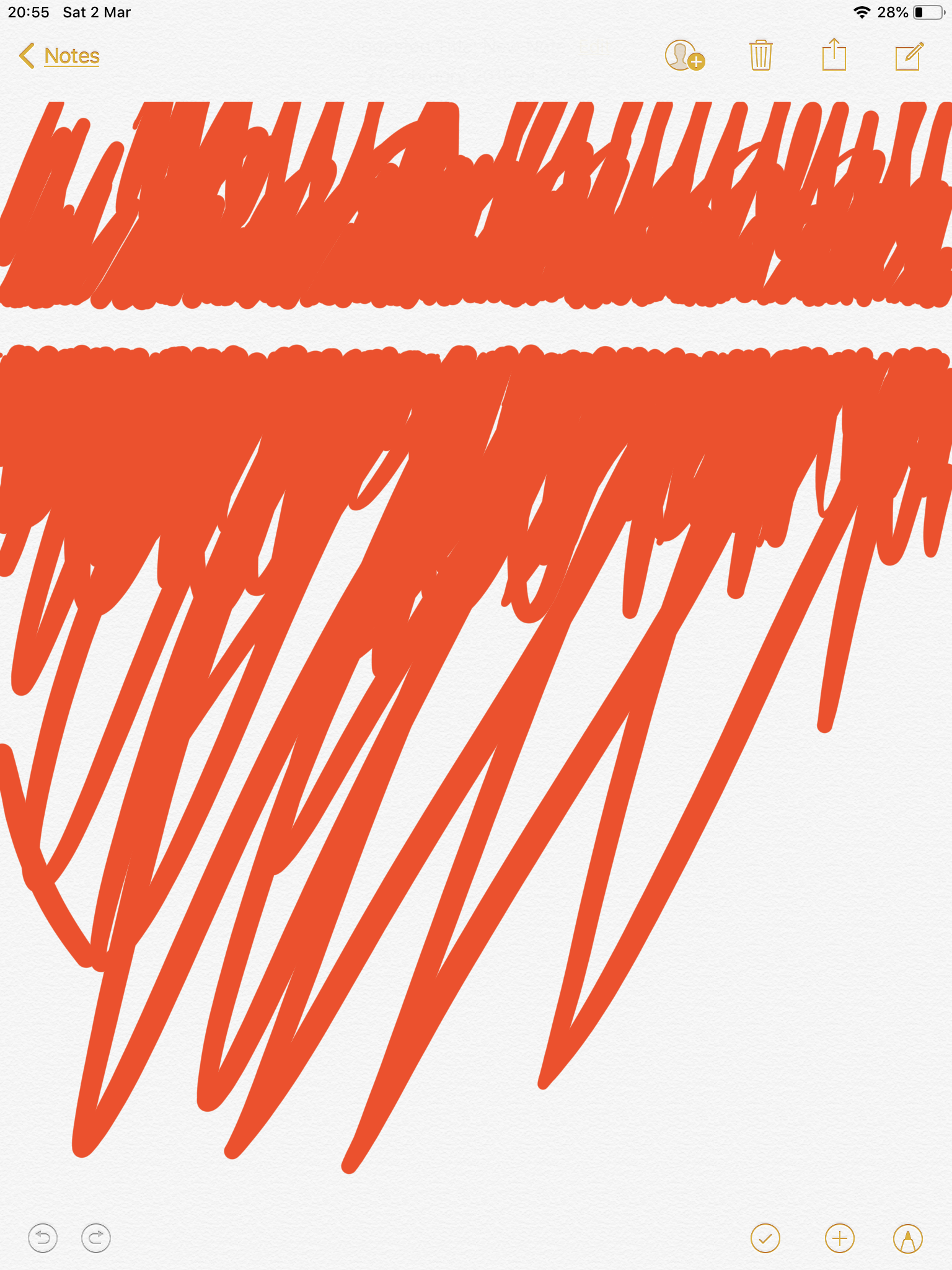

I don’t know if the problem shown in the photos below is the same with other users but nothing seems to work, I have tried hard reset, factory rest but the problem persists.
Doubt it. I believe what others are referring to is not isolated to a particular part of the display but a wholesale pause in response to touch virtually anywhere on the screen for several seconds or more.
On my gen 2 12.9 I feel as though pull down of notification shade and control center will still work more often than not while the problem with other touch input persists throughout the pause.
Yeah! Same on my side, it did definitely start with iOS 12. But the fact that the problem doesn't go away even after a hard reset and some people experience it and some don't makes me think it's a hardware issue that develops over time and iOS 12 update is coincidental.
