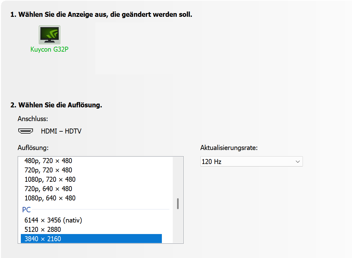

I also see that the monitor can run at "4k 120Hz". Has anyone tried this and verified that it's actually 120Hz, or is this just a software bug and it's just a typical downscale to 4k 60Hz?
Reactions: Dark-Signature
Impossible! You must be mistaken!
HOLY **** ....

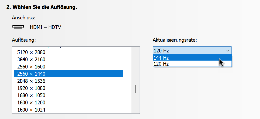

And even in WQHD i am offered with 144 Hz:

I just tested it and my impression is that the Kuycon G32P actually allows higher frames per second (FPS) in other resolutions. The maximum limit seems to be 144Hz (at least with HDMI 2.1, maybe someone can verify this with Thunderbolt 5 or DisplayPort 2.1). So up to 120Hz is possible with 4K, and up to 144Hz with WQHD (2560x1440)!
I can't believe it... why wasn't this advertised?! That's awesome! :D
