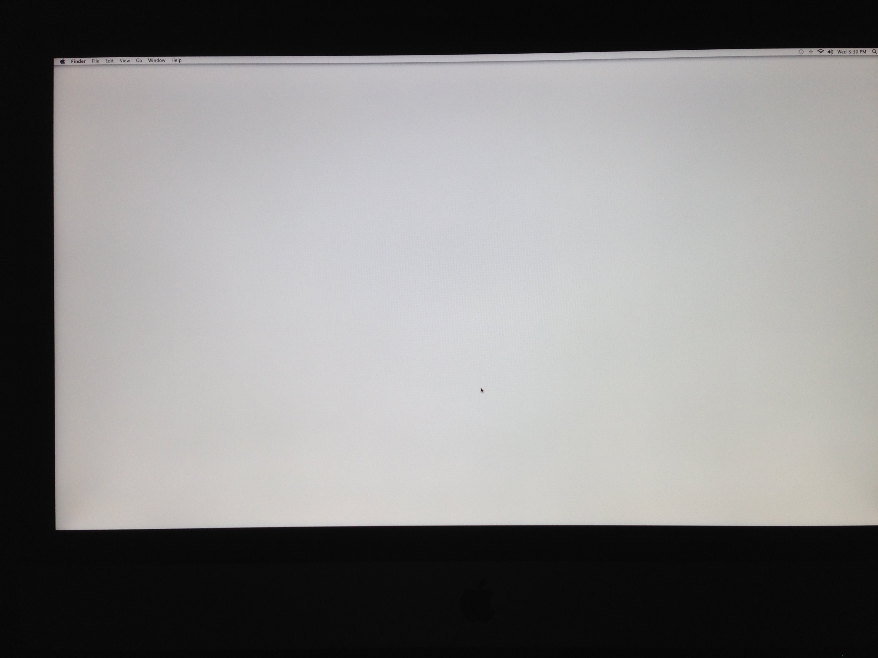

Unfortunately, it has very noticeable yellow gradient going from cool on top to warm. In addition, it has some bad backlight bleeding on the right corner edge.
So there's some proof that where the iMac is assembled does not equate to yellow free screens. I will pack the iMac back up Monday and ship it off and try my luck again. I think I may go through 3-4 returns/exchanges before giving up.

I picked up a new 27" iMac last week from Futureshop, and it had a noticeable yellow tint in the bottom fifth to quarter of the screen. I returned the machine, moreso for the eye strain it caused, but I would have returned it for the yellow tint if eye strain hadn't been an issue. If I figure out the eye strain thing, I'd order directly from Apple next time and hope that I get one of the non-tinted screens.
My bottom is a little warmer, but I can't see unless I really want to, and it is so difficult to notice that I forgot for weeks until I reach this thread. No image retention and zero backlight bleeding. I love my 27"iMac. Don't give up!

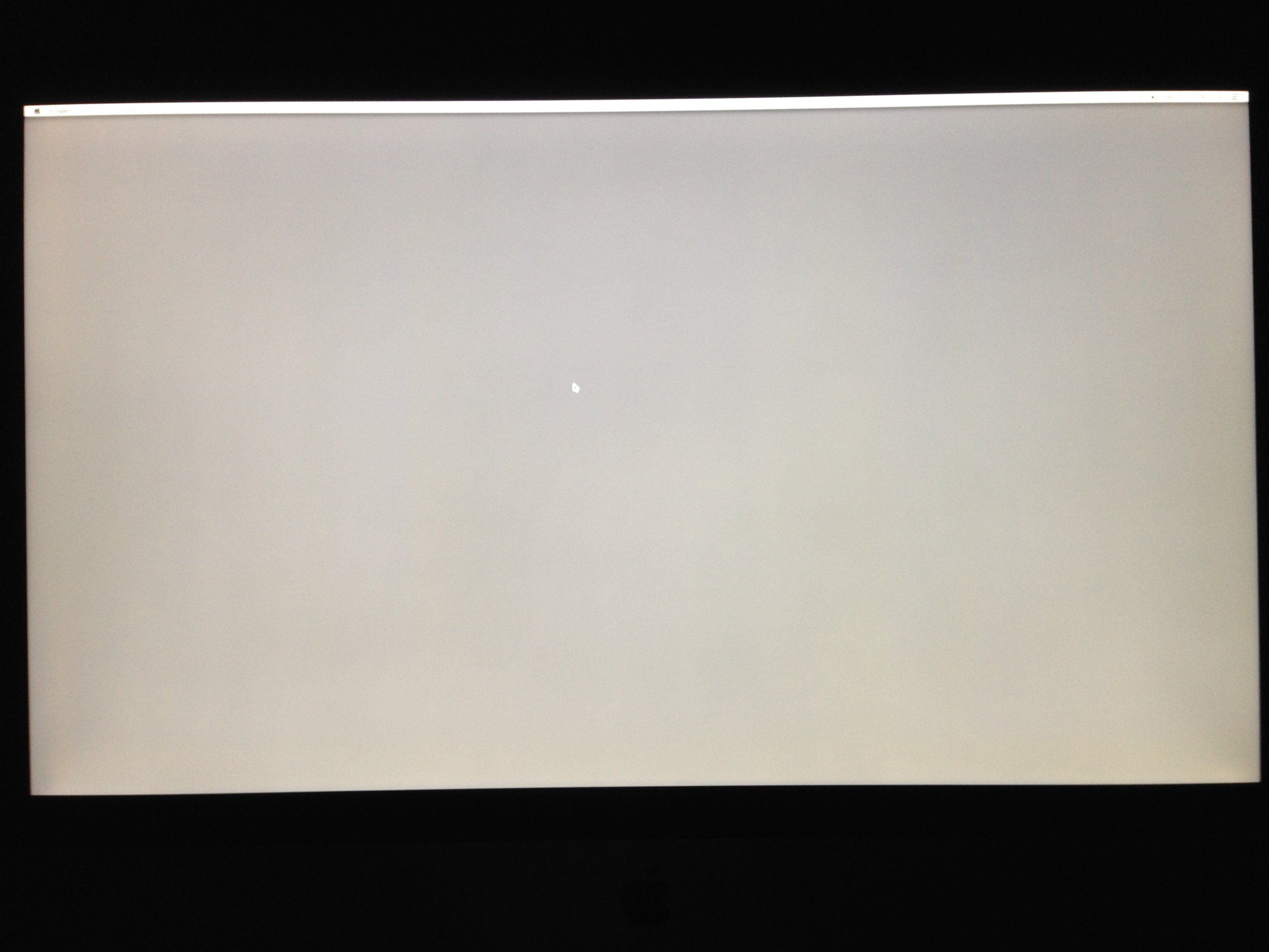

I ordered a 27 "iMac in December and I got a screen with a yellow tint, and I have seen immediately because I just next to a 27" late-2011. I sent it back and I got one that has exactly the same worries. So I corrected the problem with the calibration but I'm not happy: (

It just looked yellow overall? Unless it's measurably bad, your first concern should really be uniformity. It's not possible for them to guarantee that those two will match, especially given that the 2011 will not look the same as it did on day 1. I suspect the new screen treatment may affect color slightly, but it's a hunch more than anything. Here's a link on color temperature. Most of these things are designed around 6500K or a specific color target of D65. I suggest measuring it native when you run calibration. Give it an hour to warm up, then take the measurement with color temp and gamma either native or 2.2. If it's between 6500-7000K native, you are not likely to get much better. Yellow would typically be lower than that. I think part of the issue is that people on here are somewhat used to cold displays, although some of these seem to be genuine. Using eizo for the links because it's easy to navigate.
http://www.eizo.com/global/library/basics/color_temperature_on_an_LCD_monitor/index.html
A color temperature of 6500 K is standard for ordinary PC use and for the sRGB standard. Most LCD monitors offer a setting of 6500 K among their color temperature options. If a monitor offers an sRGB mode, setting it to this mode should present no problems. In most cases, even products whose color-temperature settings use terms like "blue" and "red" will be adjusted to close to 6500 K for standard mode, although accuracy may be lacking. The LCD monitors on some laptop PCs are set to higher color temperatures.
My iMac was assembled in Ireland.
Yeah it's not so much an issue of where it is assembled. this isn't a QC issue. It's an LCD displays vary issue. Apple could improve upon that somewhat, but that falls under design, not quality control. It would be interesting to know how yours measures. Keep in mind colorimeters are not 100% dead on, but most are decent. Also how uniform is it?
