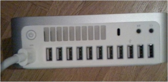

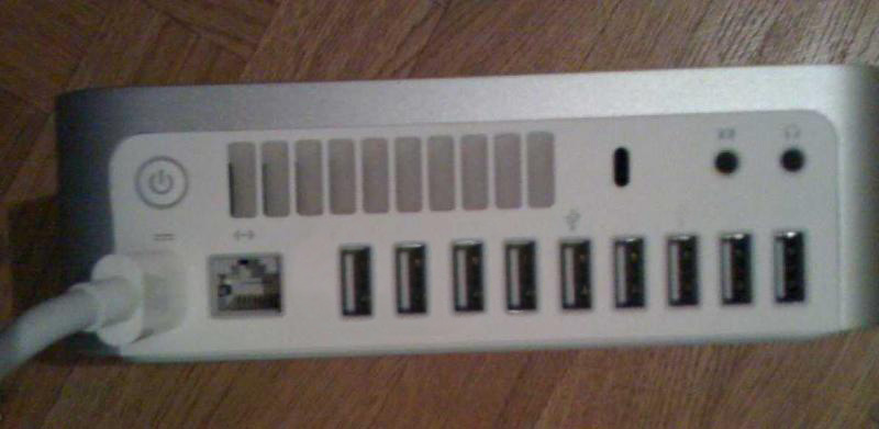

Firewire? DisplayPort? Who needs all that stuff? Here's a REAL photo of the new mini:
