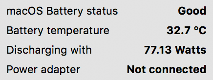

However I am pleased to report I recently took delivery of two UltraFine 5Ks, and will soon have a specced-out 15" MacBook Pro, too. That won't be here until Monday, however - despite Apple saying it will be here today 🙄 - but I do have in my hands a base model 15" Pro that I am borrowing from a friend.
Time to do some testing!
I figured it would be unwise to assume that the Thunderbolt 3 cable provided by LG is not the culprit. So my testing was done with both the LG cable, and a CalDigit 100W Thunderbolt 3 cable that I ordered specially for this test.
I had issues with GpuTest, so I used Cinebench instead. Combined with eight instances of the yes command ("eight?!" I hear you say... "hyperthreading" I reply!) the maximum power draw I could muster was an indicated 77W, as measured in coconutBattery.
It is important to emphasise that there is no universal measure of power consumption provided my macOS. Thus coconutBattery is estimating it, based upon the power draw of key components. It is reasonable to assume, then, that the actual total drain is higher. Nonetheless, this indicator is sufficient for making comparisons.
Test #1: UltraFine 5K + LG Thunderbolt 3 cable
The battery just managed to stay afloat with low single-digit charging rates of between 0.5W and 4W. MacOS sporadically reported "Battery Not Charging", though this was inconsistent. Clearly, the UltraFine 5K is capable of providing more than 62W - the amount cited by MKBHD - but it wasn't providing a full 85W.
Test #2: UltraFine 5K + CalDigit Thunderbolt 3 cable
The results were essentially identical to with the OEM cable. I thought at first it was providing more power, since macOS was not reporting "Battery Not Charging" like it sometimes was with the LG cable, however I think there are too many variables to draw a conclusion.
Test #3: No display; Apple USB-C power adapter + CalDigit Thunderbolt 3 cable
Now we see concerning results: the charging capability increased using the Apple charger - reaching more than 10W for some periods.
