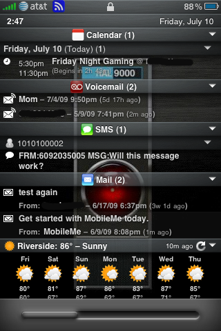

Here is an example of config.js settings...
Alright guys. Here is an example of what I did to my config.js file to make it look like the examples that you see above.
The path for the file is as follows:
/Library/Themes/Grupple LockInfo.theme/Bundles/com.ashman.LockInfo/config.js
You must do the following to edit this file.
1. SSH the above file from your iphone to your desktop. (I use Cyberduck with Mac).
2. Then you will open the config.js file and edit it with a text editor.
3. Once done editing, upload it to the same location and have it replace the old config.js file.
4. Done.
5. Also, to make the stock lockscreen clock disapear so the one with this theme shows, download "Lockscreen Clock Hide" from the david.ashman.com source.
Bellow is a copy of the config.js file with the changes I made and comments in red.

I hope this helps out guys.🙂

The order in which the items appear in that list are the order they will appear on the lock screen. I changed mine around a bit (still a work in progress):
Also, if you want to dig more into the look and feel of the display, in the Theme under the com.ashman.lockinfo/css directory are cascading style sheets you can edit, if you want to do things like change up colors, fonts, text locations, etc.
My next plan is to rework the fonts (maybe a bit smaller), tweak the rest of the icons, and tweak the way info is presented (like removing the second line in the calendar entry containing the end time and begins in info)...

well heres mine
