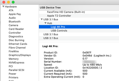

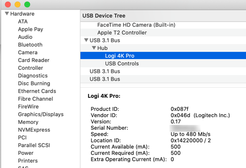

I can confirm the camera is on a USB 3.1 bus. I tested directly attaching to MBP, as well as via my LG 4K monitor (screen shot attached).
Re: the Logitech Capture software.. I cannot get that to recognize the camera as a source? I did give the program access to the camera in System Preferences.
I also cannot get it to recognize the camera on my MacBook pro or the screen. I tried downloading the beta version of the Mac OS software but for some reason the website or FTP site is not operational so I can't even get that... It seems like in Safari on the webcam settings site it is able to detect the 4K, but not in any other browser

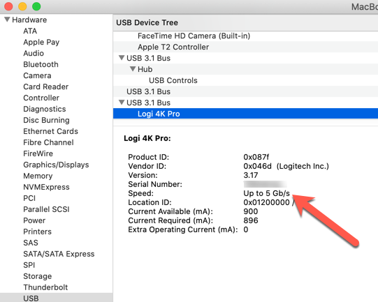

Oops! I just realize that although connecting the camera to my monitor (even with the proper USB-C cable), only supports USB 2.0 speeds (screenshot above). D'oh!
Here is the camera directly attached to my MacBook Pro:
