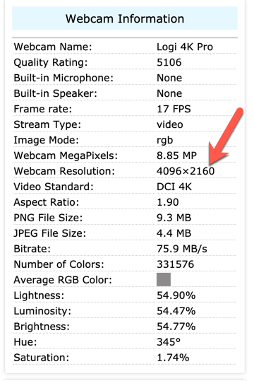

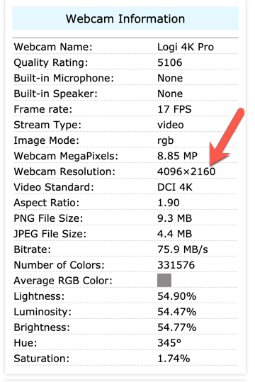

However, we have success!!
Here's how you can verify your Logitech 4K Pro Magnetic Webcam for Pro Display XDR works in 4K on regular ol' Macs:
  1. Connect the camera directly to your Mac
  2. Ensure you're using a cable that supports at least USB 3.1 Gen 1 (so you get 5Gb/s transfer speed)
  3. Ensure you're running Chrome build version 84 or later
  4. Go to webcam tests.com and you should see your camera available to test
  5. Run the test, this does take several minutes.

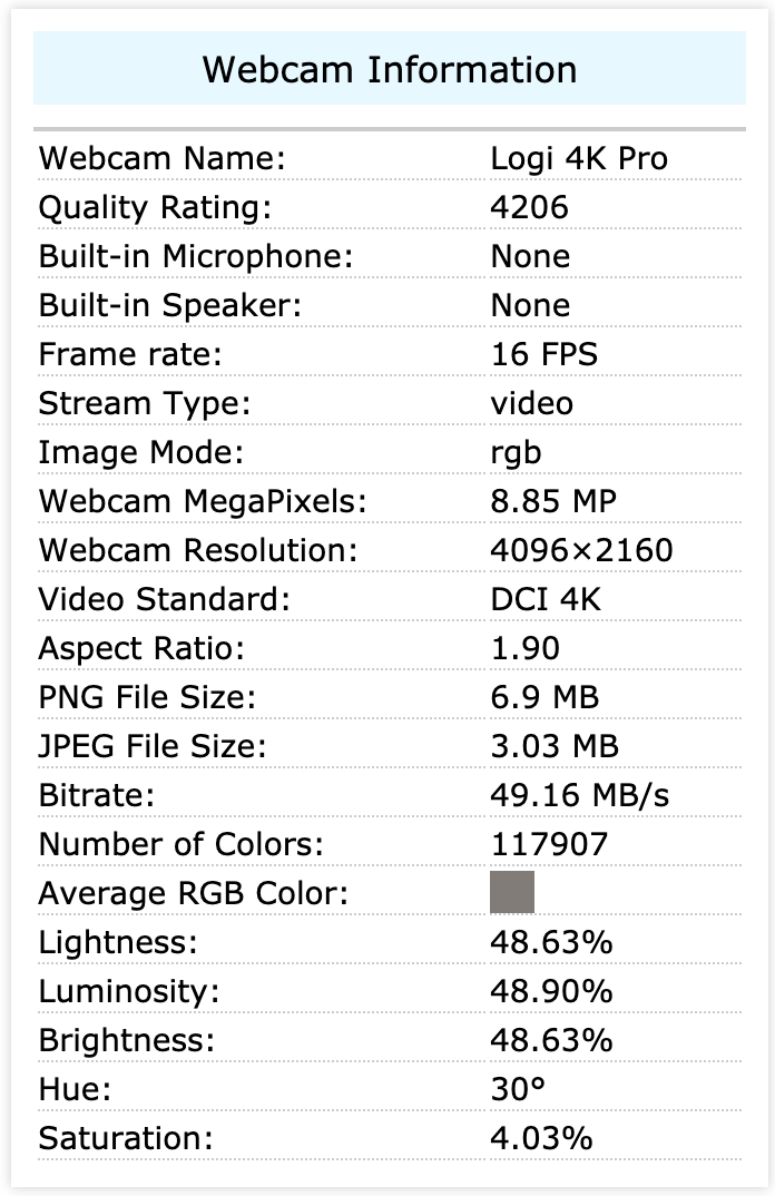

This is the webcam connected to a 2016 MacBook via USB 3.0. Apparently, that's enough for 4K!
This test was carried out in Chrome. In Safari, the test shows 4K but with 0 fps...

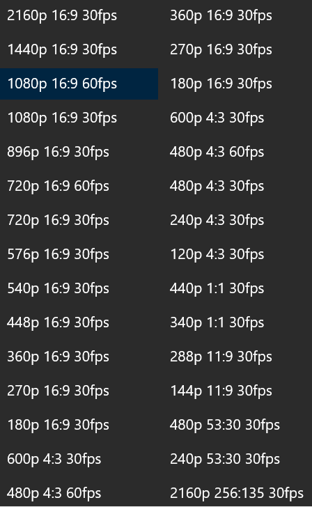

The webcam can indeed do 4K at 30 fps or 1080p at 60 fps on the Mac Pro 5,1 via USB 3.1. These are the video modes seen by the Camera app in Windows 10:
I guess it comes down to the software in macOS not offering the option...
