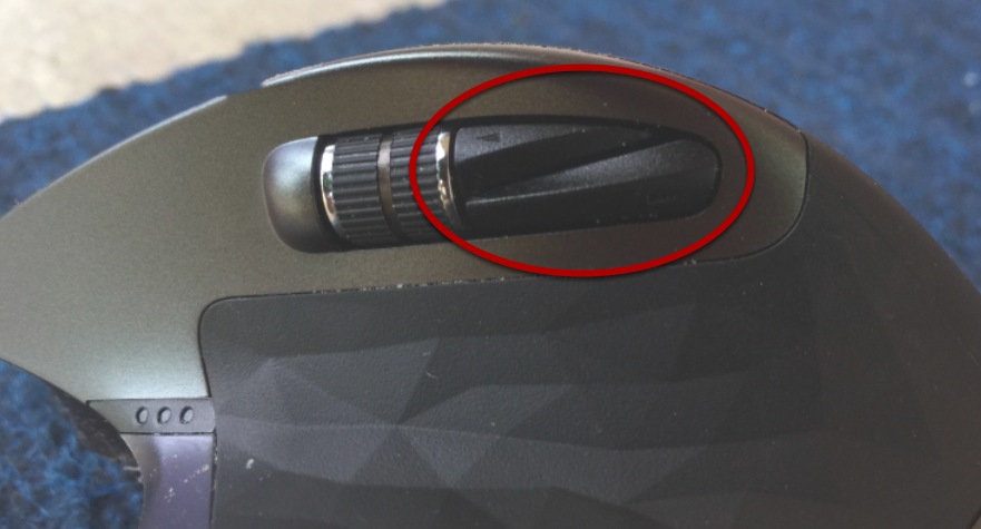

Biggest drawback is the design of the click/free spin scroll wheel on top of the mouse. This video illustrates the problem and how to fix it. Has happened once to me. Was able to repair it with no issues since then. However, it's a PITA to fix.

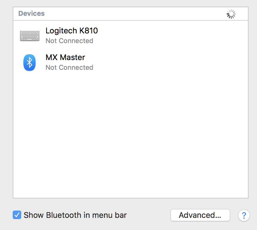

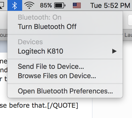

Connection to my MX Master never drops when i use it, but I have noticed that when I switch connection to my PC (I use it simultaneously on PC and MB 13 2016), and later switch back I have to open Bluetooth Preferences and it immediately connects.
I can see my K810 keyboard in the bluetooth drop down menu all the time, but as you can see there is no MX Master, until I open the preferences.

Also, in preferences there is a keyboard icon for K810, but MX Master has generic bluetooth icon. Is it same for everyone?
