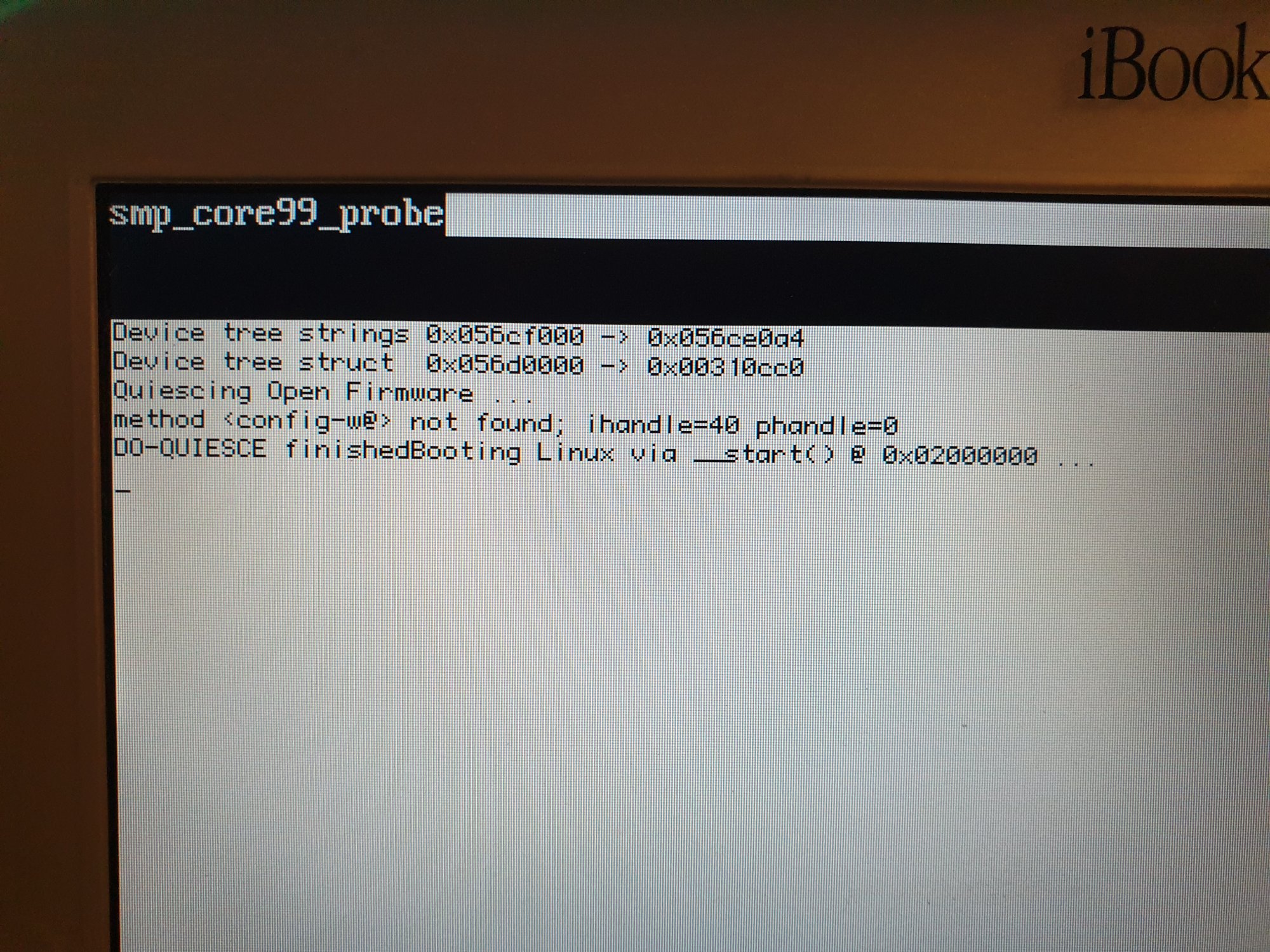

Tried 16.04 server and it just got stuck at Quiescing Open Firmware.... Also tried the 12.04 remix and that got stuck at Calling Quiesce...
@ProCat : Hmm. I only have a couple g4/g5 machines. Maybe someone with a g3 could chime in. My only other suggestion is try the Void live CD and see if that boots, or gets the same freeze. Maybe it'll shed light on the issue.

Actually just got done testing void. It gets slightly further but not much:

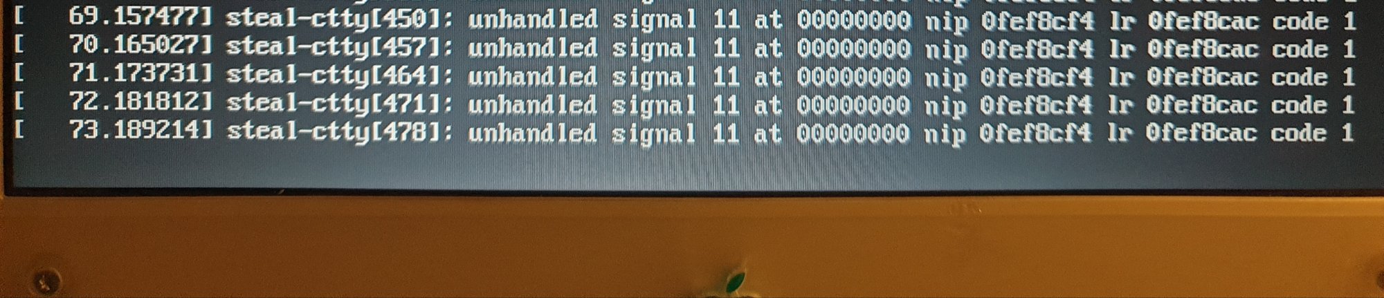

EDIT: Also tried the Debian Sid Remix, the issue with that is different. It just keeps repeating this unhandled signal 11 error forever:

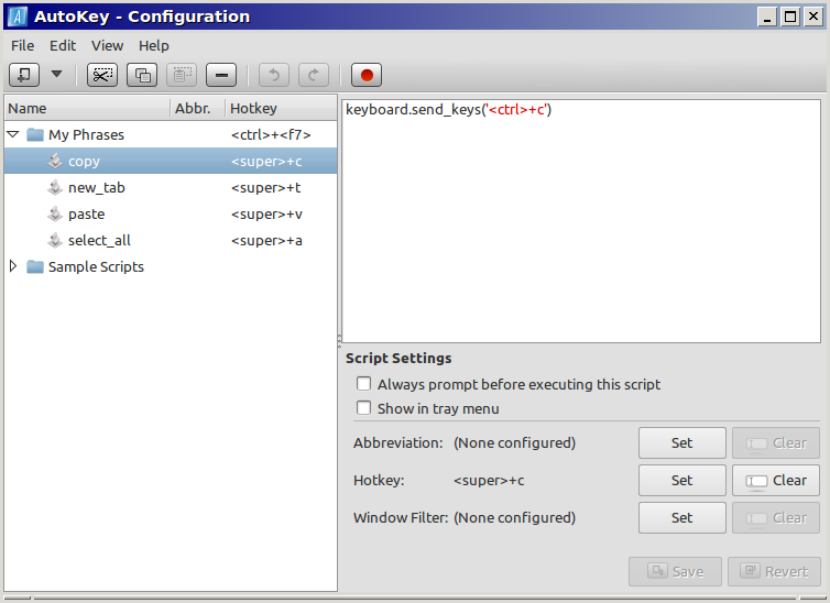

2) To set up Mac keyboard shortcuts, I ended up using autokey. This doesn't completely swap the Ctrl and Super keys, but rather just lets me set up custom shortcuts that send a different key combination when I enter the shortcut. For example, when I press Super+c, it sends Ctrl+c. This mostly covers it - the only place that its annoying is I need to remember not to use it in the terminal. 😉
  • sudo apt-get install gtk-autokey
  • create a file: ~/.config/lxsession/Lubuntu/autostart
  • Add a single line to that file with text "autokey"
  • Reboot
  • The Autokey (blue "A") should appear in the taskbar near the clock.
  • Open Autokey and set up desired rules (example in attached screenshot).

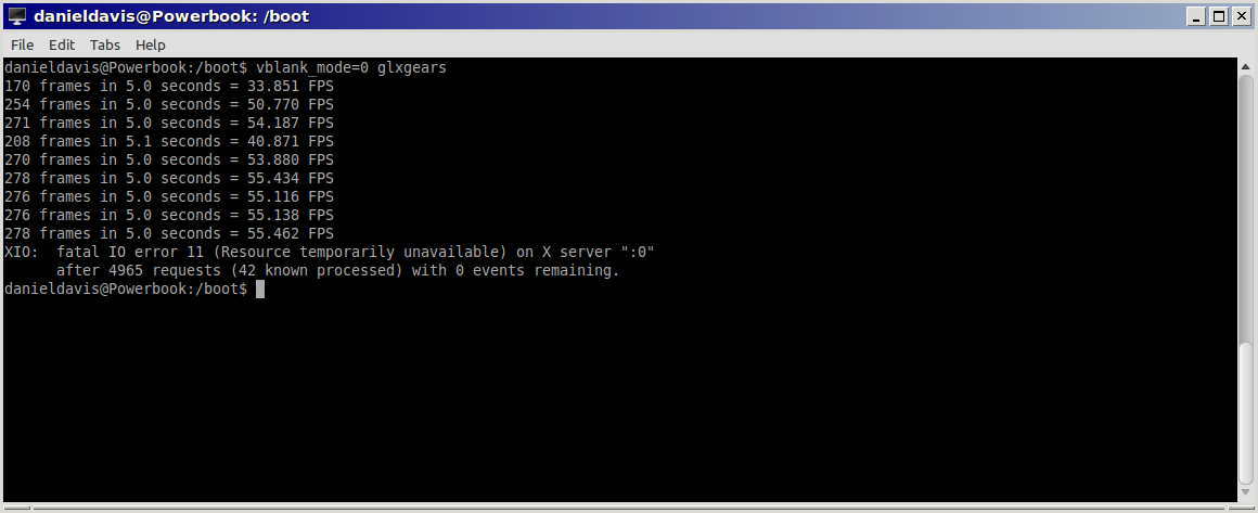

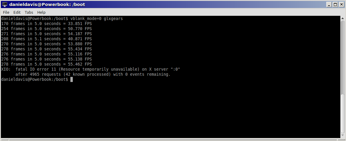

3) Thanks for confirming that. 🙂 The tearing isn't that bad, just didn't expect to see any if acceleration was working. Can't remember exactly where now, but I think I remember seeing you post a glxgears output that was much higher from either Void or Fienix in another thread. What makes the difference there? (or am I just misremembering?)
EDIT: Found the post: https://forums.macrumors.com/threads/void-linux-for-powerpc.2129245/post-28474614
I added a screenshot of running glxgears the same way on Macbuntu. Should I be expecting comparable values to what you got in Void? Also, I notice that the CPU pegs at 100% (with frequency scaled to max) with that running. I wouldn't expect that to happen if it was drawing with the GPU, but maybe my expectation is wrong?

Glad you like it. Thanks for the touchpad and auto-key info. I'll add it to the readme.txt when i get around to another release. As for glxgears, your output looks good. You can also try "vblank_mode=0 glxgears" which should report roughly 400fps-800fps (as it bypasses the vsync of your monitor which is typically 55-70hz). Your cpu is spiking because you are using the default framebuffer driver. Basically you are using software to render 2d/3d graphics, hence the spike. This is normal and nothing to be alarmed about. Enabling "true" 3d will cure that, but at some weird costs. Colors can become reversed, your computer can lock up tight, etc. Sticking with the radeonfb driver is the safe and stable choice.
Cheers
That was what I expected, based on your post in the Void thread, but if you look at my screenshot above, that's what I did, and was still only getting ~55fps.
Thanks for explaining that. 🙂
