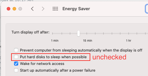

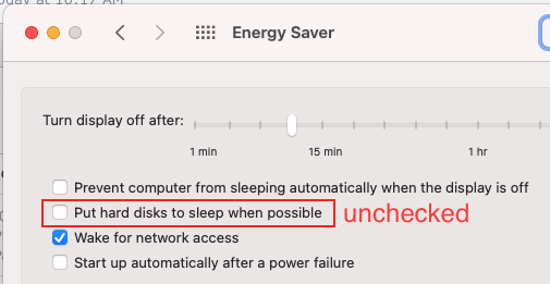

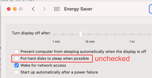

Okay quick update on the wake from sleep issue--I went into settings last night and unchecked "Put hard disks to sleep when possible". I left my computer on so that it would go to sleep over night and when I woke up this morning, the monitor woke up along with my M1 Mac mini when I pressed on my keyboard.
Can someone else test this and see if it solved your problem? I'll continue to monitor this situation as well in case the problem comes back again.
Edit 1: I've had my computer fall asleep due to inactivity 3 times so far today and it has woken up my monitor successfully each time. Unless the problem returns again, this seems to be the solution to my sleep-wake issue.
Very interesting. On my non SSD Macs I usually check the “Put hard disks to sleep when possible” as I’m thinking it will save wear and tear on the HD. But with an SSD HD M1 does this matter?
An SSD does not have moving parts to put to sleep, so my understanding is that there is no benefit to having this feature turned on.
Even a HDD would be better off without being put to sleep often because it's stressful for it to constantly park and unpark the heads and spinning up.
