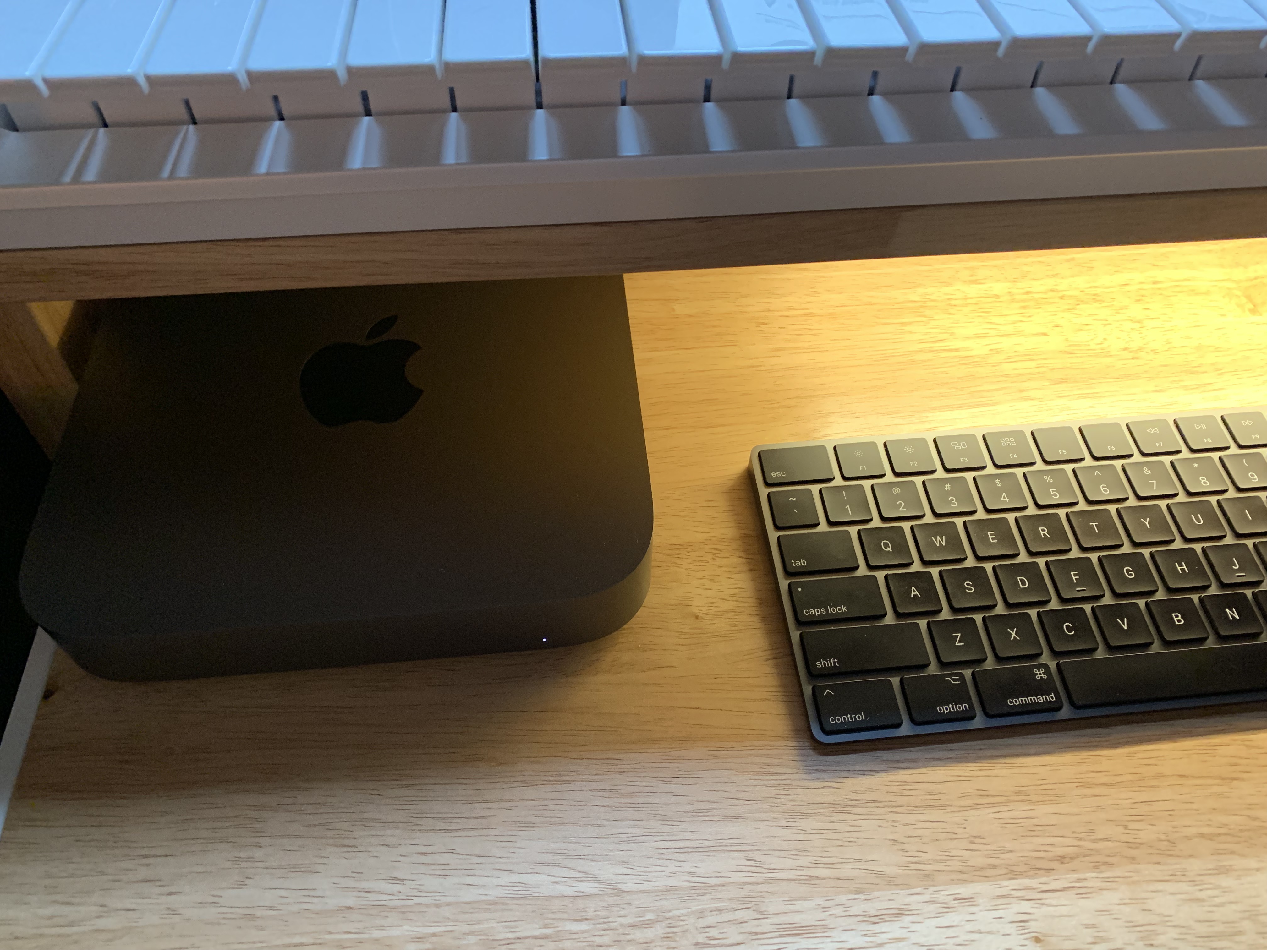

Just had my Magic Keyboard become unresponsive sitting literally 2 inches away from my Mm. This is REALLY starting to piss me off. I couldn't get it to come become active again until I turned the power off on the keyboard and then back on. Are you listening Apple!?
I run my keyboard wired to the USB port. (given how close you have it, i suggest you do too)
I did however experience the unresponsive dropout from my mouse and trackpad - it seems like a glitch. it sorts itself out in about 15 seconds, no need to force shut it off.
it's terrible tho. started happening with 10.14.3.
