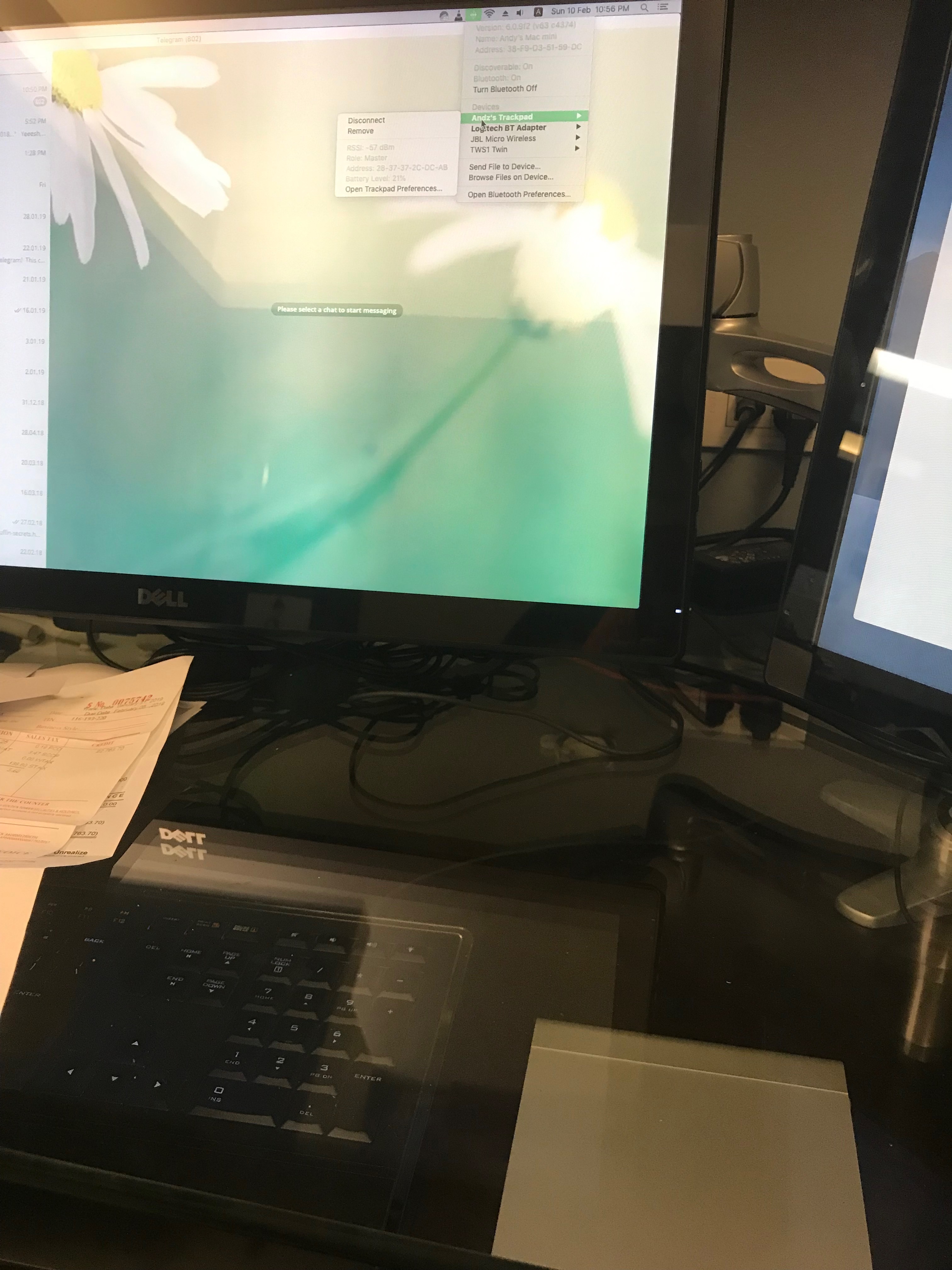

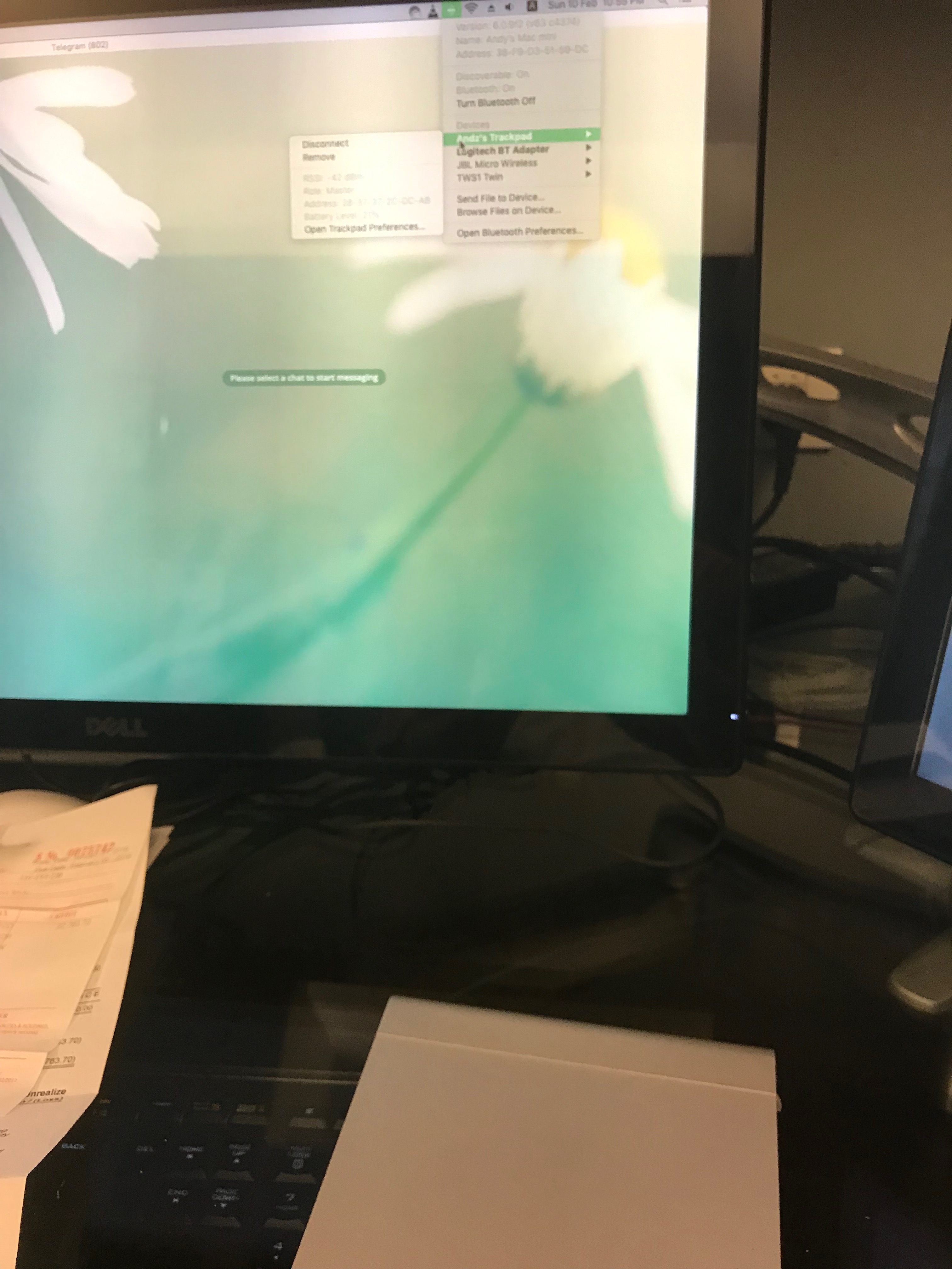

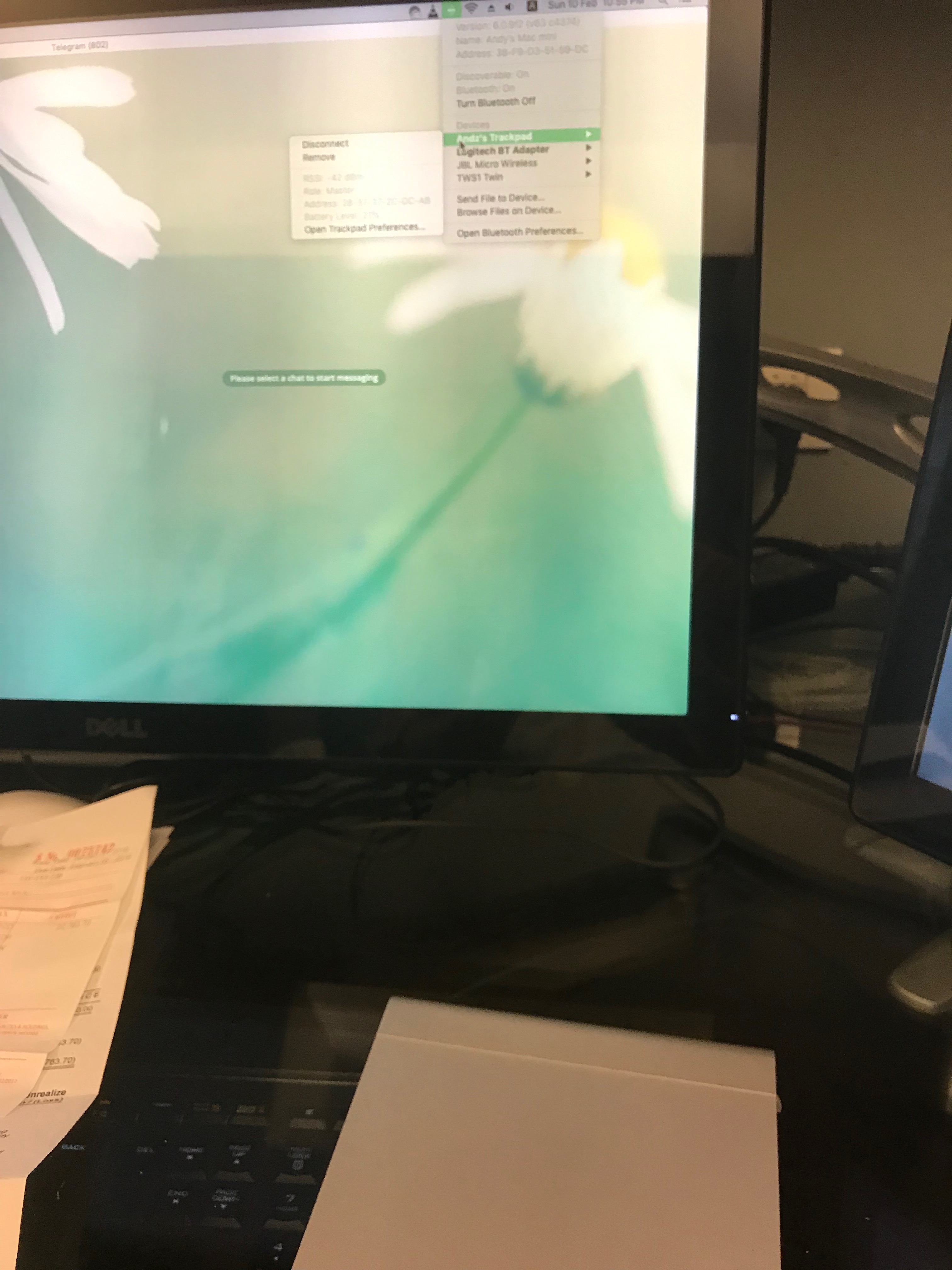

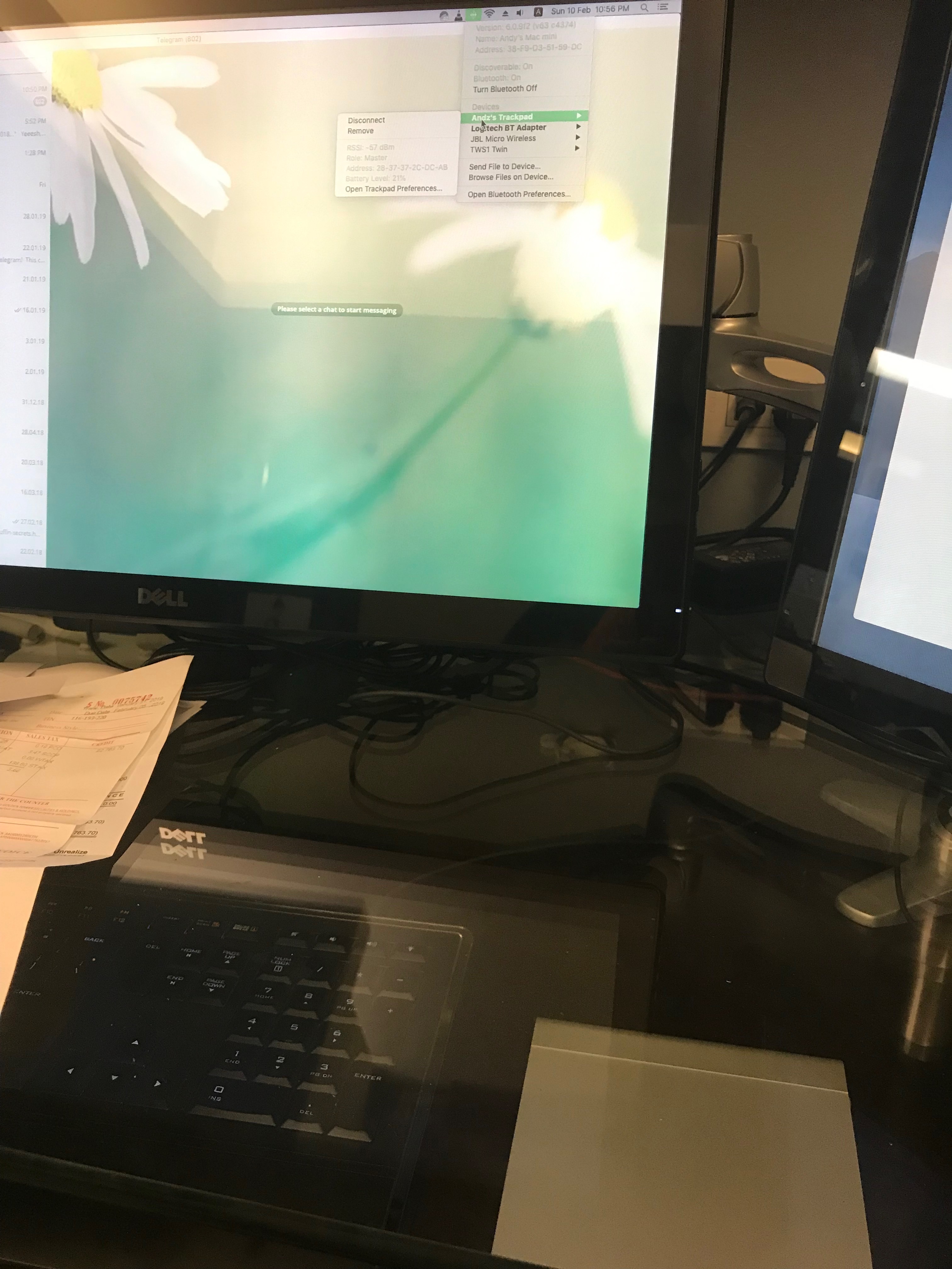

Both my 1st gen Magic Trackpad and Logitech MX Ergo Wireless Trackball were exhibiting jerkiness/tracking issues while using them with my Mac Mini 2018. Something like 40% of the time, they would stop tracking movements smoothly and experience lag/jumpiness.
This pissed me off to no end. Then I discovered a clumsy workaround which is to have a wired mouse plugged in to the Mini and when the lagginess issue occurs, I just move it a bit, and then the tracking becomes smooth again, for a while... before it returns again.
Then just today, I had the idea to move my Trackpad to the same level of my table(*) as the Mac mini.
(*) I have a custom built two level table with a glass layer at the top where the Mac Mini sits while the (wired) keyboard and Trackpad are on the wooden layer around 4 inches below the glass layer (see pics).
Voila, the issue disappeared! Using the Bluetooth Explorer diagnostic app, it showed that the mere 4 inches differences in elevation, coupled with, I suppose the glass layer, resulted in a difference of over -10dBm in Raw RSSI while Link Quality went from 80-100% down to as low as 30+%.
As you can see from the pics (left - Trackpad above the glass, right - Trackpad underneath the glass) the difference in distance should essentially be negligible. I can't believe the glass layer seems to be effectively blocking the Bluetooth signals?
This problem never arises when using my Asus ROG-GR8 Windows machine (which used to sit in the exact same area where the Mac Mini is right now) with the trackball/trackpad device in the same area underneath the glass. So the Mac Mini BT module seems to be the culprit.
Anybody know of anyway to perhaps adjust the BT signal strength of the Mac Mini?
