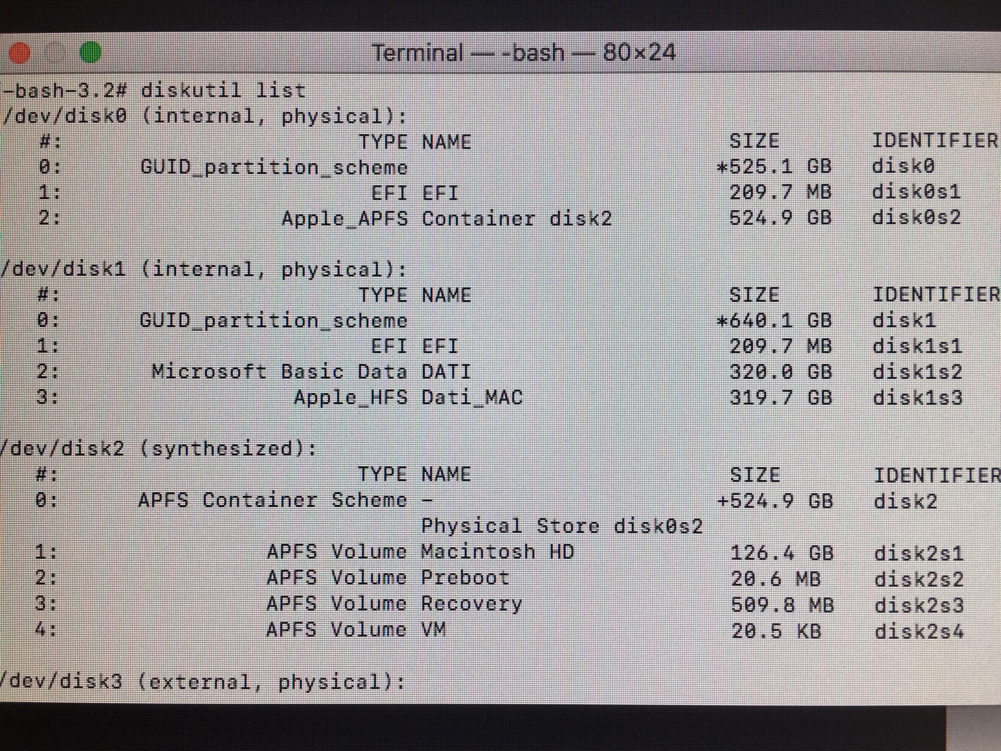

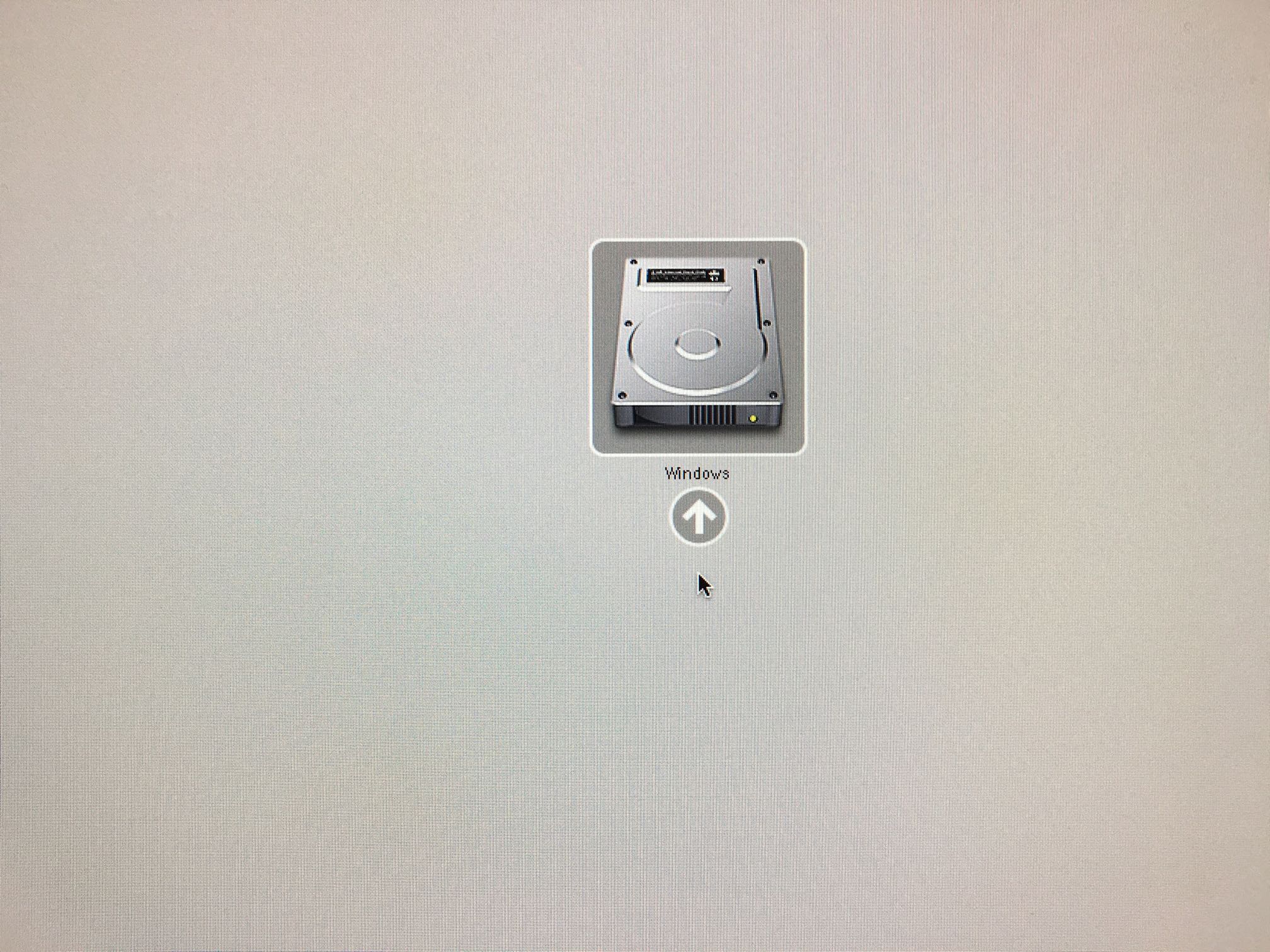

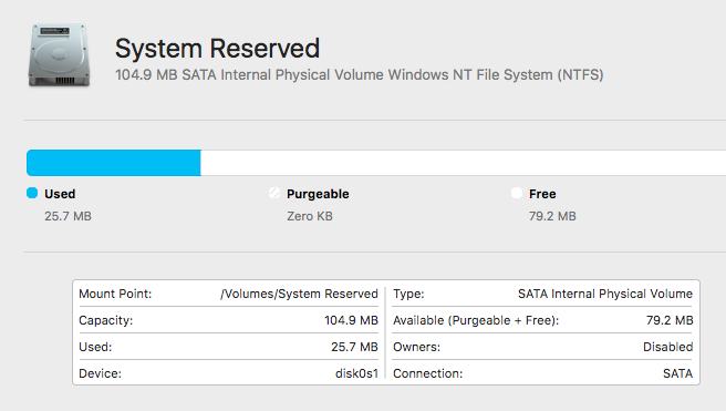

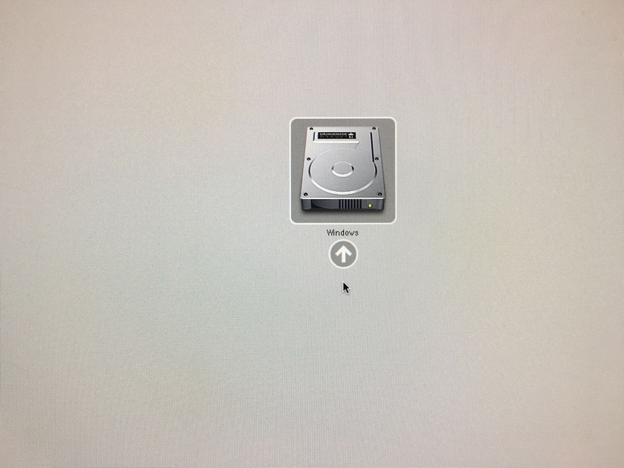

Let me forget about windows for a moment. I’ve cleaned my bootcamp install with bca on high sierra, and this is what I have if I press “Option” during boot.
Disturbing!:eek:
Maybe I’ve previously messed up something and Windows boot manager stucked somewhere (maybe in the vm or preboot partitions?).
I left some screen.
How can I solve this other than blank it all?:D

whats 'bca', boot camp assistant?
can you boot in to the recovery partition? that may be the simplest way to see whats happend.
in the screen shot the only partition is called windows, can you boot in to it ?
was windows on disc 2 and osx on disc 3?
Nope. But I found where the “extra” Windows bootloader was (mechanical drive)
Was windows on disc 2 and osx on disc 3?
Bootcamp and apfs container with high sierra were on the same drive (ssd, boot)
