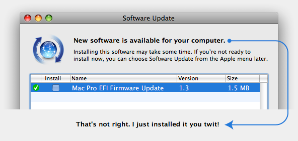

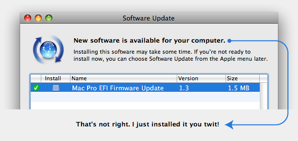

Visual note to Apple:
See that little green check mark that is to show that it has been installed.
