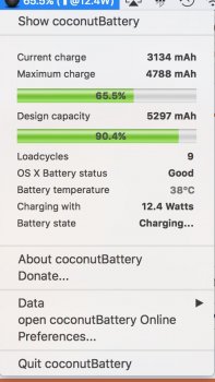

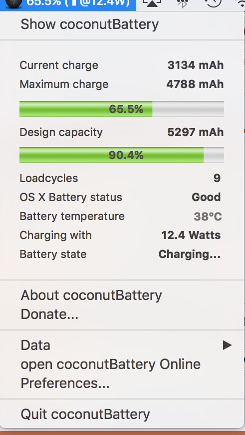

My Macbook 12" is only 2 weeks old, cycle count is 8 however the Design Capacity is degraded to 90% right now...with a Maximum Charge of 4767mAh!
Is this a faulty product out of a box?
Need to seek what are my opinion to escalate this to Apple?
Call Apple Support over the phone. Let them know the issues you have been facing with your battery. If they determine that there is a something wrong with your macbook, they will give you a case number. Then bring it to the service centre for servicing.
My launch unit was replaced a little over two weeks ago by Apple. They diagnosed an issue with a voltage chip on the logic board, and determined that having 89% design capacity on your battery after only 8 load cycles was probably not something that a user should have to deal with.
At first the Genius was going to replace the whole bottom tray (which includes the battery) as well as the logic board, but after I signed to authorize the repair, the system told him to replace the entire machine with a new one. They ordered me a new 1.2/512 on the spot, and I picked it up about a week later. this one is doing a bit better (98.7% after 5 Loadcycles) but that number has been going up and down each cycle. It started at 100.7% and has been down to 97.8% as well.

So just figured out that all these coconut battery tests along with the system are lying generally. For me, my computer said i had 89% but I went to Apple Diagnositics and I had 99.87% capacity. I will not rely on these anymore

Seems like this voltage issue is spreading, but it isn't. These genius bar employees don't know how to properly test the computer. YOU NEED TO HAVE THE COMPUTER PLUGGED IN when running diagnostics. Even their damn iPads state in a yellow box to redo the test with the charger plugged in. I have gone through five computers with each computer being the voltage issue. They finally found out that the computer needs power when the test is running. Also, coconut battery is a very rough estimate. 90% for me turned out to be 99% on their diagnostics. If you have time, go check it, but I bet you nothing is wrong with your computer. Yosemite just does not have good software to measure the new capacity for the batteries. Sometimes, with my computer charged for a day, my battery capacity is 102% while my battery is somehow charged only 90% of the way to its design capacity.

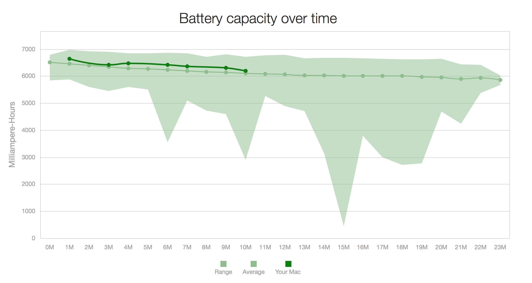

It may be no more than the SW calibration of the battery is "out" however the values can go down. I would also try to charge it in a relatively cool environment. My own 1.2 rMB is holding up fairly well, equally the average trend is clear (attached)
If your rMB does drop battery capacity significantly again, I would contact Apple directly and see what they say.

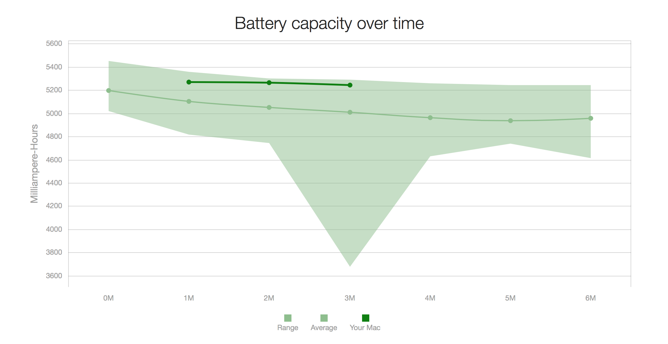

If you look at the trend for the 13" rMBP it`s not dissimilar to the rMB over the first six months, if anything the range of the 13" indicates more systems with significant drops in battery capacity (green silhouette) over time (23 months).
Screen Shot 2015-08-19 at 18.37.33.pngScreen Shot 2015-08-20 at 14.07.12.png
If your MacBook has an issue with it`s battery, the problem will surface rapidly, and you will likely be in the minority, as can be seen from the charts.
