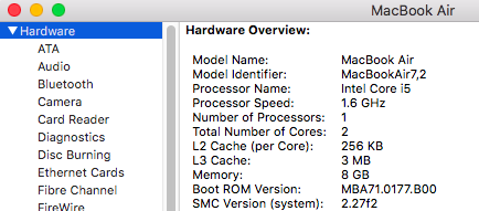

Is the air running a .176 (from 10.13.4) or .177 (from 10.13.5) bootrom?

Be sure to update to 10.13.5 before installing the Samsung as 10.13.5 contains a bootrom update.
About This Mac, system report.
