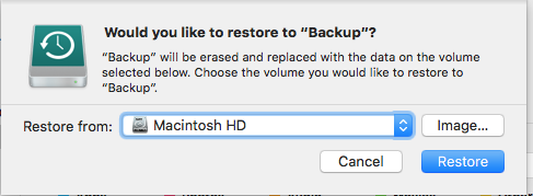

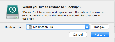

What you can try to do is when you get to that recovery screen from Internet recovery, start Disk Utility then if the Macintosh HD volume is still there you may be able to copy it to an external drive using the restore menu choice under the Edit menu. So select the external drive you want to copy it to then select restore in the menu, then select Macintosh HD as where you are restoring from. It should look like this if your external drive is called Backup like in my example. Then click restore and that should copy Macintosh HD to the external drive where you can try and recover data after you install the OS.
