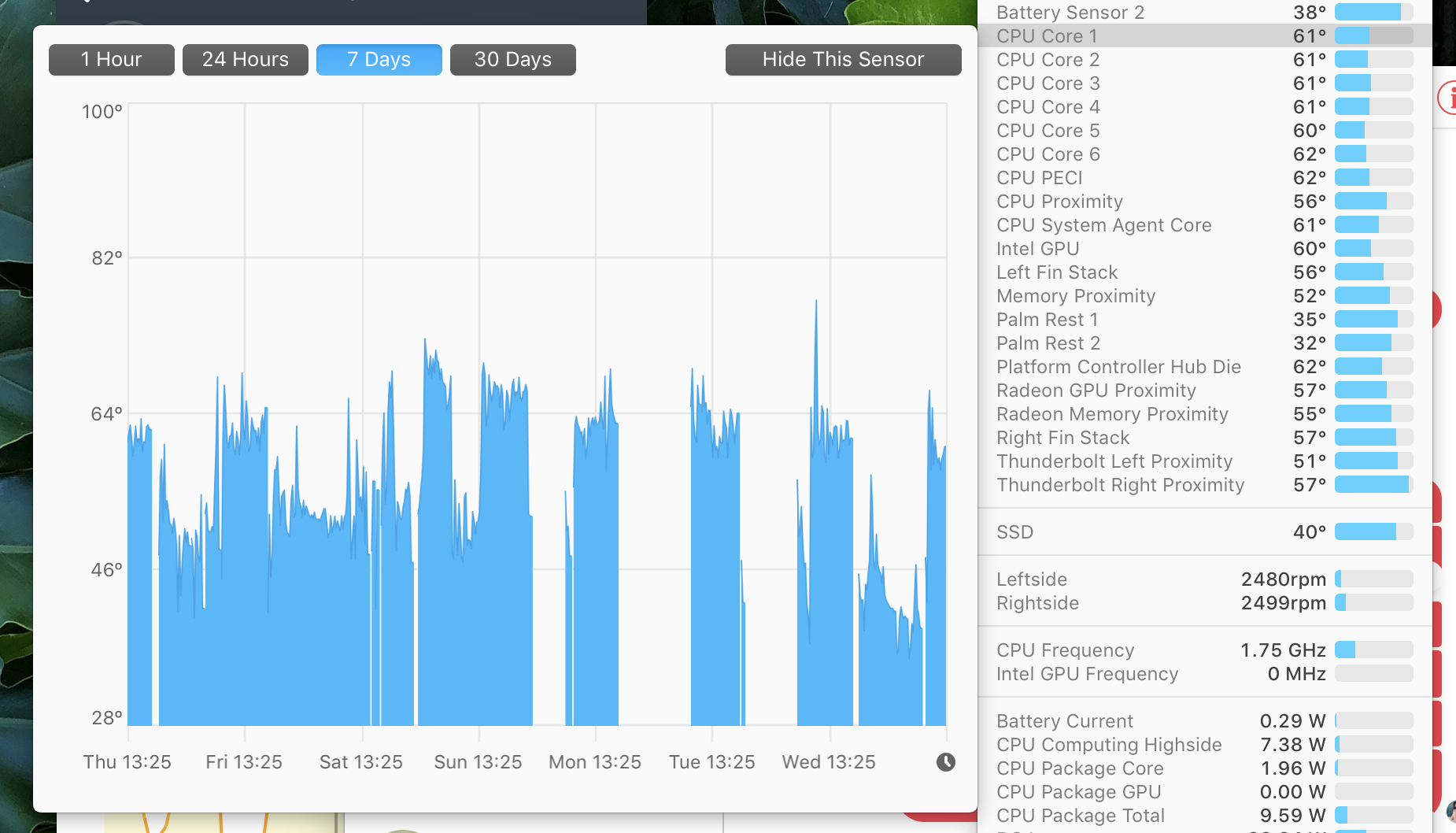

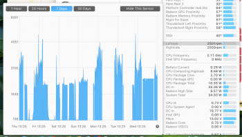

Thank you for your answer. I am sure the fans are running to cool down the CPU/GPU, but my question was that this amount of noise and this sensitive fan spin up is normal or not?
I wrote, that I have all the updates (including the supplemental update, 17G2208) installed. I am using iStat Menus to monitor the temperatures and the fan speeds:

Can you share your fan speed statistics with me? (iStat Menus → Fans and sensors menu → Leftside → 7 days)

Show please an image of your fan speed history (as you can see mine above)!
