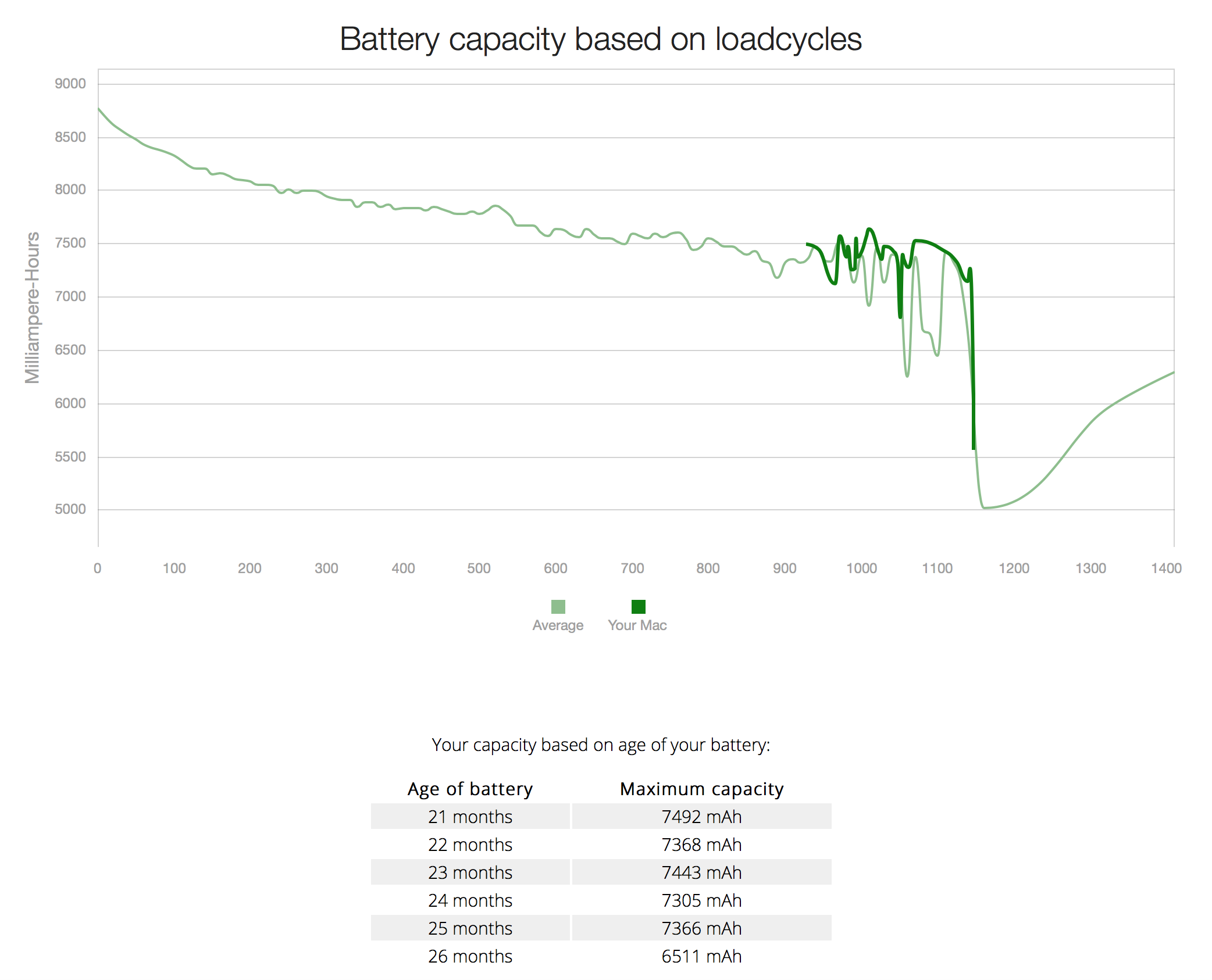

Update: Things after 800 days.
First off, just today I noticed an extremely steep drop in battery life. At first I thought something taxing was running in the background, but coconutBattery clearly indicated the problem. The images say it all.
Overall Battery Life: About 3 hours 30 mins at around 1147 load cycles. The battery status seems alright so lets see how far this goes. It is whopping drop from around 86% to 65.8% in a day. In fact, it fell about 7% over the last few hours! It is worth noting that the coconutbattery online graph average shows an interesting variation after about 1200 cycles, when the battery capacity rises. Will report on this as well, unless the battery fails.

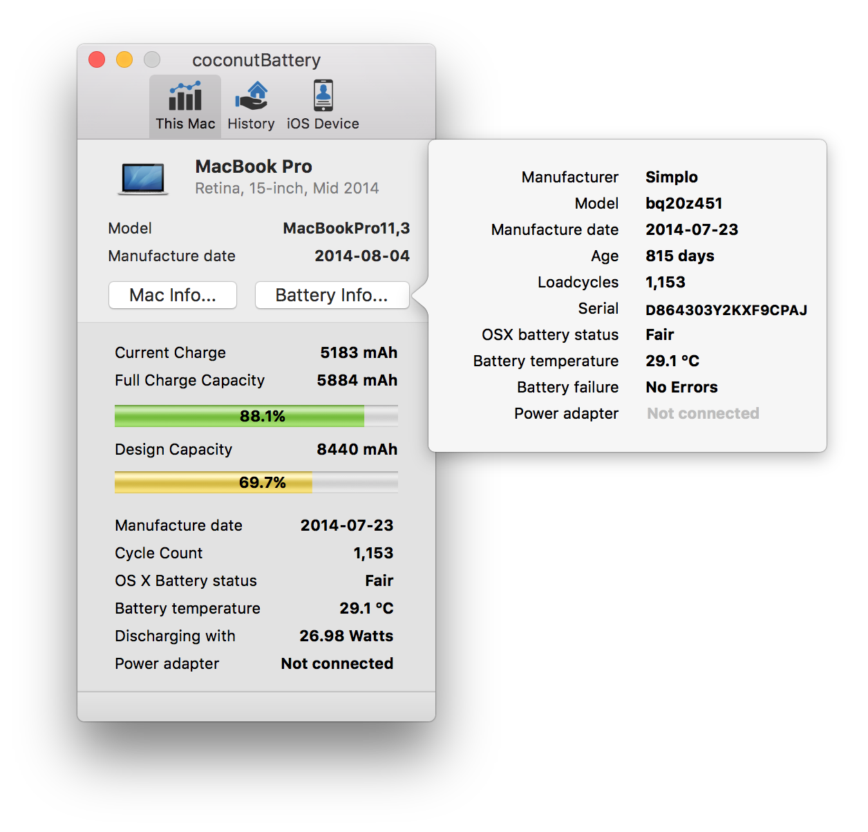

Thanks for sharing. One thing I find surprising: I thought once the battery is below 80% capacity, the system will tell you 'service battery'. In your case it is still marked as 'good'. One thing I would be worried about however when it gets to such a low capacity is battery swelling which could potentially do damage to your Macbook. But please keep the updates coming.
Regarding the stats from Coconut Battery: I wouldn't read too much into that graph, I wonder how big the population past the 1100 cycles still is, might be just one Macbook ...
Woke up to find the capacity up by about 5%. In any case, I also wondered how many people were around the 1100 cycle mark given the relatively small timeframe the laptop has been available. But even so, my notebook seems to replicate that behavior quite closely. It will be interesting to see what happens.
And after 815 days the battery status has been updated to Replace Soon. To summarize, this status means that "the battery is functioning normally but holds less charge than it did when it was new." It is likely that the status will change to Replace Now pretty soon, which means - "The battery is functioning normally but holds significantly less charge than it did when it was new. You can continue to use the battery until you replace it without harming your computer."
I might continue using this battery until its very last days since I don't care much for long battery life (plug point usually nearby). Will keep this thread updated.

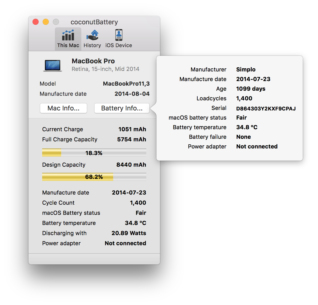

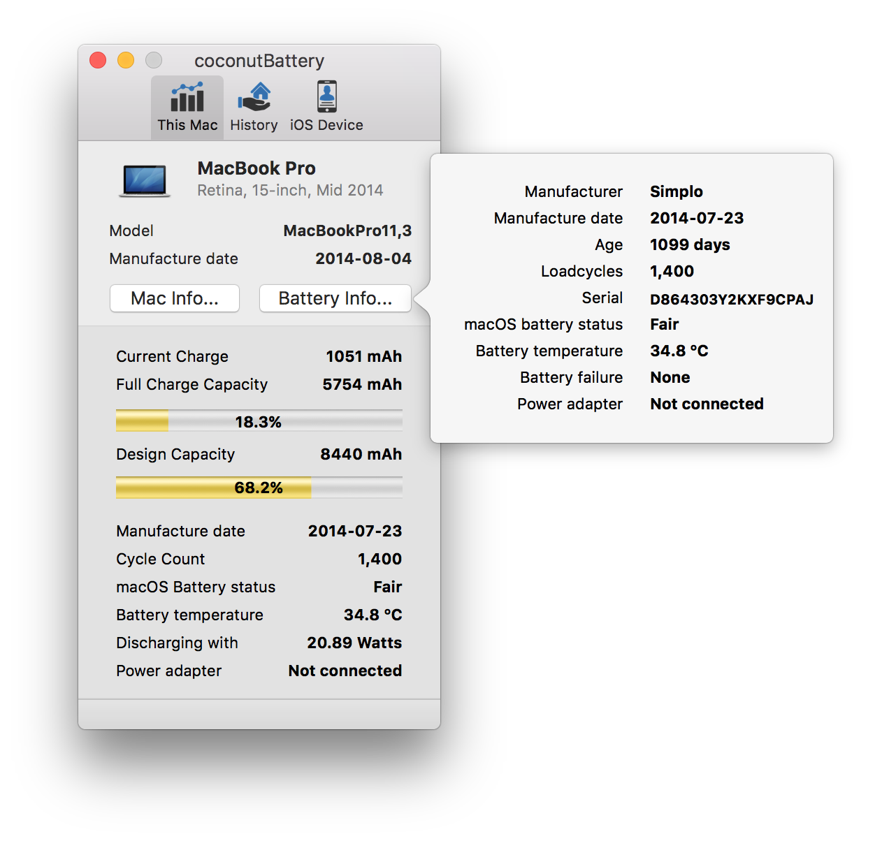

1400 Cycles Later:

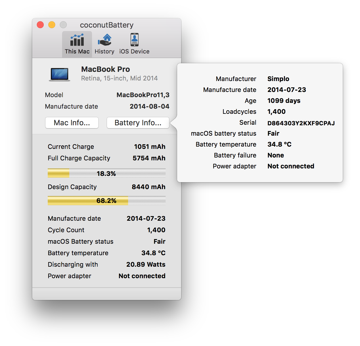

The battery status has not changed, and my experience is not much different either. Things look alright for the moment. I get about 3h 40m of battery life.
It might be worth considering a battery replacement... even out-of-pocket at $200, it would likely give you much better battery life.
Plus you'll get a new top case - which includes keyboard, trackpad and palmrest obviously.
