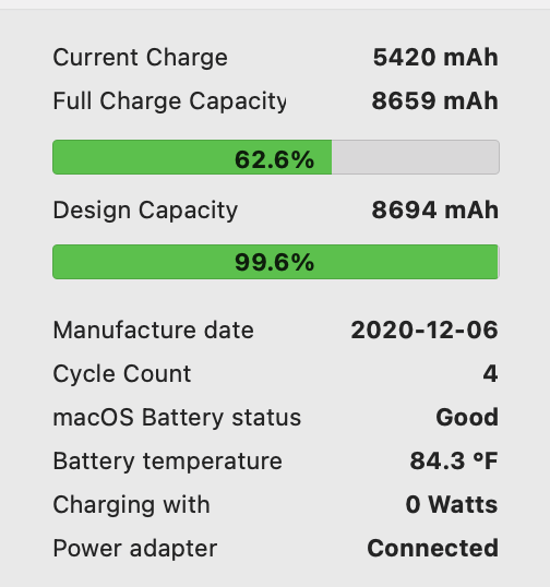

I have AlDente set to 65% charge, and it won't start to charge until it gets to 60%, preventing a lot of "on-off-on-off". My MacBook Pro is a year old, I use it pretty consistently every day for probably 12 hours a day, 95% of the time it's plugged in. Here is what coconut app reports right now (charged to 63%):
