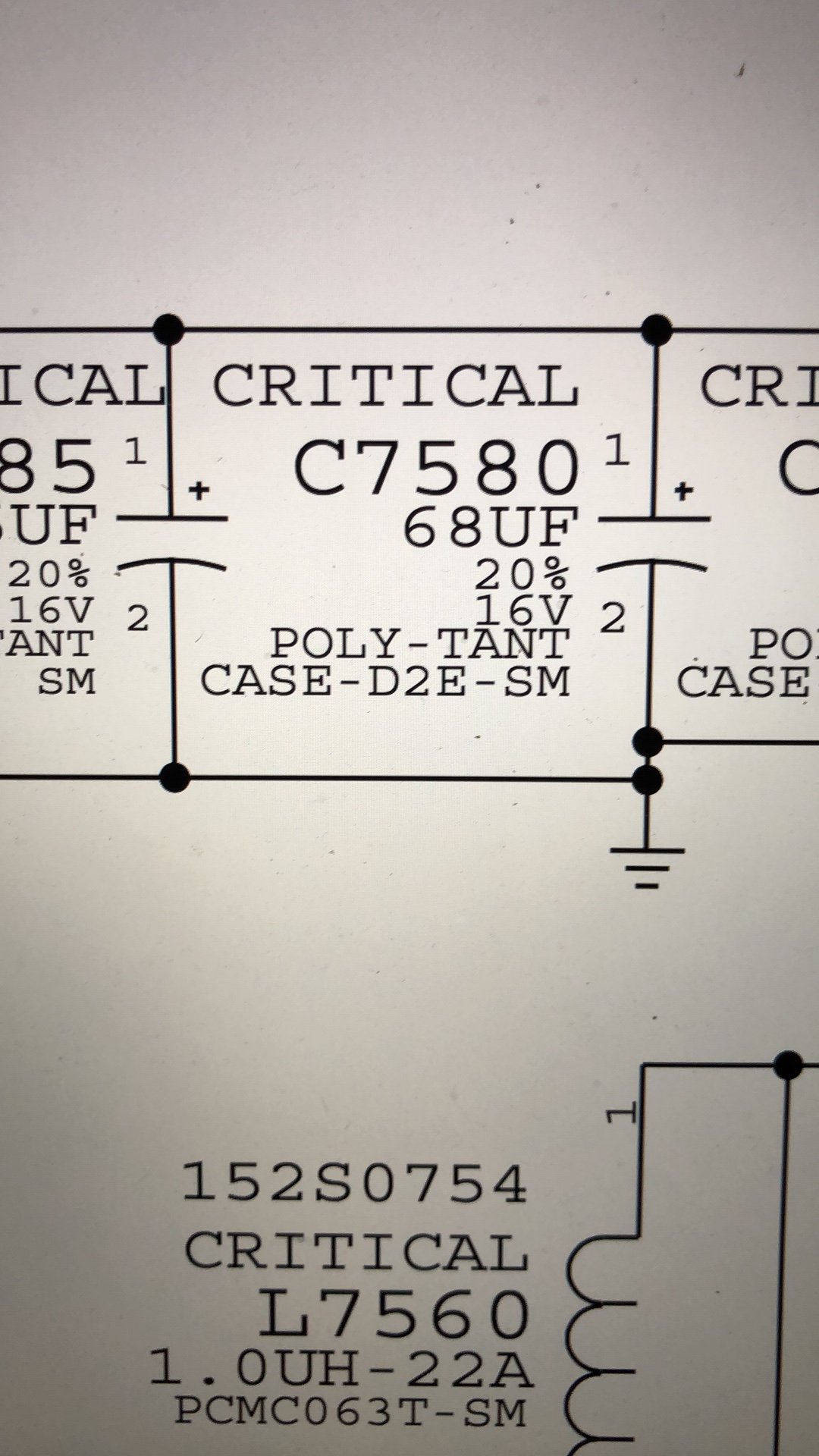

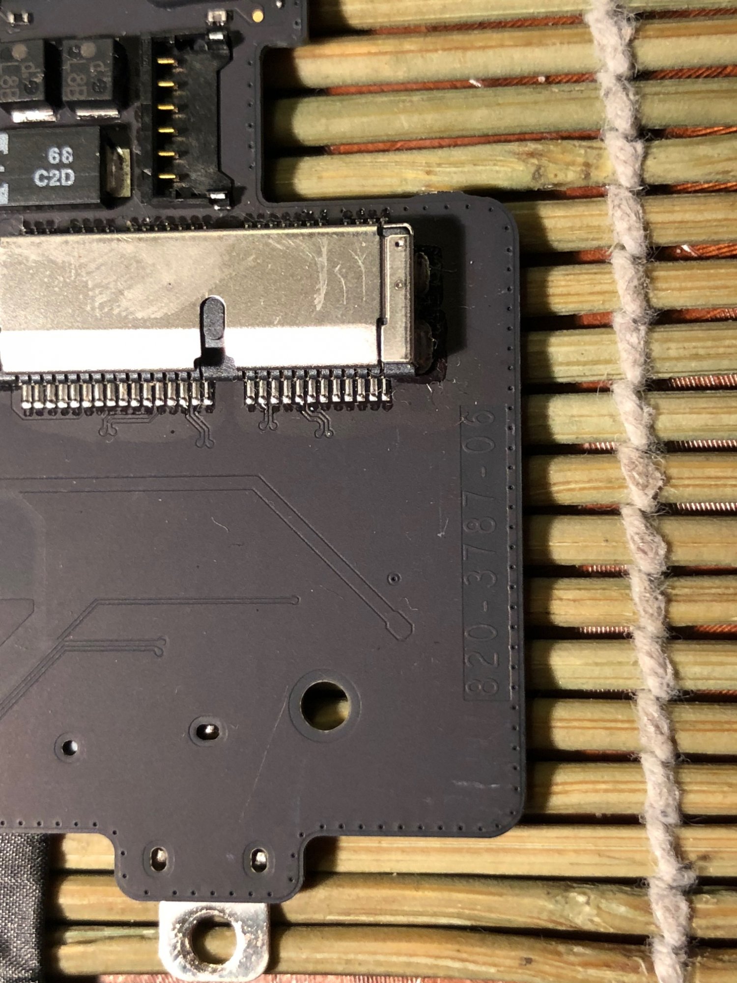

Unfortunately I’ve got a big problem. Let me introduce myself, I’m Covid-19 researcher based in northert Italy, just a bit abroad from you. I constantly work with my MacBook 15” late 2013 and I have a tons of patients data inside it. Suddently my MacBook stop power on for no reason (no Water no shock, I treat it like a baby). Plug-ing ac-adapter show green to amber light and IT does charge the battery (I misured output V), also perform an SMC reset, it work as I see changing in charger light to green and then amber again. But when I try to start it no life at all. I pulled logic out and start measuring power rails according to the schematics. My board is 820-3787-06. I found that Pp5v_s5 1.1v and Pin 14 u7501 1.1v constantly instead of 5v.

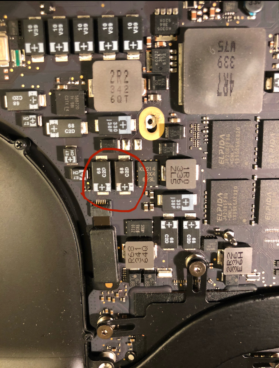

When I put the DC-IN I can notice that capacitor C7580 become damn hot like is burning, I think I might be shorted to ground (multimer been on both + and - of this CAP). This cap output is 0.78V. Could be this my problem? Now my question is.. there is something I can try/measure/replace in your advice?

Try to replace the tant caps, maybe they are hot for some reason.. with schematics it shouldnt be problem for skilled person to get it to work. Try to ask some electrical guy
