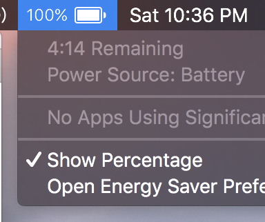

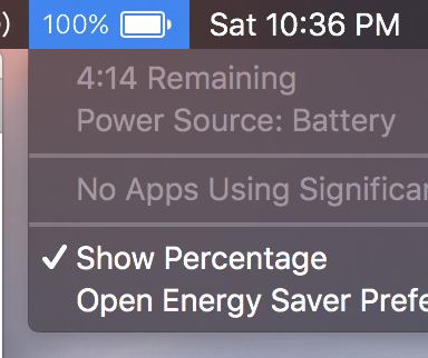

Just took mine off the charger (100%), playing some music with iTunes via airplay. Have email and this safari window open, apple quotes 4.14 hours remaining.
Reactions: saudade and luddx
