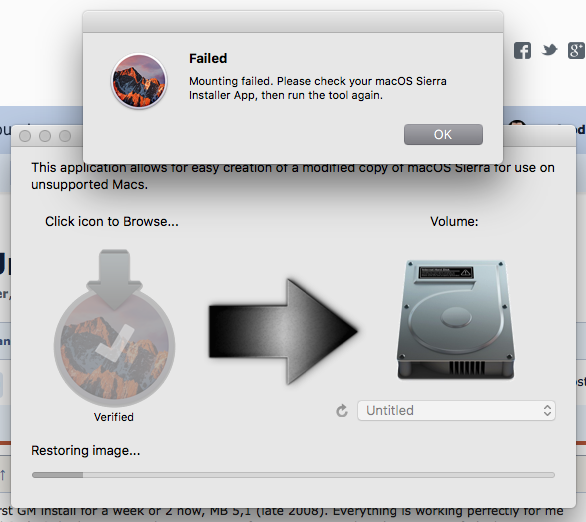

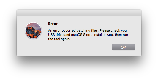

I am receiving this error using the macOS Sierra Patcher
I've tried a couple of USB sticks but both getting same error.
Something is wrong with your copy of the Install macOS Sierra app. Re-download it and try again.
Ah ok, I see that when I use the download in the other menu it signs in with your MAS account - thats pretty clever 😉
[doublepost=1474414054][/doublepost]OK so it downloaded the image but I get error again.
Make sure you format your USB drive correctly as Mac OS Extended (Journaled) with GUID partition scheme. If that doesn't work, try a different drive.
