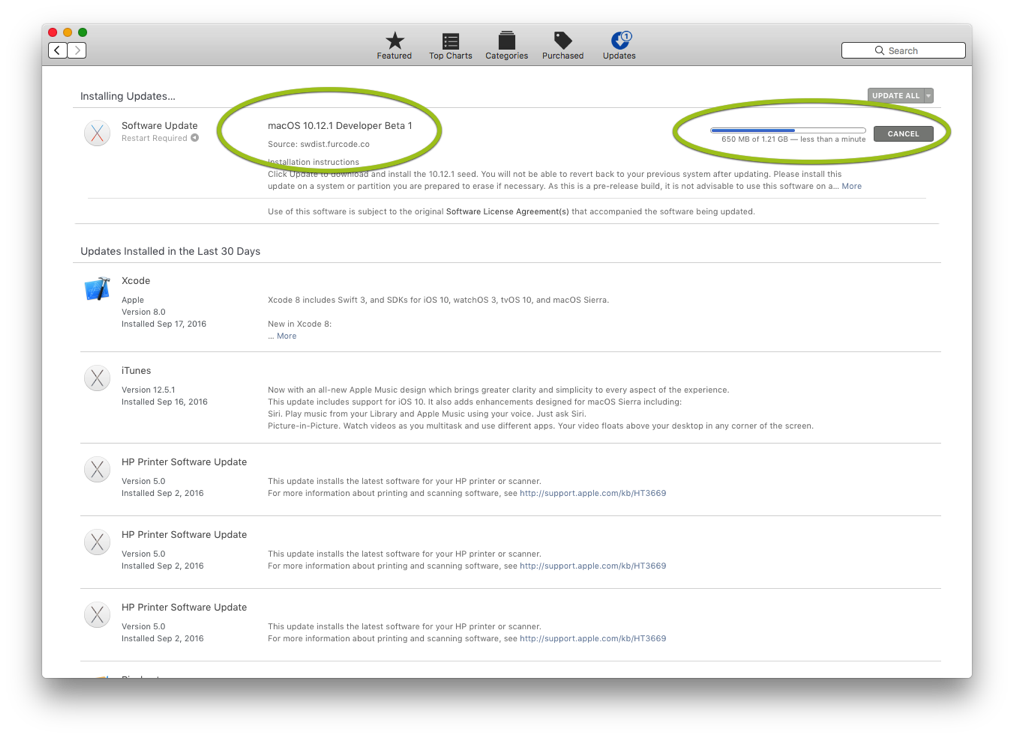

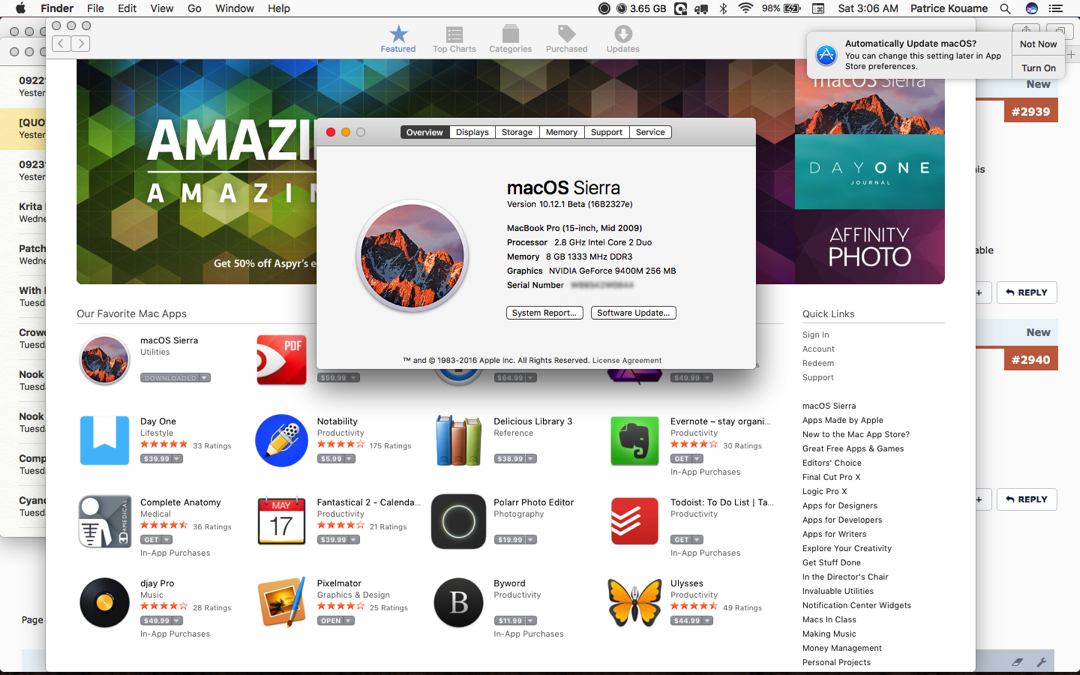

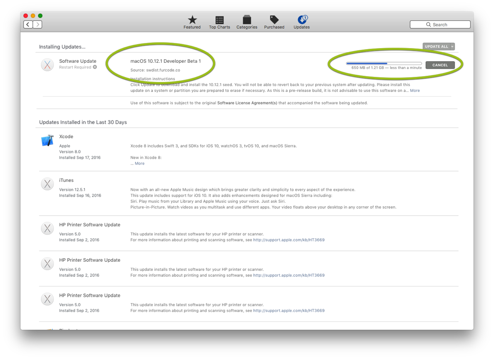

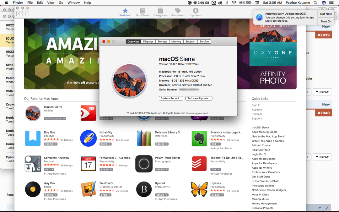

Just to note, the final Sierra catalogs for the AUS (Alternative Update Server; yes, I gave it a name) are in two branches:
http://swdist.furcode.co/index-10.1...n-lion-snowleopard-leopard.merged-1.sucatalog
10.12seed (Developer Previews) contain beta updates before they go out to users. Notably, this branch is usable by both Public Beta and Developer Preview builds, so there's little point to maintain the Public branch anymore (10.12beta) since it gets the same updates, but on a delay. 10.12.1 is already available in this branch.
10.12 is just standard updates in their final and regular schedule, and it is the same set of updates used in the production version of Sierra.
Both contain Application updates in general (iTunes, Safari) and new updates are on autopush, so the Mac App Store should be able to notify when they're available automatically.

Just got my first update: 10.12.1 Beta via standard Mac App Store (MAS) using @foxlet Sierra catalogs. Smooth as silk...
NOTE: And NO need to patch, it installs and reboots straight back into Sierra.
RESULTS:
on mbp 5,3
video (Photo Booth) ok
microphone ok
wifi ok
kbd ok
bt ok
trackpad ok
screen ok
USB disk ok
restarts ok
cold reboots ok
HOW:
Code:
$ sudo softwareupdate --set-catalog http://swdist.furcode.co/index-10.12seed-10.12-10.11-10.10-10.9-mountainlion-lion-snowleopard-leopard.merged-1.sucatalog
$ softwareupdate --list
$ /Applications/App\ Store.app/Contents/MacOS/App\ Store
See attached. Many thanks again for this generous work of yours. The AUS Lives...
