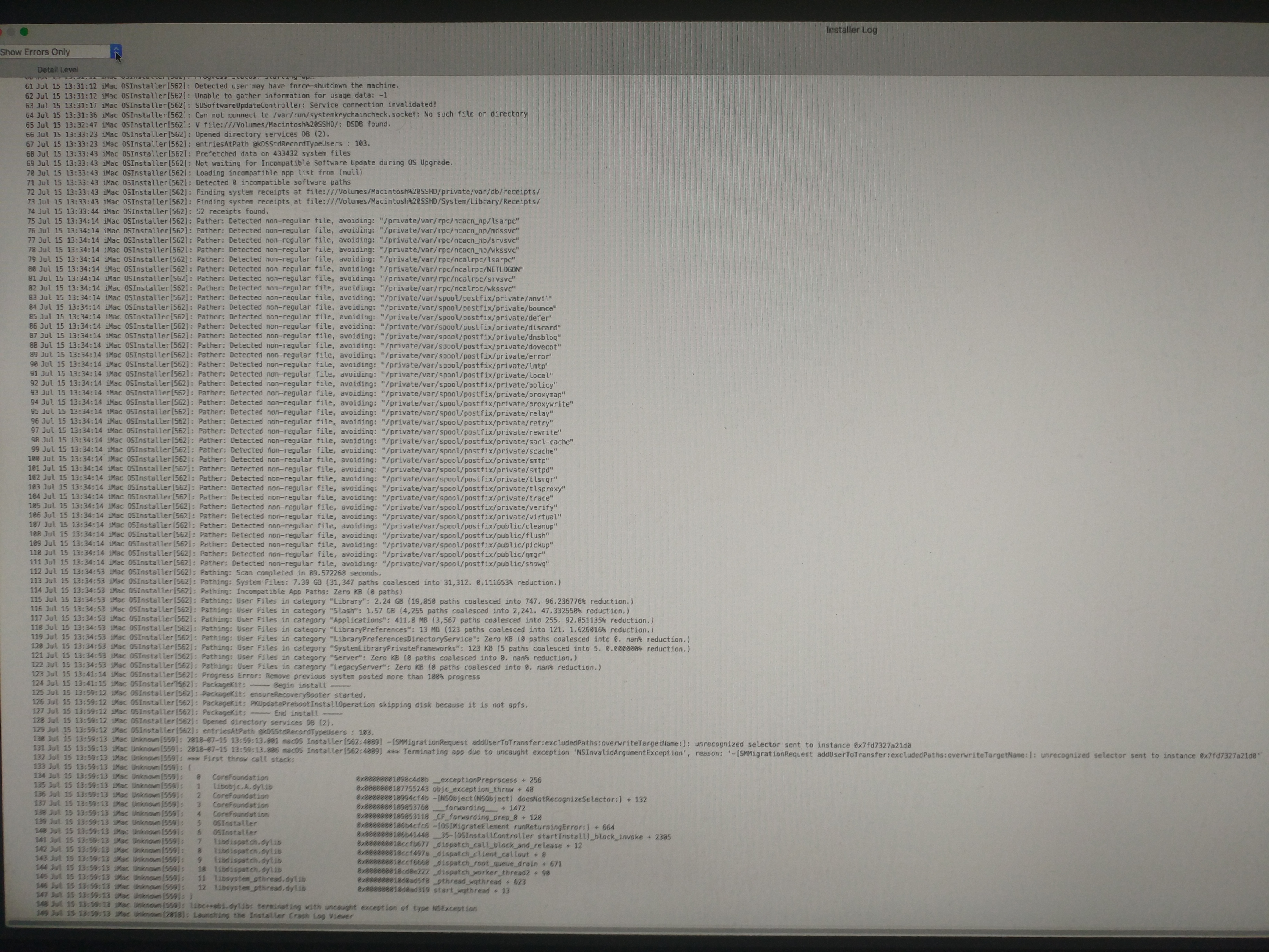

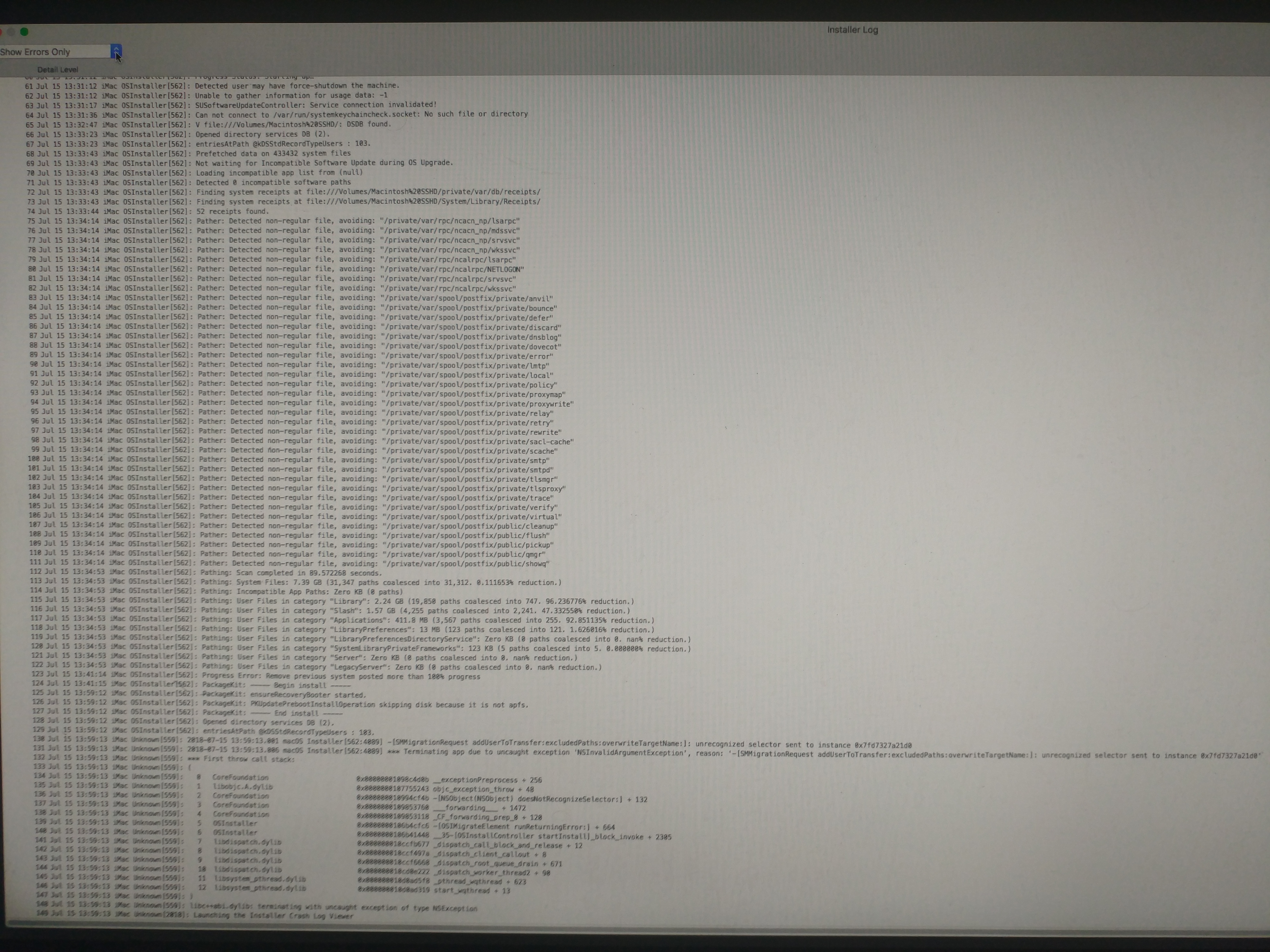

Really no one is gonna help me?
It wont boot...im stuck here...
