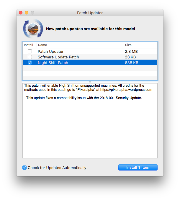

Can you try patching again (re-install the patch using Patch Updater), and send me the resulting CoreBrightness if it ends up not working? I'm not sure what's going on, but I need to see if something's going wrong during the patching process. It worked fine during my testing, so I don't understand why it's not working for you.

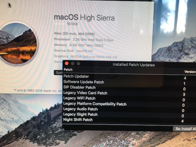

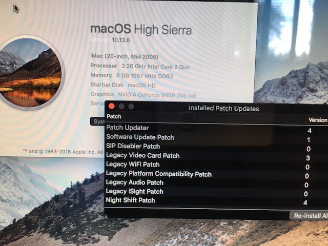

I have tested it on my iMac 9,1 High Sierra 10.13.6 and night swift works fine
Reactions: jackluke

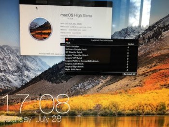

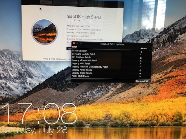

screenshots

"All credits for the methods used in this patch go to "Pikeralpha" at https://pikeralpha.wordpress.com" that is the one that breaks your system, is that just a bug? And if I do this and it does not work, can I revert changes?

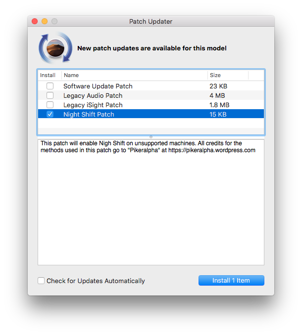

I am installing the patches on High Sierra 10.13.6, and I downloaded the Patch Updater using the .sh script. Didn't dosdude release a Night Shift patcher?
