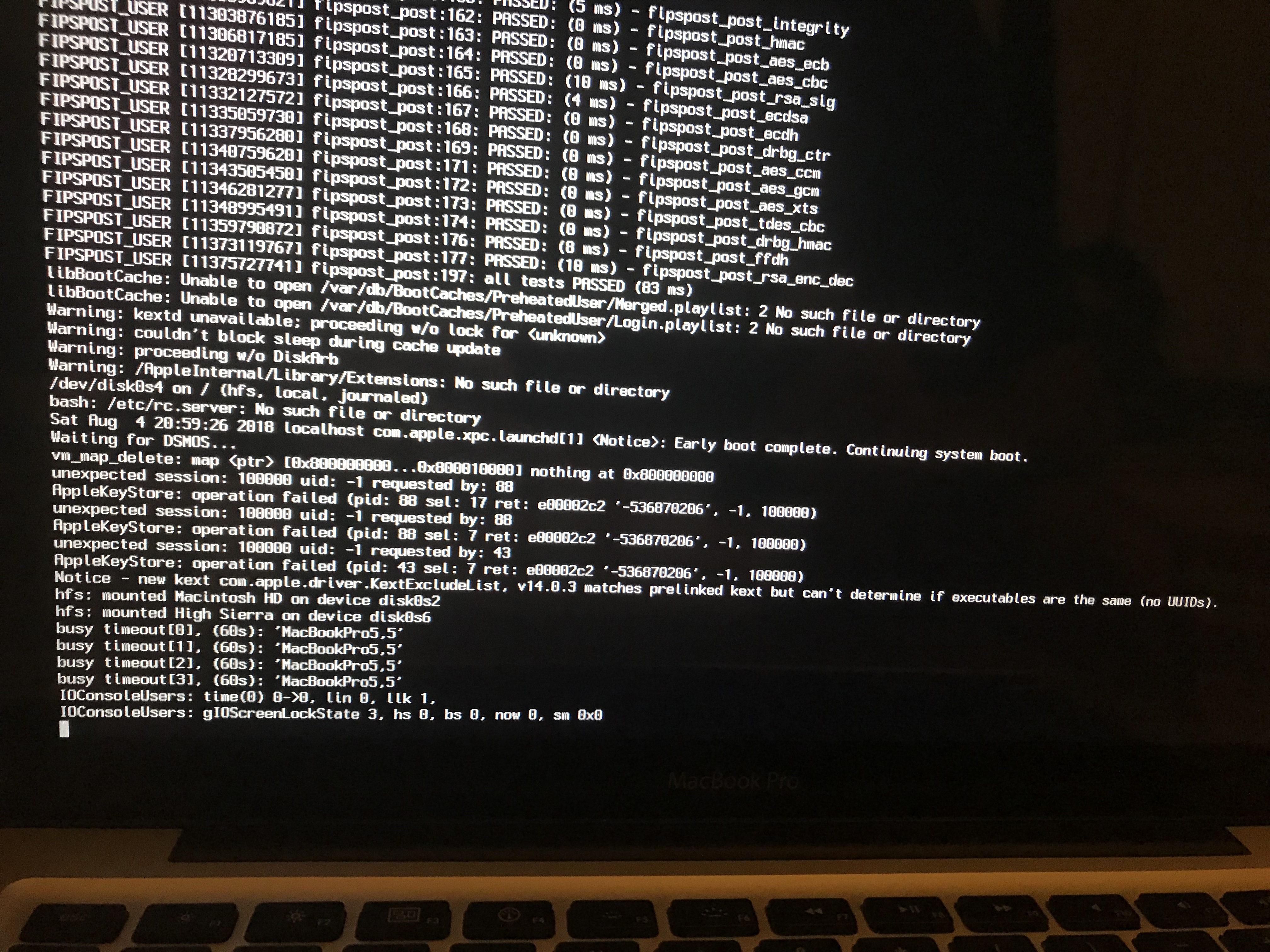

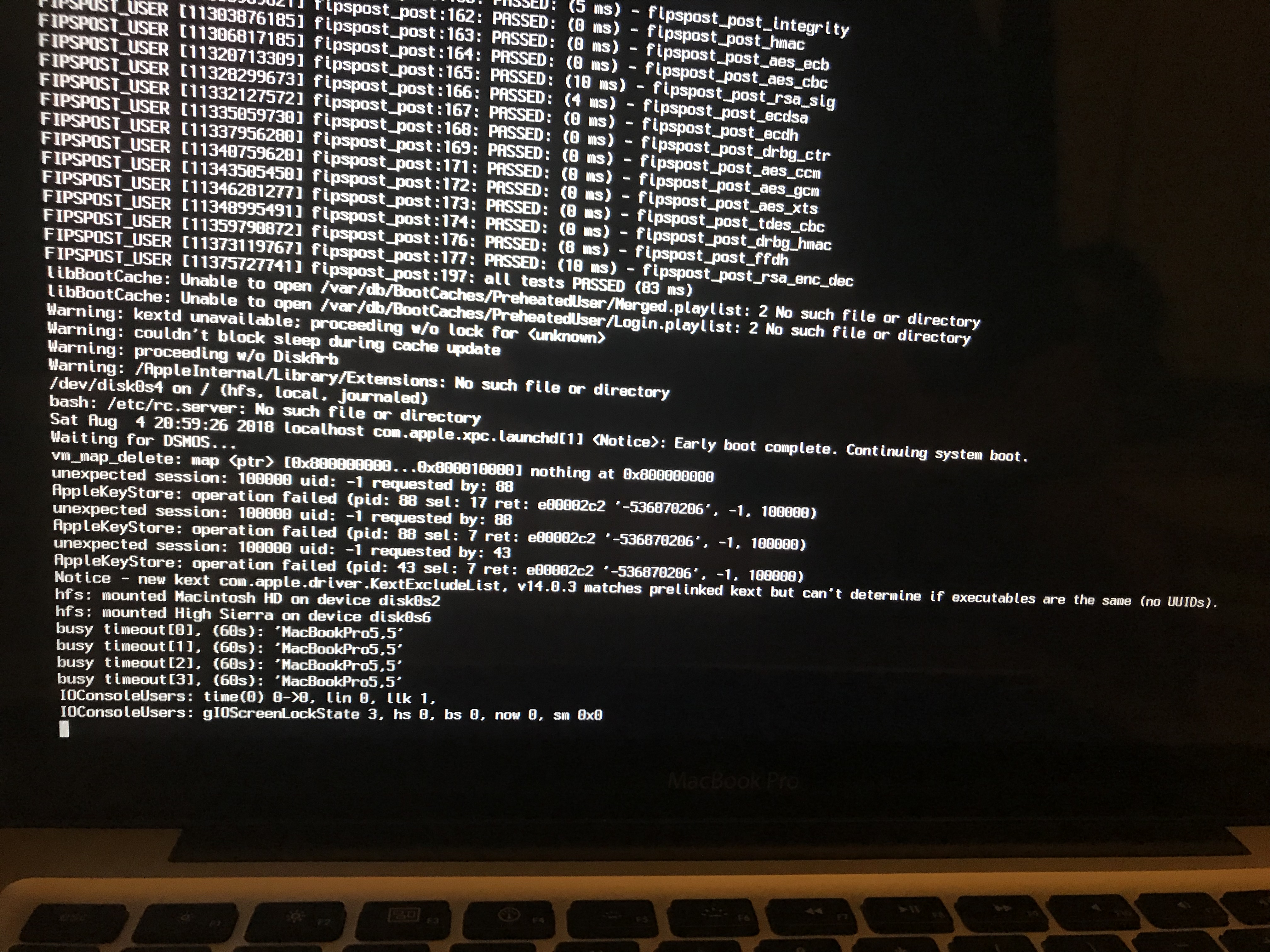

Run into a large problem. Redownloaded patcher, redownloaded Mojave, rewrote it to a drive, reinstalled Mojave. Ran post install, and now it refuses to boot. It was booting perfectly before reinstall. After “Waiting for DSMOS” it just gives back “operation failed” followed by “unexpected session” followed by busy timeouts. I’ve ran into this issue with high Sierra in the past, and the only solution I’ve found is a clean install. Any advice?
Reactions: TimothyR734
did you try force rebuild caches after you did the post install
Open the USB drive /Library/Preferences/SystemConfiguration/com.apple.Boot.plist
Change the kernel flags to -v -no_compat_check
See if that helps.
No dice. I even included the -keepsyms on the kernel flags along with the ones above.
It got along further, verbose boot messages received and then gray screen with the prohibitory sign. But boot messages continued. After a while, I just powered off. Still looking at other options. Thanks for the suggestion.
I'm 90% sure the "operation failed" and "unexpected session" messages are normal. The busy timeouts happen to me too (very rarely) since Sierra or High Sierra. Never figured out the source. I just force a reboot and it works fine the second time.
