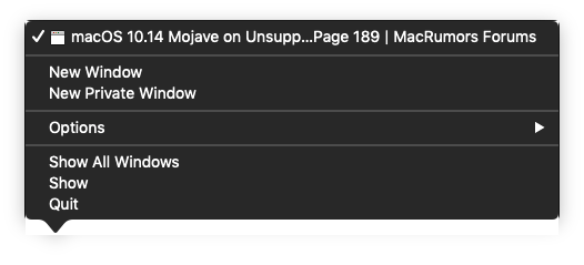

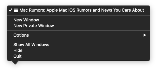

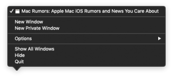

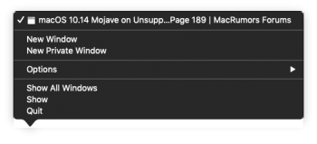

Apparently the glitches from the context menu are not connected to the beta.
First screenshot is beta 18A353d on my MBP 8,2 late 2011 and the second one is the same beta on my supported nMp.
The grey highlight frame is missing as well..
