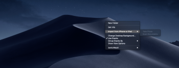

Hi Guys, just being curious to know on my iMac 11.2 still deactivated two features: take photos and scan documents as you can see the attached screenshot of my desktop, btw, i have ipad air.
My question is do you have same situation? is it still disabled on betas ? how about supported macs same sitation?

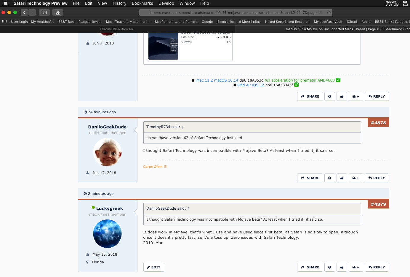

From 6 June MacRumors
Apple today released a new update for Safari Technology Preview, the experimental browser Apple first introducedover two years ago in March of 2016. Apple designed the Safari Technology Preview to test features that may be introduced into future release versions of Safari.
Apple's aim with Safari Technology Preview is to gather feedback from developers and users on its browser development process. Safari Technology Preview can run side-by-side with the existing Safari browser and while designed for developers, it does not require a developer account to download

@Luckygreek How the heck did I miss the macrumors June 6 post. I am such a diligent (and passionate) viewer and poster on this site, I am not sure how I missed it 😛
@TimothyR734 Yes, I am using version 62. Now if I can only find a dark mode extension (one similar for Google Chrome - my default web browser), I might shift to this as my default browser.
Based on Apple's System Requirements, it needs Bluetooth 4.0 LE support, which 2012 models have. My question is will it enable Auto Unlock with Apple Watch, does anyone know?
For those devices, you will need to get the Continuity Activation Tool (CAT) and also get a Bluetooth 4.0 USB Adapter, or replace your AirPort WiFi Card with one that supports Bluetooth 4.0 Low Power Transfer. Here is a link about macOS Mojave's support, and here are some recommended Bluetooth 4.0 USB adapters: @dosdude1, these should work?
  • Bluetooth 4.0 dongles based on the Cambridge Silicon Radio CSR8510 A10 chip (e.g. Inatek Nano) are not compatible with CAT.
  • Atheros Wi-Fi AirPort cards will prevent Continuity from working even when adding a Bluetooth 4.0 dongle. The System Diagnostic feature of CAT tells which Wi-Fi brand is active. There are no workarounds and no patch is expected to change this, an AirPort card upgrade is required.
"Asus BT400, IOGEAR GBU521" are the recommended ones that have been tested and work.
Source: http://www.iphonehacks.com/2014/12/continuity-activation-tool-bluetooth-dongles.html
