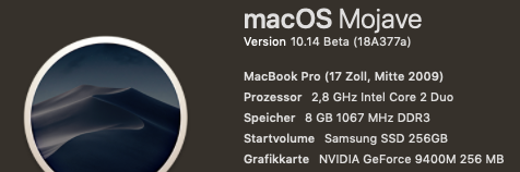

Updated to PB8 (=DP9) from PB7 with System Settings -> Software Update, then Post Install with Mojave patcher (version 1.1.2). No issues, only had to select Force Cache Rebuild in Post Install.
(MacBookPro5,2 17", APFS ROM patch applied, external SSD with APFS)

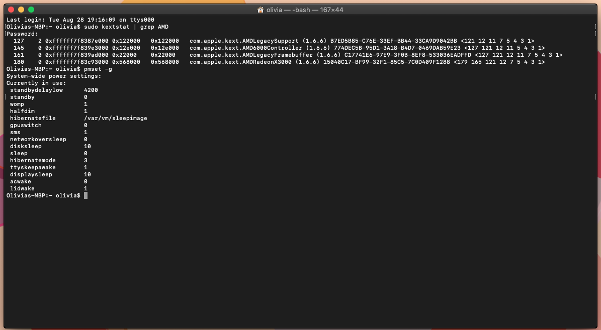

Unfortunately Dosdude's disable GPU has broke 2 things for me:
1) Sleep doesn't work (ie close shell doesn't go to sleep) or even via apple > sleep
2) Brightness control is gone from keyboard and in settings

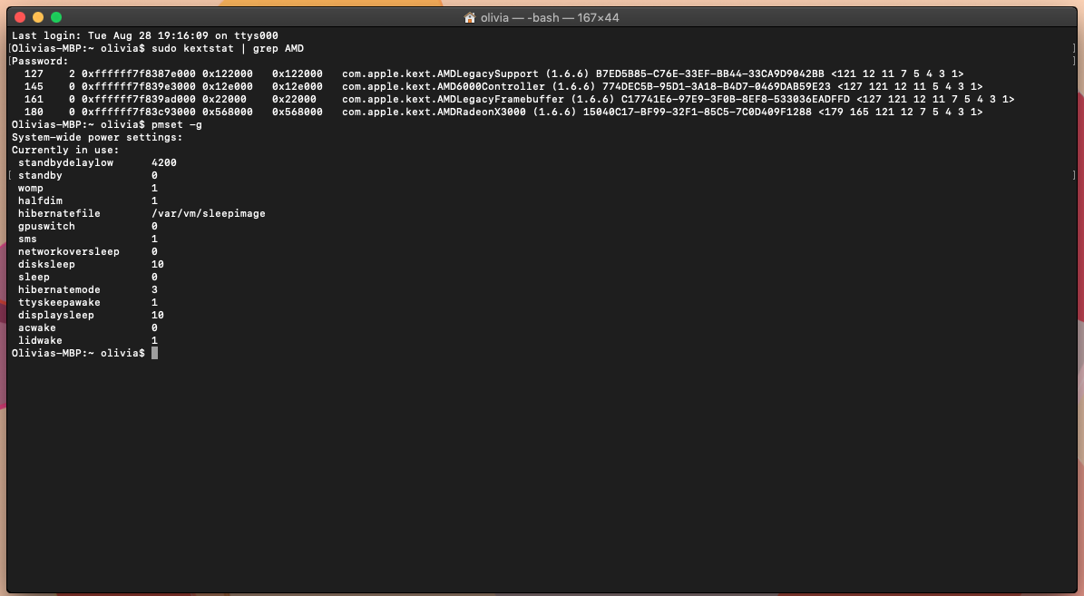

I have both brightness control and sleep working in Mojave on my 15" mbp with a broken gpu that won't even boot unless disabled, this is how I did it :
(If you want to try this method, just apply the post install patches again and start from #3.)
1 boot into single user mode and set nvram variable:
sudo nvram fa4ce28d-b62f-4c99-9cc3-6815686e30f9:gpu-power-prefs=%01%00%00%00
2 install Mojave, then apply patches.
3 boot into single user mode again, type:
/sbin/mount -uw /
mkdir AMD
mv /System/library/Extensions/AMDRadeonX3000.kext AMD/
reboot
4 open terminal, type:
sudo mkdir -p /Library/LoginHook
sudo nano /Library/LoginHook/LX3000.sh
contents:
#!/bin/bash
kextload /AMD/AMDRadeonX3000.kext
exit 0
press ctrl + x to exit and y to save.
sudo chmod a+x /Library/LoginHook/LX3000.sh
sudo defaults write com.apple.loginwindow LoginHook /Library/LoginHook/LX3000.sh
5 set gpu for sleep to integrated:
sudo pmset -a gpuswitch 0
reboot
6 check that x3000 is loaded and gpu is set to integrated
sudo kextstat | grep AMD
pmset -g
compare to the screenshot to make sure its correct.
7 optional, increase vram for hd3000 using Jacklukes method here
You have to do #1 again each time the nvram is reset.

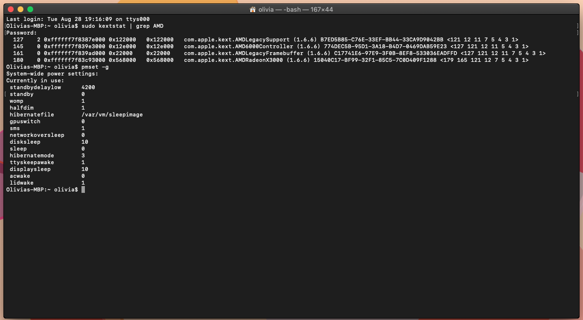

/sbin/mount -uw /
mkdir AMD
reboot
contents:
#!/bin/bash
exit 0
reboot
pmset -g

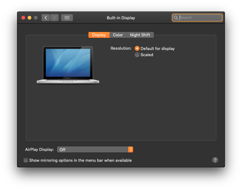

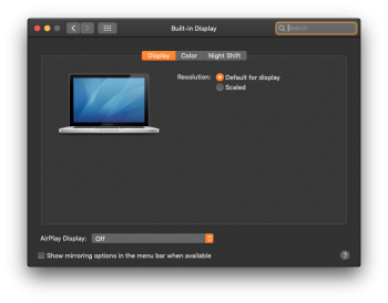

Thanks for that.
Unfortunately display slider is still not working (it did before the Dosdude patch).
