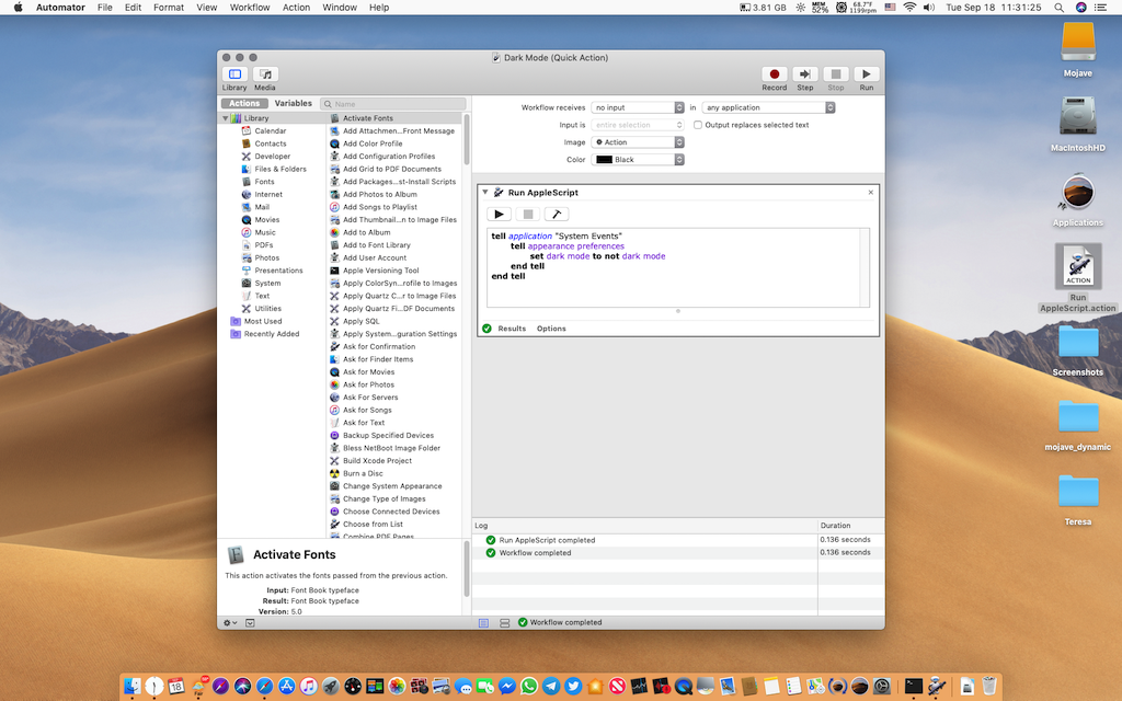

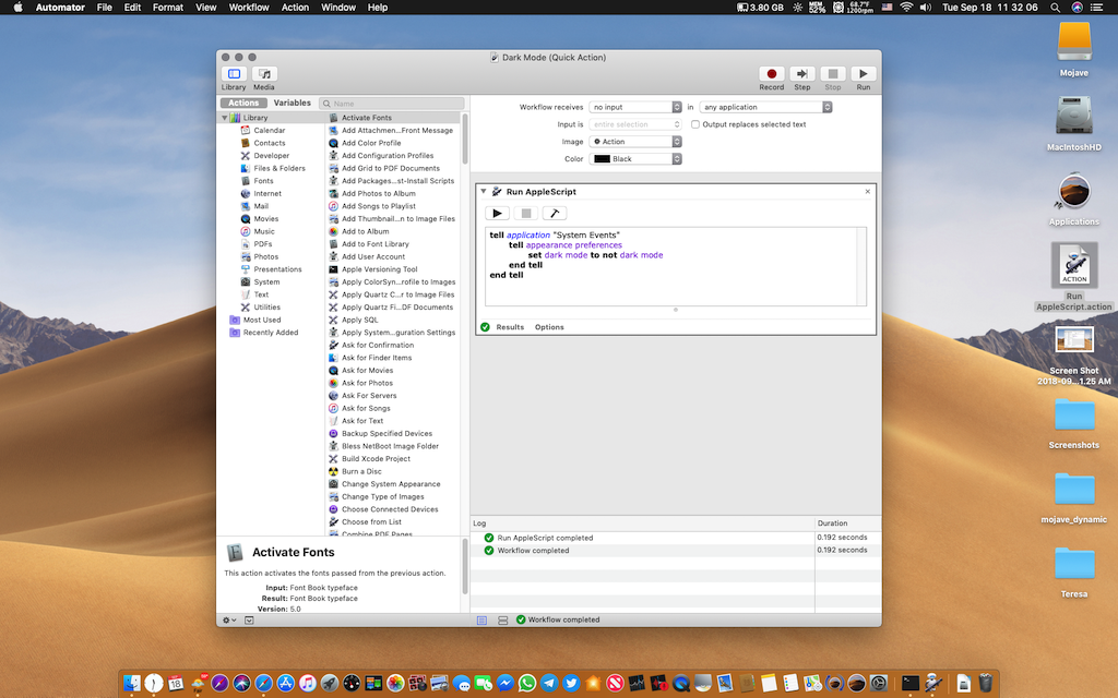

Running the automator does toggle light to dark mode 🙂 I used control, command and D as my keyboard short cut
If @pkouame will discover a way to apply its "hybrid light mode" through an AppleScript telling to "System Events" something for HIToolBox or Appkit, that would be amazing. It's hard, I know.
edit:
@TimothyR734 it is not simple to chose a free keyboard shortcut, for example CMD+D I use very often to add my bookmarks favorites into Safari (or Chrome).
edit2:
Just checked ctrl+CMD+D open the dictionary on a select word, and unluckily F5 or F6 don't are accepted, while for ex. CMD+F5 is accepted but it launches VoiceOver normally, it seems every shortcut keyboard in macOS is already taken. Wait, probably CMD+(FN)+F6 is free, FN+F6 actually is F6 on a Mac keyboard.
edit:
I know I had to change mine to but another way is to right click what ever you named your script mine is dark mode it gives you 2 option show in Finder or open in automator
