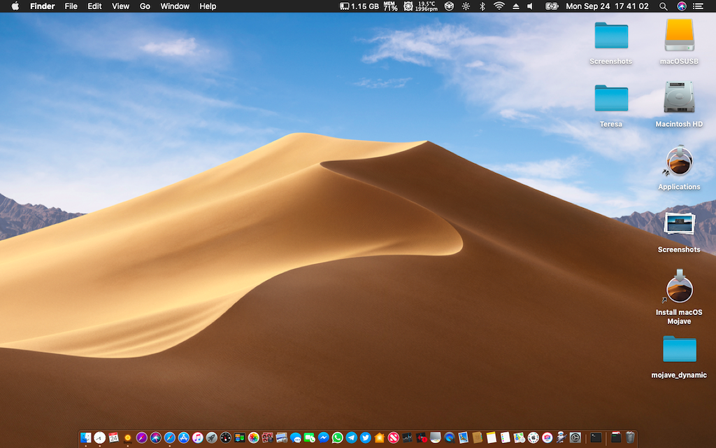

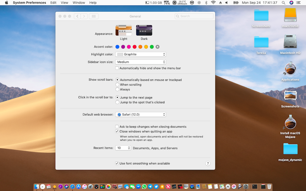

Light and dark mode with your menubar patch

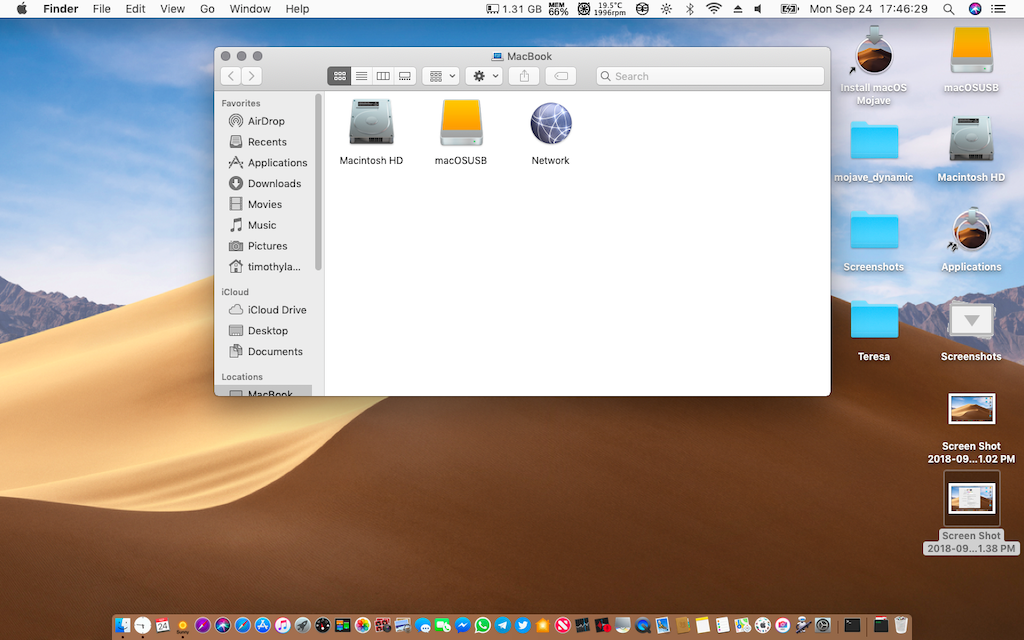

[doublepost=1537836607][/doublepost]Finder in light mode

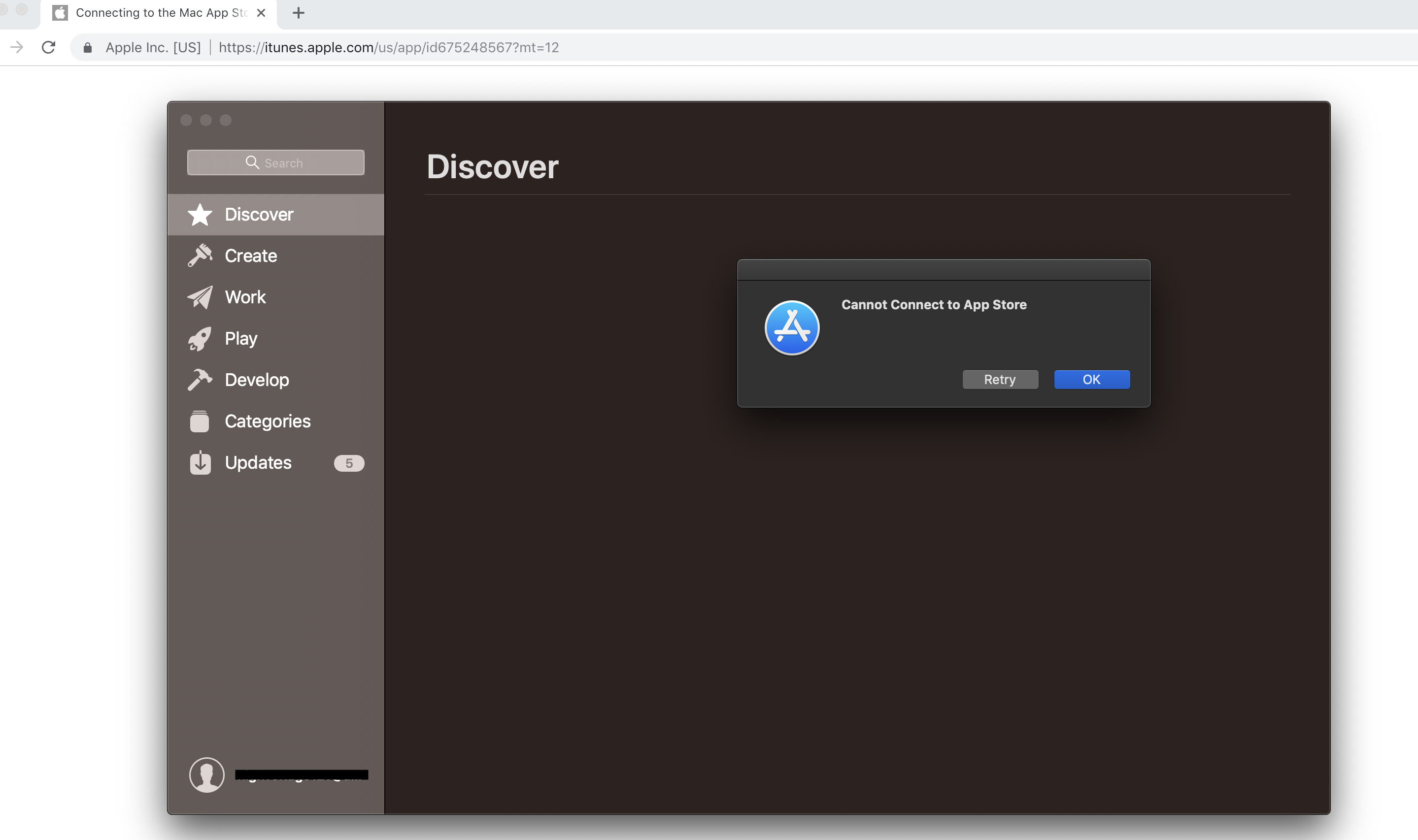

I'm sure Apple is doing this on purpose, when you go to download an Older version of Mac OS using the App Store Link (the search feature doesn't show older versions, neither does purchase history) it will not load the page to get the installer. It's like they are preventing us from getting older versions of Mac OS once you upgrade. I know this was their intentions this whole time, but this takes it to a new level.
Reactions: TimothyR734

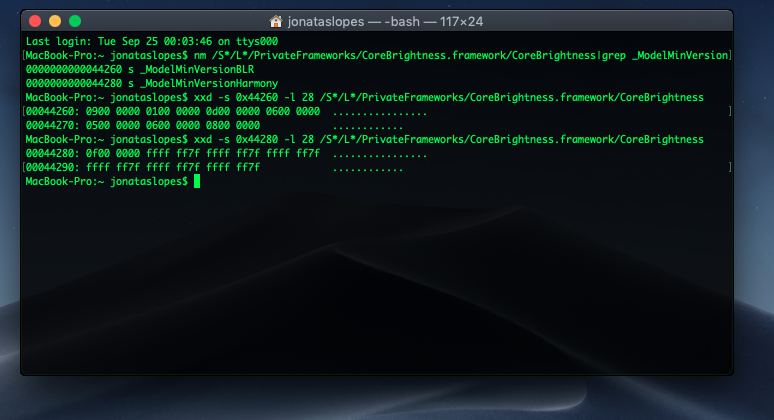

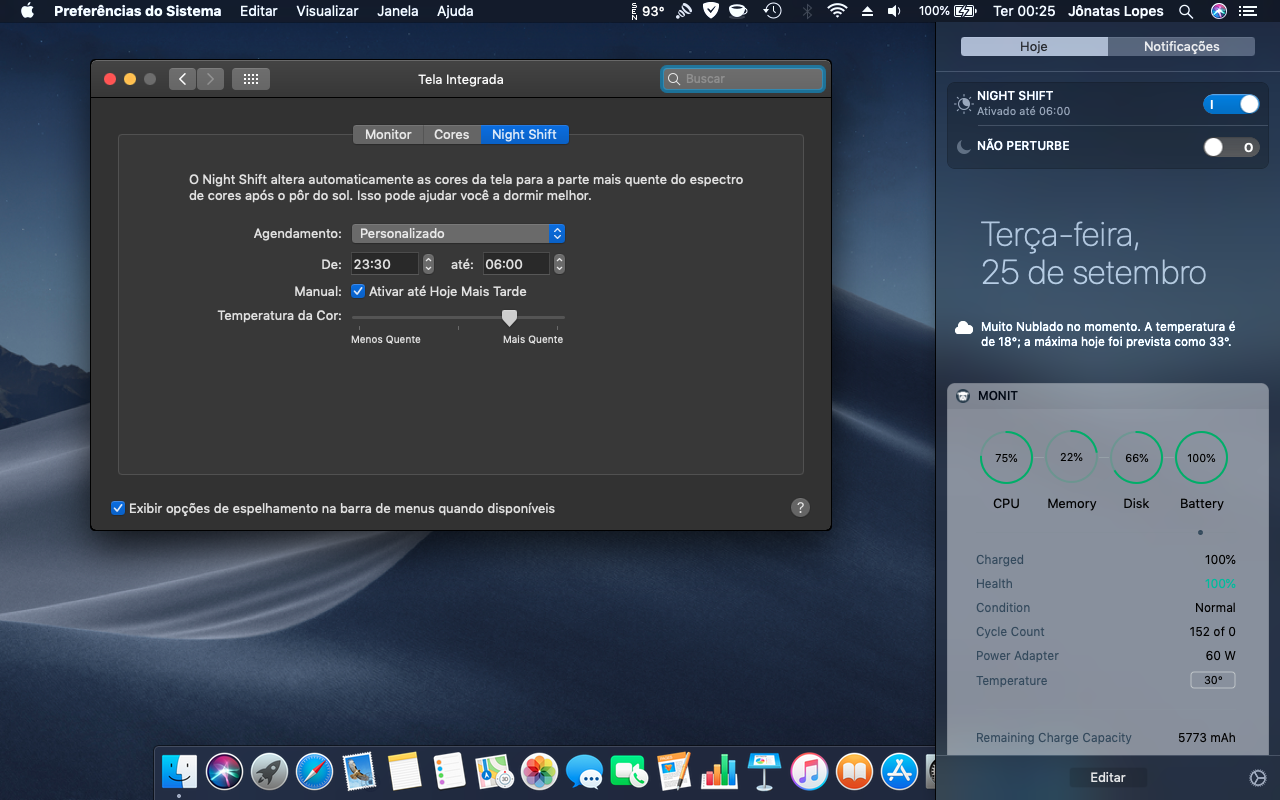

Terminal:
xcode-select --install
nm /S*/L*/PrivateFrameworks/CoreBrightness.framework/CoreBrightness|grep _ModelMinVersion
000xxxxx: 0900 0000 0100 0000 0d00 0000 0600 0000 ................
000xxxxx: 0500 0000 0600 0000 0800 0000 ............
MacBookPro9,x
iMac13,x
Macmini6,x
MacBookAir5,x
MacPro6,x
MacBook8,x
xxd -s 0xXXXXX-l 28 /S*/L*/PrivateFrameworks/CoreBrightness.framework/CoreBrightness
iHex open /CoreBrightness.framework/CoreBrightness
find: 0900 0000 0100 0000 0d00 0000 0600 0000
replace: 0700 0000 0100 0000 0d00 0000 0600 0000
save and close
replace CoreBrightness to /CoreBrightness.framework/CoreBrightness
and replace /S*/L*/PrivateFrameworks/CoreBrightness.framework
sudo codesign -f -s - /S*/L*/PrivateFrameworks/CoreBrightness.framework/CoreBrightness
reboot "MacBook Pro 2010"
working
credits: https://pikeralpha.wordpress.com
