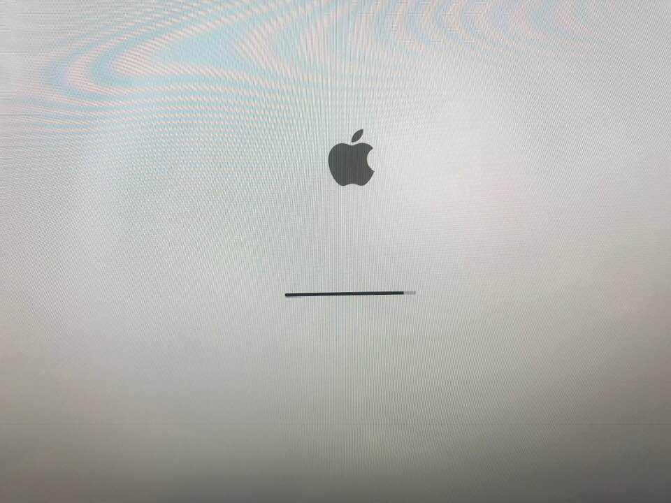

tired watching the bar after installing mojave osx 10.14 and using the tool , the fans are full power and i dont know what to do! i USED TO HAVE BEFORE the beta version and it was working really good!

Yes i followed doedude video instructions ! i have an imac 10.1 and i install the patches! now my machine cant load the macosx !
[doublepost=1537981816][/doublepost]
did you install the post install patches with the Mojave patcher
Yes i followed doedude video instructions ! i have an imac 10.1 and i install the patches! now my machine cant load the macosx ! Ι posted a pic
[doublepost=1537982712][/doublepost]I followed all the instructions and i there was a problem with the proccess! it show that the bar is full but still loading and the fans are in full power!
Reactions: TimothyR734
No...
Installed it using dosdude s patcher via usb stick.
And checked it after installing and patching. 391. So this is official release?
After booting first time, i re-installed all patches.
Then this error.
in my case, only worked Patcher 1.2.0 (10.14 final)
I have the same machine, I faced the same issue initially and the solution was to reformat with APFS instead of APFS(encrypted) ,try this it should work, however facetime camera is not working for me.

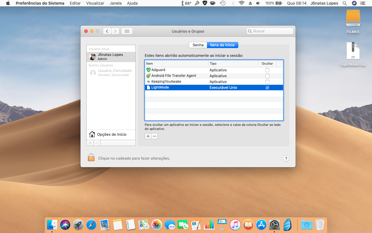

I just tried your binary applescripts, LightMode-v1 and LightMode-v2, it seems v1 works too, but both lack "Notification Center" transparency, in my opinion that gives a better overall look, not only the Dock and Spotlight.
Hi, I also tried the script and I have the same findings. Can you concise all of the methods to semi-fix Light Mode in one reply please?
Would be helpful for people(like me) are trying a lot of things.
You could try my comfortless method on page 279 , it won't work as login item but will give much customised control from Terminal.
Here is a dirty correction.
What I did was repeat the same lines with a pause, it worked.

I think just doing :
defaults write com.apple.universalaccess reduceTransparency -bool false
killall Finder
killall Dock
killall NotificationCenter
sleep 3
defaults write com.apple.universalaccess reduceTransparency -bool true
killall Finder
killall Spotlight
Should work.

It works, but not when you start with the system, it loses the transparency of the Dock and NotificationCenter
Only when I repeat the script that works, at least for me.
Yes, but it's not good enough to start the login, I need a more clinical look, so I marked all of you.
As far as reduce transparency via command line, what about @jackluke 's version/approach?
I have a more involved approach that cuts transparency at the AppKit l(Cocoa's GUI) level - leaving Dock and other panels that implement their own transparency alone (not as system wide as the accessibility setting(s) which is like turning the master switch OFF).
