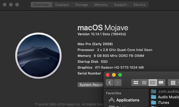

update Mac Pro 3,1 10.14.1 Beta 18B45d
de nada
That surely fixed it. Thanks Nekton1!
