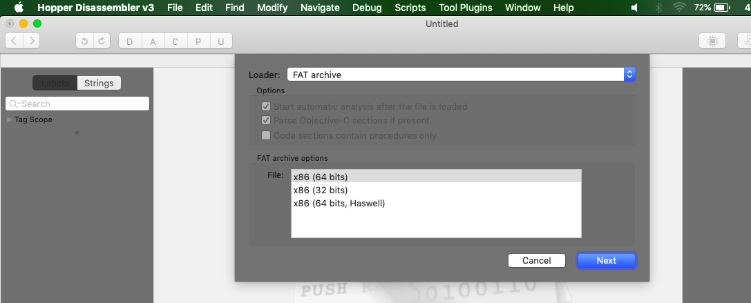

Not super relevant, but I noticed something neat -- some FAT binaries contain a 32-bit, 64-bit, and a 64-bit Haswell architecture. Why is this? Is this why the OS still boots on a Penryn system with only SSE4.1 (not SSE4.2)?

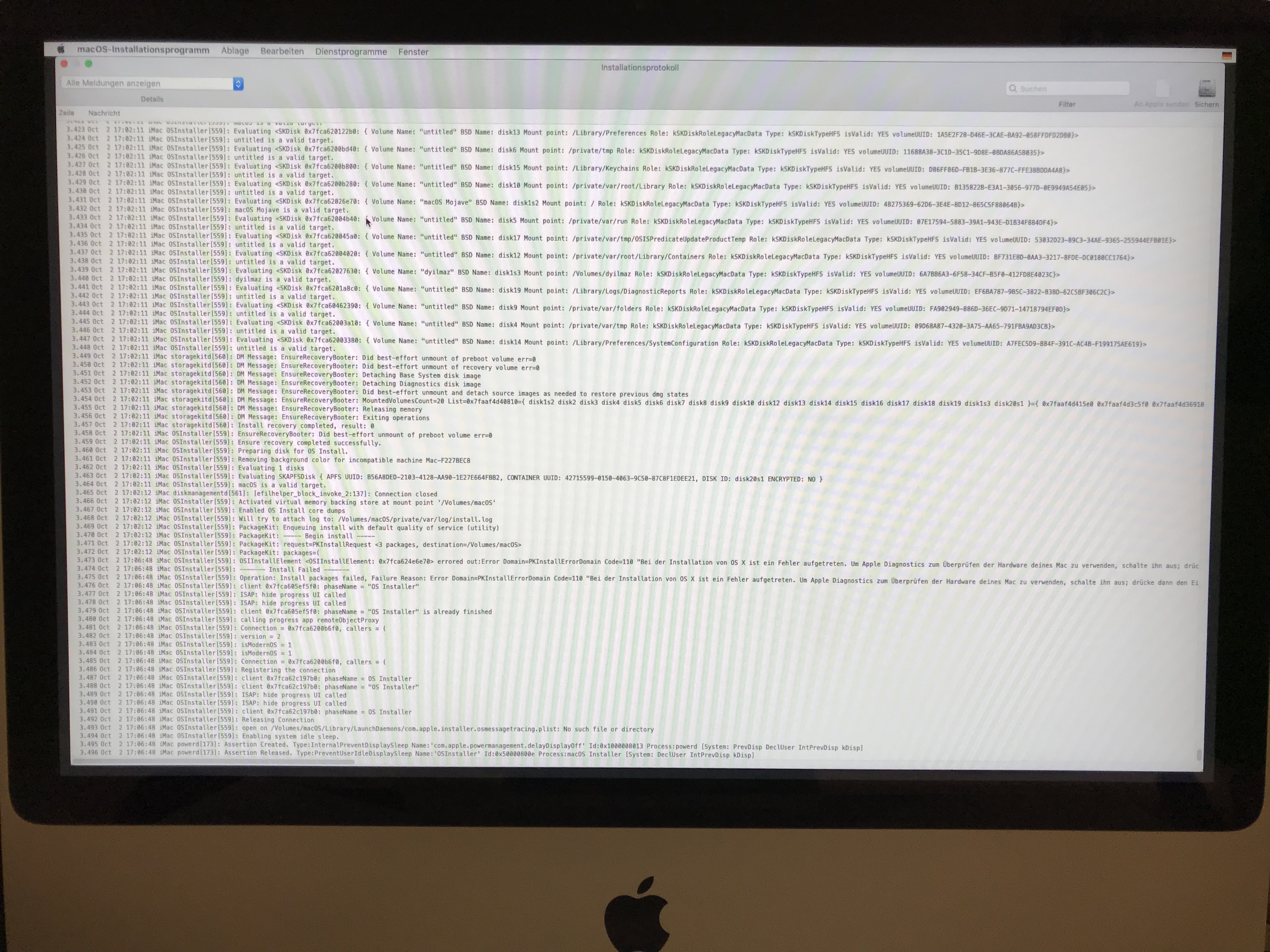

Yes expected, lets try one patch at once, boot from USB Mojave Installer, launch Terminal and type:
csrutil disable
nvram boot-args="-no_compat_check"
reboot
if you reach welcome screen but have no working trackpad and keyboard, then re-boot from the USB Mojave Installer, Post-Install and select only "USBOHCI support Patch" install and "Force cache rebuild".

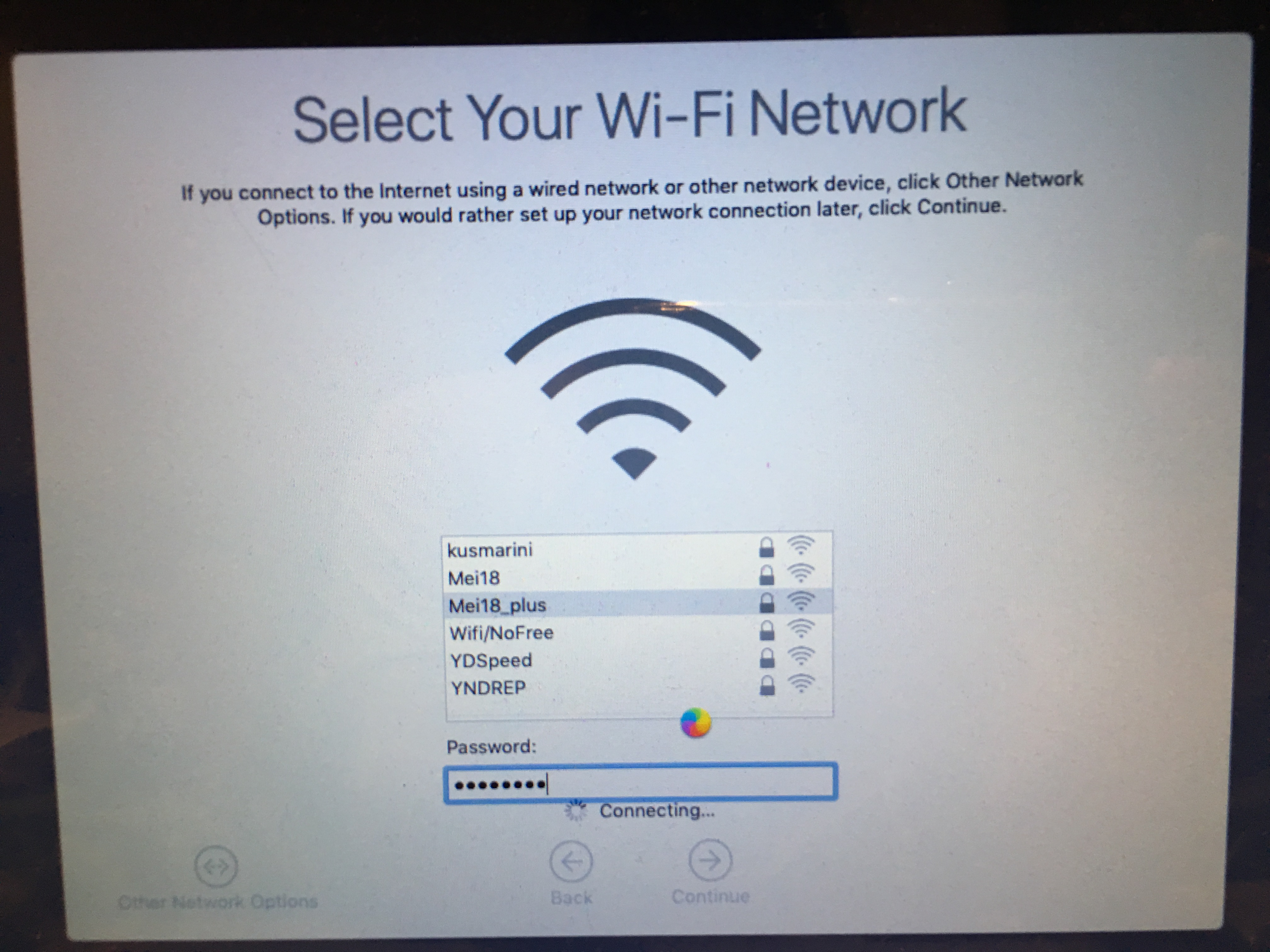

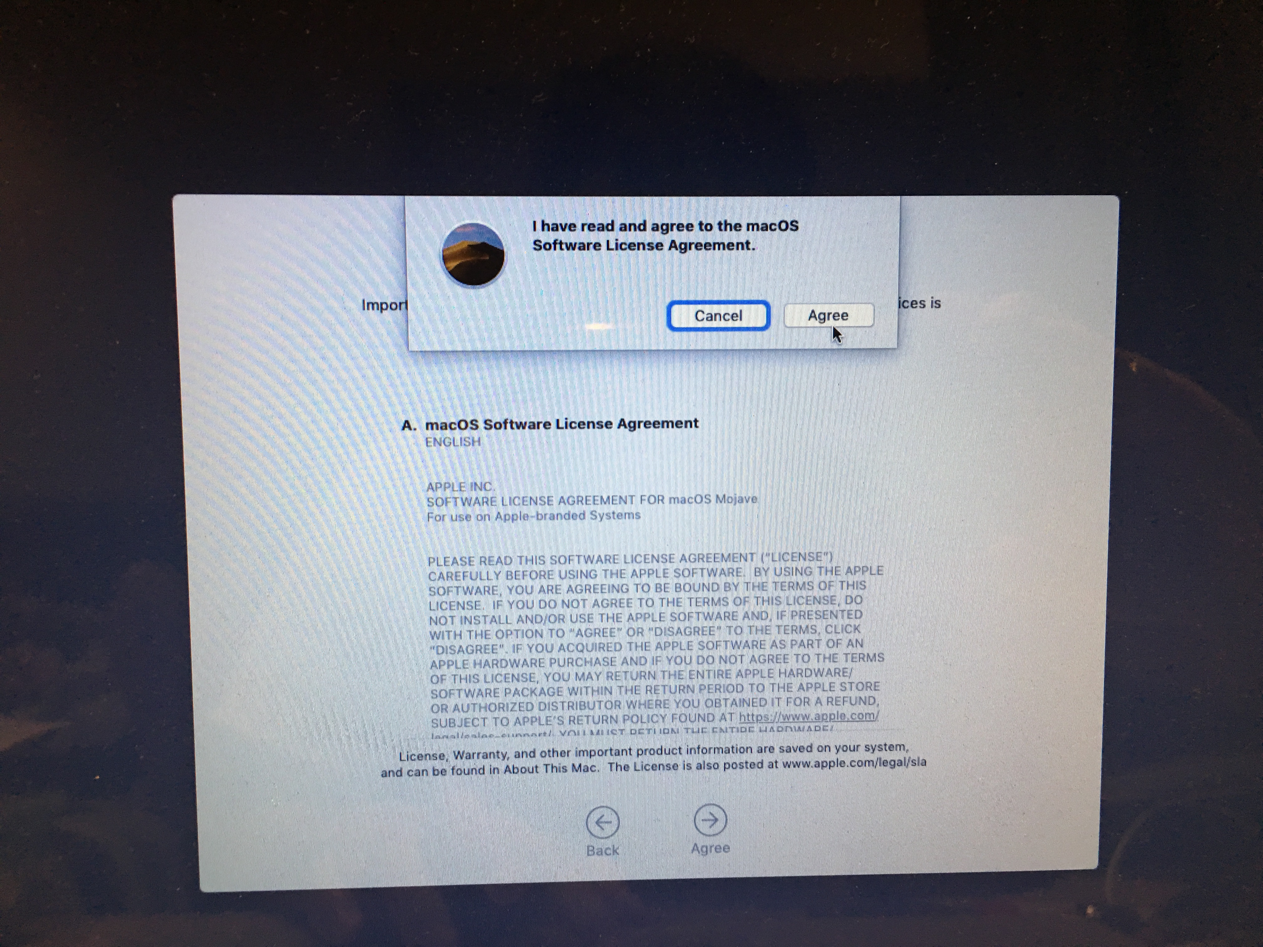

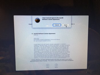

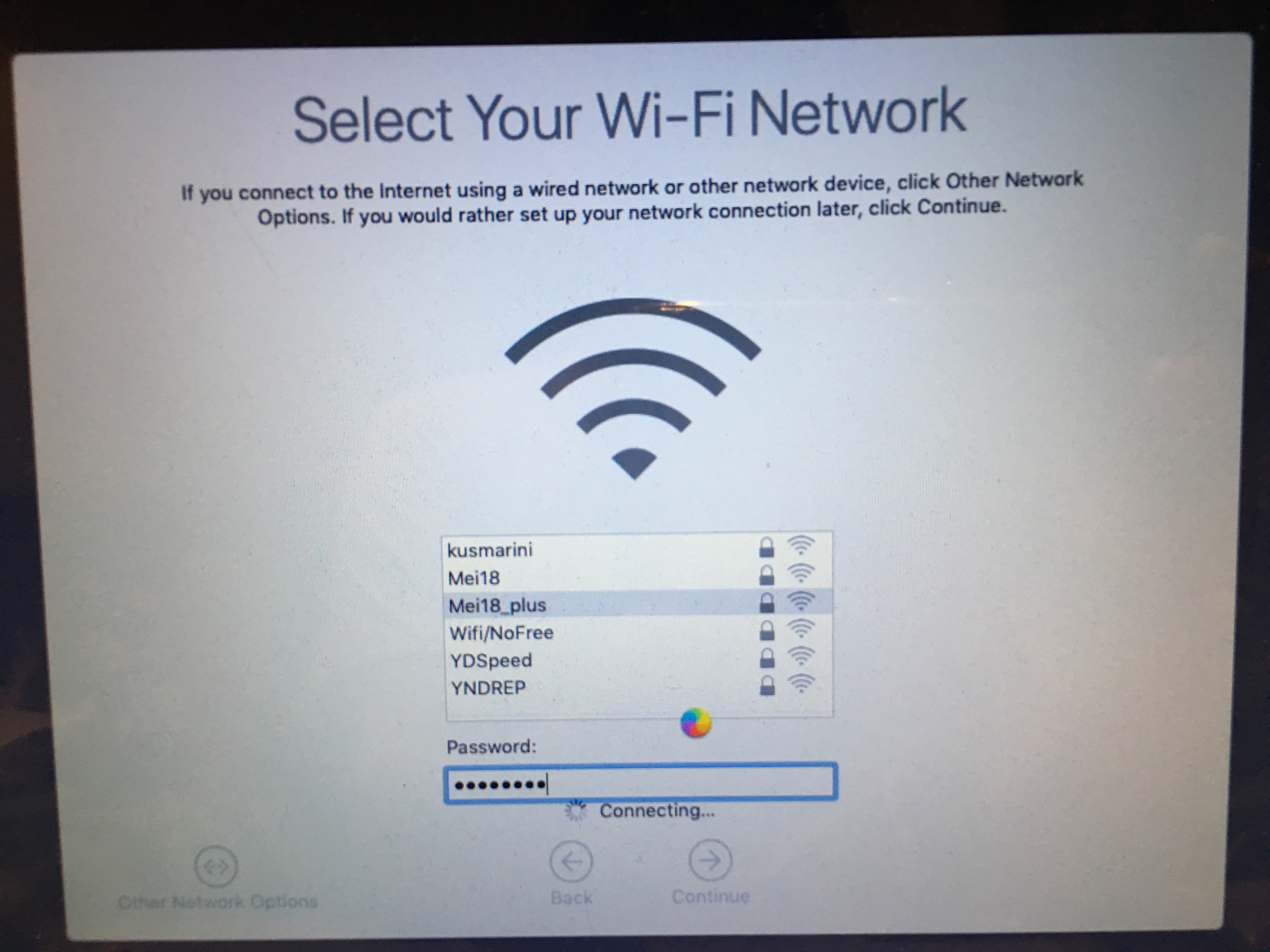

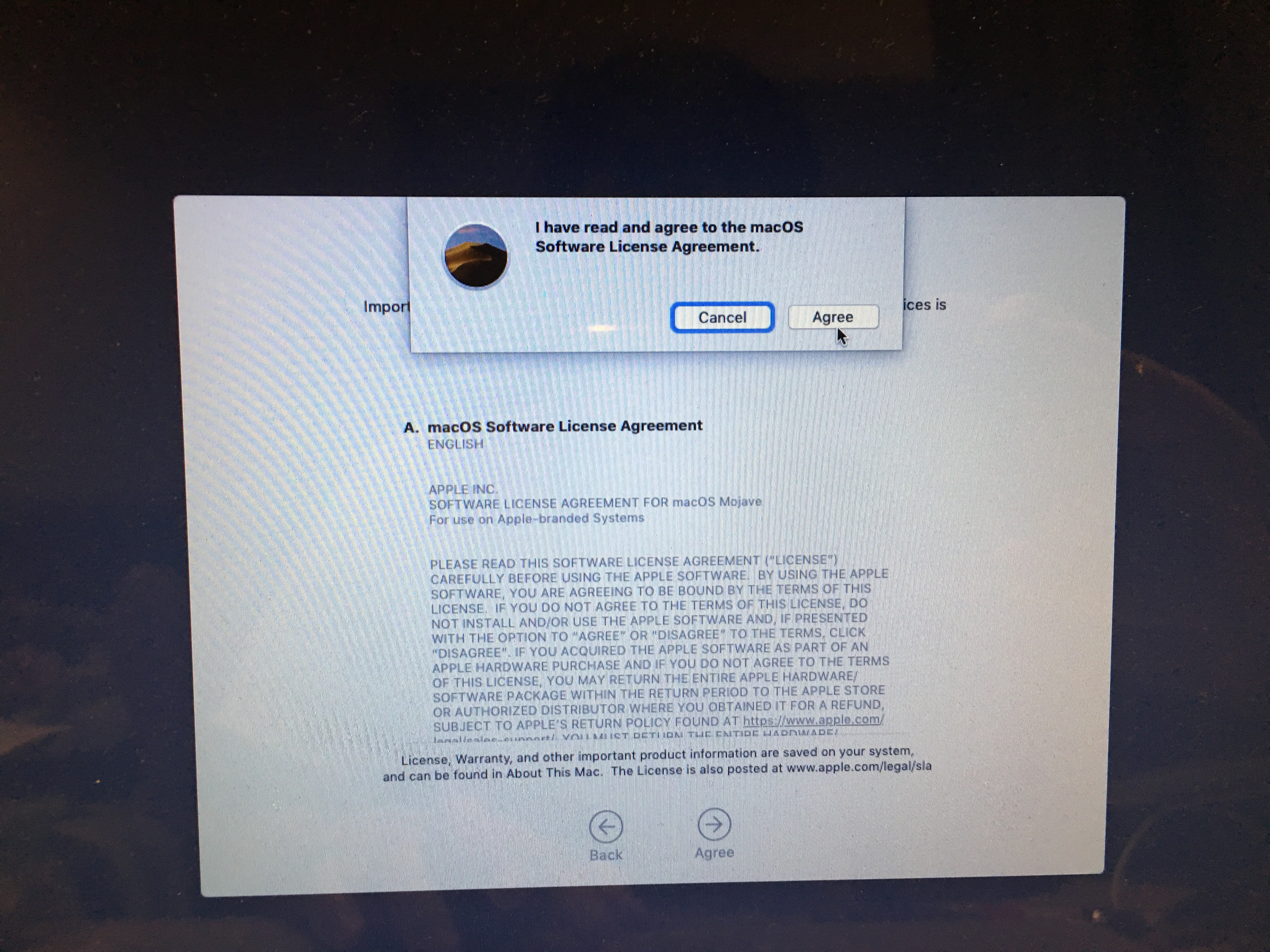

I reached welcome screen with working trackpad, keyboard, and WiFi. But after click Agree on SLA, suddenly reboot. It similar with my post here.
So what should I do next? I haven't done USBOHCI patch.
99% you have a faulty SSD.
But this at least confirms that "Sandy Bridge" Intel Chipset can boot with stock Mojave IOUSB***.kext and stock IO80211Family.kext
But this at least confirm that "Sandy Bridge" Intel Chipset can boot with stock Mojave IOUSB***.kext
Wow surprising 😵
I will buy new SSD and try to re-install.
But did you see on my first post #8356, I mentioned that I have faulty (dead) AMD GPU? Might a faulty (dead) GPU relate with this problem?

But did you see on my first post #8356, I mentioned that I have faulty AMD GPU? Might a faulty GPU relate with this problem?
I would disagree that it's the SSD. But you can always try an erase in Disk Utility and a re-install.
Sounds more like a kext/hardware problem. Maybe the GPU? Perhaps @dosdude1 can chime in.

I guess no, since it worked on your HighSierra, and simply because if you see the Welcome Screen it means one of two GPUs is working, and consider that without installing Video Patch you are using GPUs with least effort.

This time (probably first time) I'm in disagree with you, to me it's a faulty SSD.

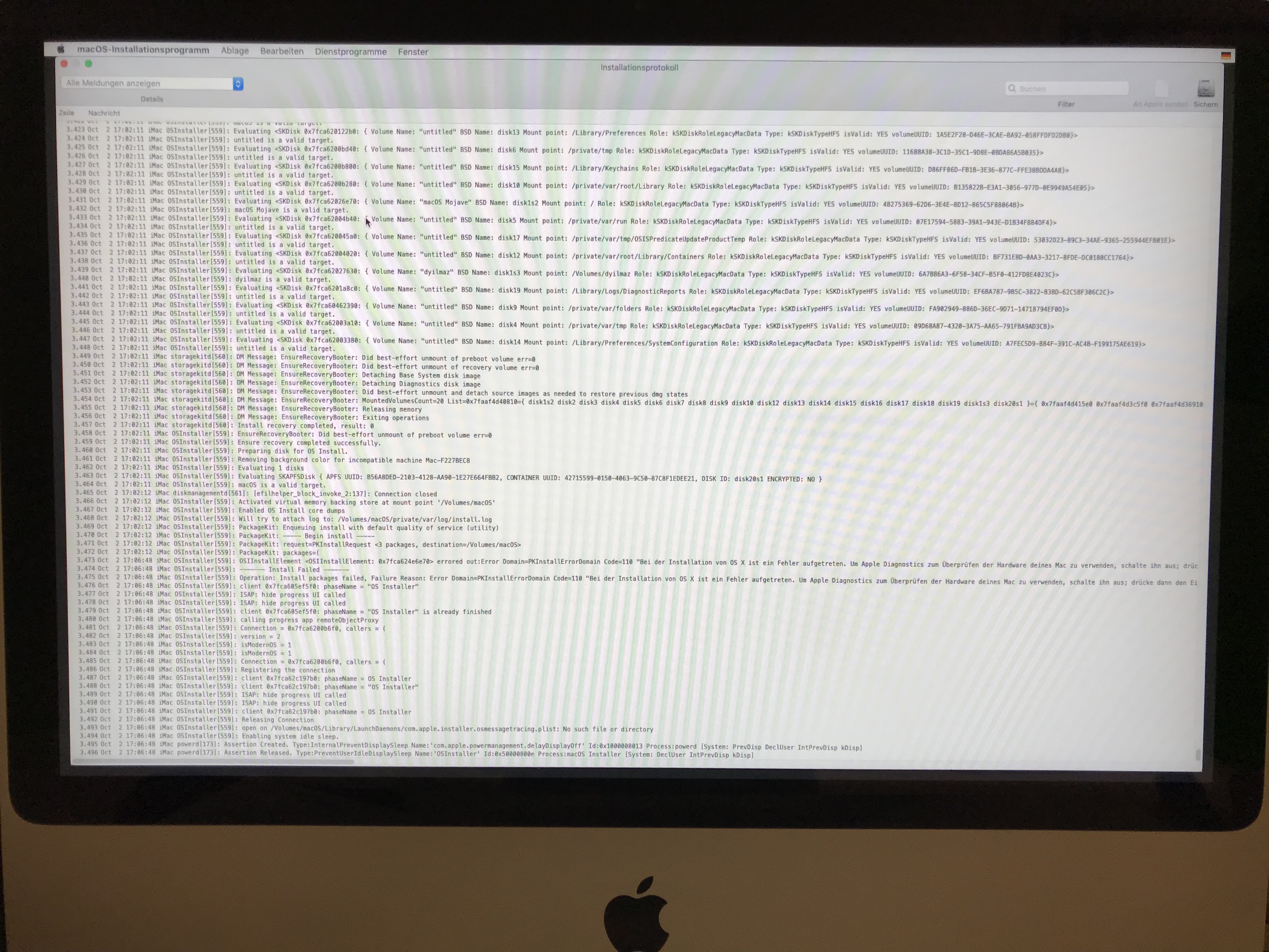

Hello everybody. I have an iMac 8,1 which I upgraded to 6GB RAM, SSD and a different WIFI card so I could use High Sierra. I tried to update to Mojave yesterday but it did not work. I tried today twice to install Mojave, but could not succeed. The installation always stops (or not actually really starts) and just says macOS could not be installed on this computer. I downloaded the Mojave image again and the patcher, and created a new USB installer, but that did not change anything. I have attached a picture of the errors I get. Hope anybody knows what‘s going wrong. Thanks
after replaced IOUSB**. iSight Camera worked fine! 🙂
