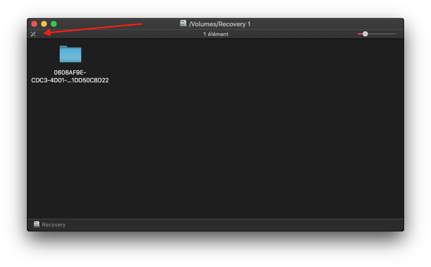

Then try this open Mojave Terminal and type:
sudo -s
diskutil mount disk2s3
open /Volumes/Recovery/
then open your "number-letters" (post a picture here of its content here) folder from Finder and replace the com.apple.Boot.plist with the one you edited on your desktop.
sudo -s
YES ! see my message above please
[doublepost=1541184395][/doublepost]Everything is working now (Until the next update ?)
