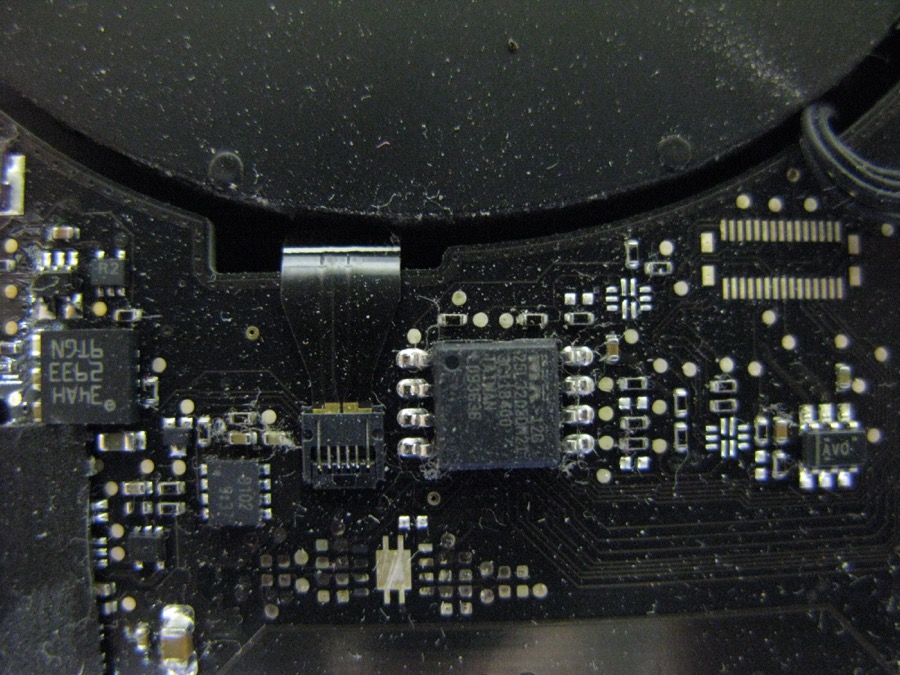

I'm waiting for the delivery (a few weeks). I'll do the unsolder/resolder by myself, I feel able to do it.
EFI ROM Patch Tool doesn't appears to be working well at 100%.
Why, I do not know, but for those who want I can share the Original and Patched DUMPS

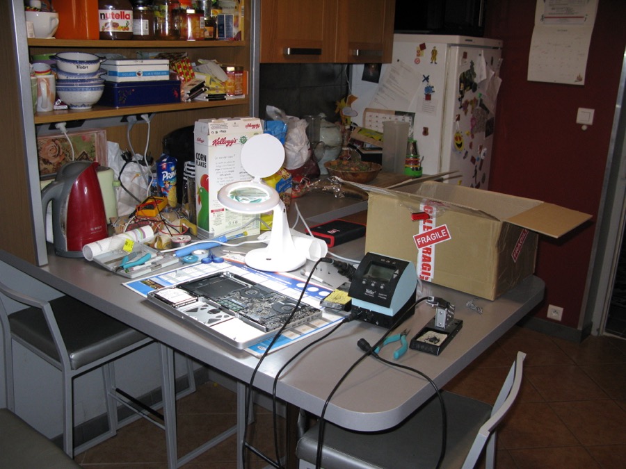

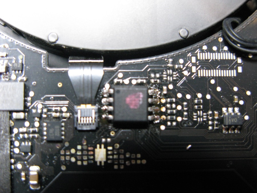

I received the chip Friday 28th! And wait a quiet home to do the surgery this evening.
Please, enjoy these 3 pictures of the before, after and « set up » !!

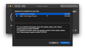

Update time! Yay! @dosdude1 can we update OTA fine?
I don't know yet... Just make sure you have a bootable patched USB installer on hand to restore the system if it doesn't work. Also, the patcher tool may need to be updated in order to make 10.14.2 installer drives. If this ends up being the case, I'll have an update out within a few hours.

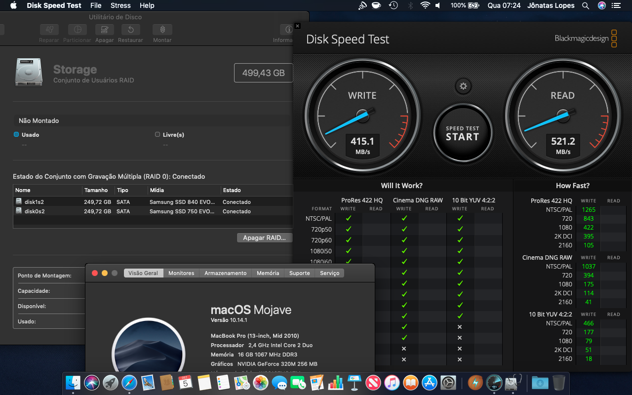

First of all, a big thank you to @dosdude1 and all the people involved in making it possible to install Mojave on unsupported Macs.
I just installed Mojave 10.14.1 on my MBP 5,3 with no drama at all using Mojave's Patcher. Setup went fine and everything works as expected (including the known issues, hehe).
I have a couple of questions:
1) Is the choice between APFS and HFS+ related to the ability to install OTA software updates?
2) Any warnings in regards of Software updates other than the fact that 10.14.x updates could break something?
3) Performance-wise what would be the best choice of file system?
Thanks!

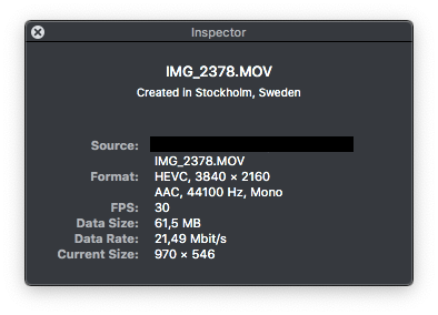

HEVC playback is only supported on relatively new systems running High Sierra or later.
Macbook – 2016 or newer
Macbook Pro – 2016 or newer
iMac – 2017 and newer
iMac Pro – 2017 or newer
27-inch 5K iMac (2015-2017)
Runs just fine on a MBP 9,1 Mid 2012 with Mojave..
Tried to play it on my cMP 2,1 running El Capitan but QuickTime Player automatically converts it (as expected).
With VLC, HEVC 1080p will play smoothly, 2160p is laggy though.
I guess it would be better to convert it.
The gpu on my 2,1 is a Radeon HD 7950 providing 3840 x 2160 @ 60 Hz
EDIT: Works flawlessly on my nMP 6,1 with High Sierra.
So apparently older machines do support HEVC 4K as long as High Sierra is running.

APFS is fast for SSD's. Users with HDD's are actually recommended to stay on HFS+ because APFS can create a noticeable slowdown.
Also, even if an update "breaks your machine", your data is still safe -- just boot from another drive and copy it off. Having a booting OS is irrelevant to having your files. Although backups are always important!
