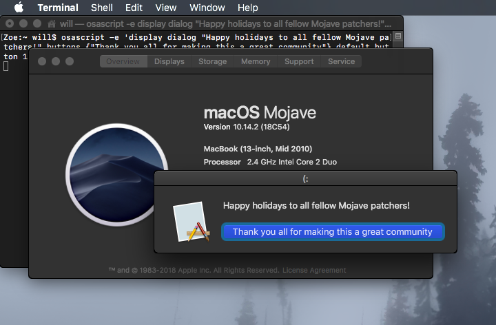

Happy Holidays to Everyone!
Didn't mean to spam on here, my favorite thread on this forum.
Sincerely!
You too!
And have a wonderful new year 🙂
(This is my favorite thread too. Already can't wait for the 10.15 equivalent!)
