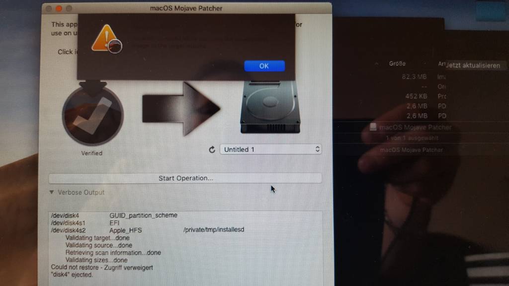

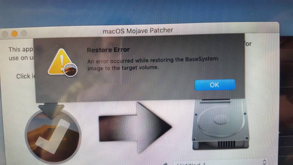

Getting this errror when trying to make a patched installer...
Downloaded 1.3.0 a few times and also mojave installer via tool..
Any solutions?
Any solutions?
I don't know, what's causing your problem but ...
In the past I sometimes had this error when preparing an SD card on a Mojave supported Mac or when using a Mojave image downloaded on a supported Mac via Mac App Store.
Since this experience I always download the latest version of Mojave with the patcher tool and prepare the SD card on an unsupported Mac. This way it always works reliably.
