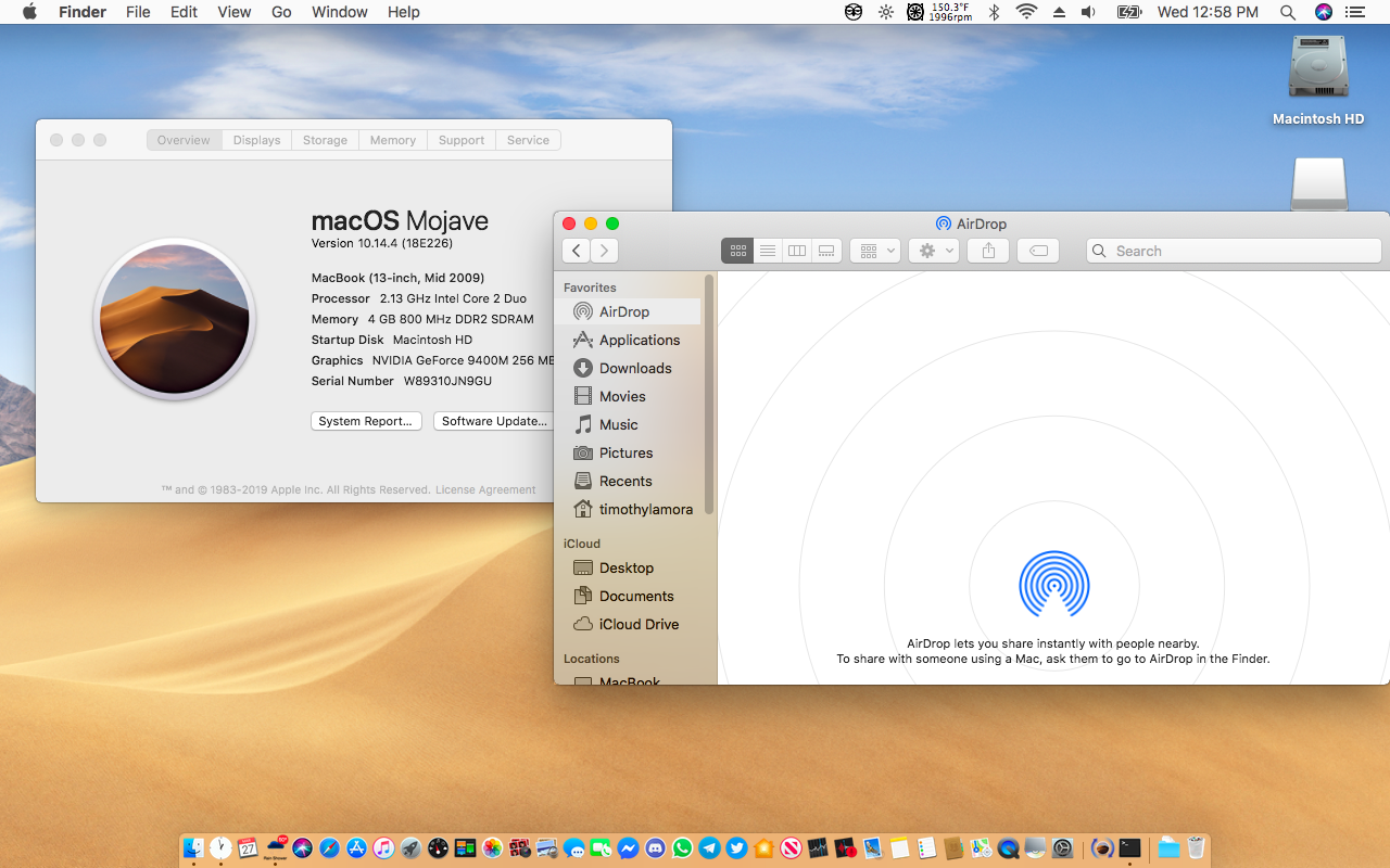

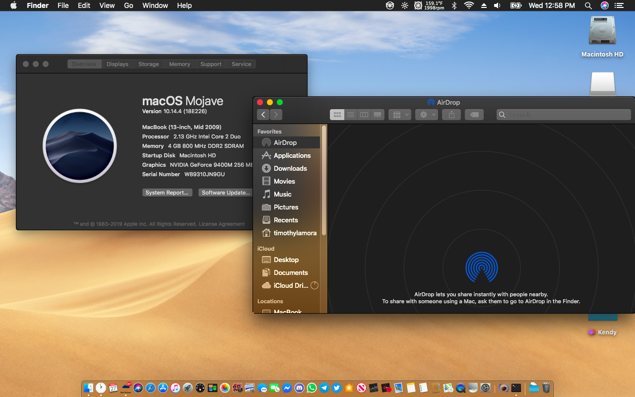

got 10.14.1 installed on my MacBook 5,1 thank you hybrid patches work as well hopefully Spira will have updated patches soon
