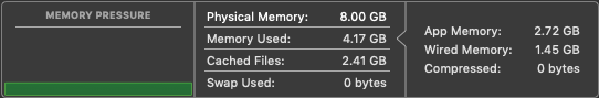

I am very happy to admit that I was wrong about 10.14.4. It seems that I wreaked havoc on my system by abusing Onyx.
I did a clean install of the 10.14.3 and then downloaded 10.14.4 update, at this point I created APFS local snapshot which allowed me to rollback to this point three times without having to re-download the 10.14.4 update(even when I know what to do I seem to miss steps all the time). I absolutely like APFS local snapshots, it takes 3 seconds to get back to where you missed your step. In short a success, I can live without Flurry screen saver(did not even knew it was not working until somebody mentioned it in this thread). Memory management is much better now.

To date my experience with .4 after applying the latest patcher post-install (1.3) has been very positive with or without my hybrid patches. And believe me, I run that mbp 5,3 through its paces with a large variety of applications.
In general, I hate applying retro-patches but so far I've identified the change in the .4 OpenGL and feel comfortable that running a .3 OpenGL+GpuSupport combo on a .4 system won't adversely affect it (at least up until now).
