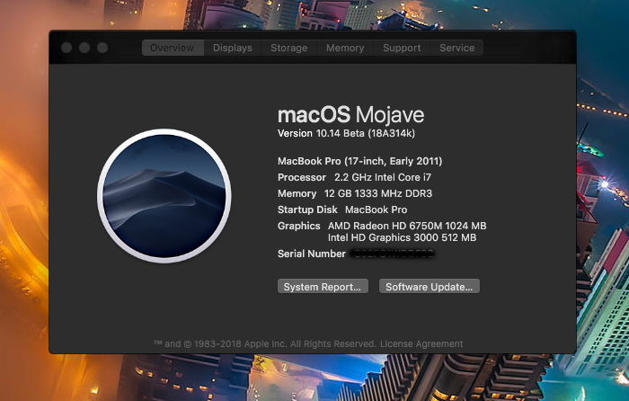

I have now an laggy AMD Support.
2011 MacBook Pro 17"
I create an install with the patcher then I use an high Sierra TM File backup...
but the AMD works not 100% I work now on the AMD kext files.
