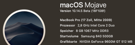

System: MBP5,2 17", SSD with APFS, APFS ROM patch applied.
System running well with 10.14.5b2.

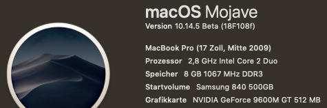

Thanks to RogueB for the instructions, and worth repeating what he said: All credit, and thanks, to @dosdude1, @jackluke, @ASentientBot, @pkouame and many others (in no particular order) for their amazing work and perseverance!
To start, cloned stable 10.14.3 to an external SSD (with CCC). 9600M GT GPU selected all the time.
- installed 10.14.4 over this with dosdude's patcher 1.3.0, applied post-install patches, no extra patch updater patches proposed
- updated to 10.14.5b2 OTA, applied 1.3.0 post-install patches again (and rebuilt caches)
- in single-user mode moved .4 CoreDisplay.framework to /System/Library/Frameworks (before, /sbin/mount -uw /). Used the framework attached to post #14339
- booted fine. Rebuilt caches with sudo kextcache -system-caches; sudo kextcache -system-prelinked-kernel (wasn't sure if needed)
The SSD with 10.14.5b2 is now on SATA and being used as my standard system. Fingers still crossed...
