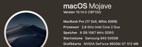

MBP5,2 17" 2.8GHz now running 10.14.5 final.
I've used the 1.3.1 patcher to download 10.14.5 and prepare a USB installer with it. Used this to install 10.14.5 over the existing 10.14.3, post-install w/ force rebuild caches.
Running happily so far with the 9600M GT GPU. I'll run jackluke's script from post #15045 tomorrow before further testing... thanks!
(PS: saw two processes SafeEjectGPUService, SafeEjectGPUAgent in the activity monitor. Maybe I just didn't notice them in earlier versions.)
