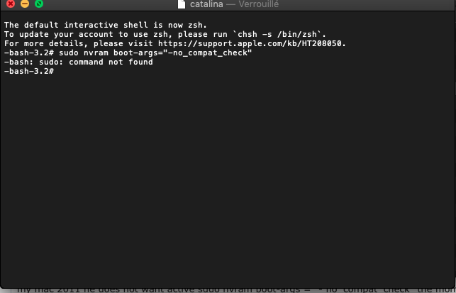

hello you can help me on this subject sudo nvram boot-args = "- no_compat_check"
and look at it in time I want to install cataline by USB

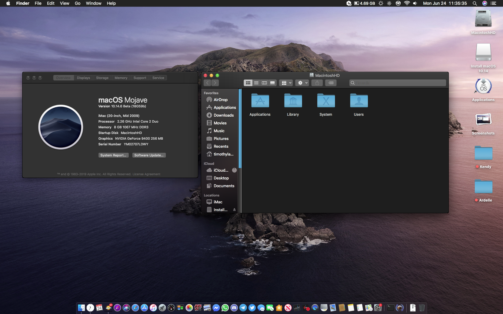

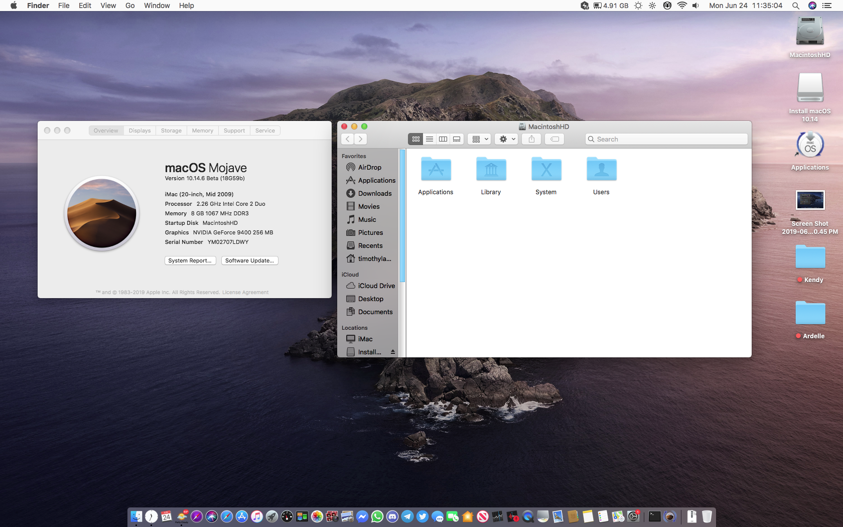

10.14.6 dev beta 3 successfully installed hybrid patches working as well 🙂
