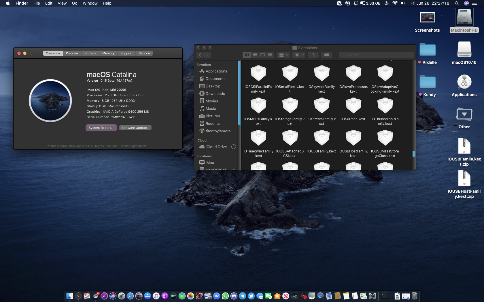

@TimothyR734 Any chance you can upload those IOUSBFamily.kext and IOUSBHostFamily.kext from the 10.14.6 Beta 3?
Hope these will work for you avz 🙂
Reactions: avz and anablaque

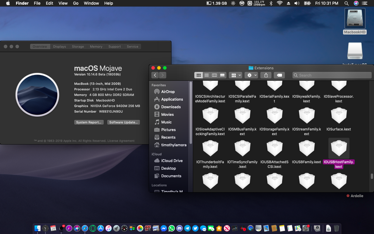

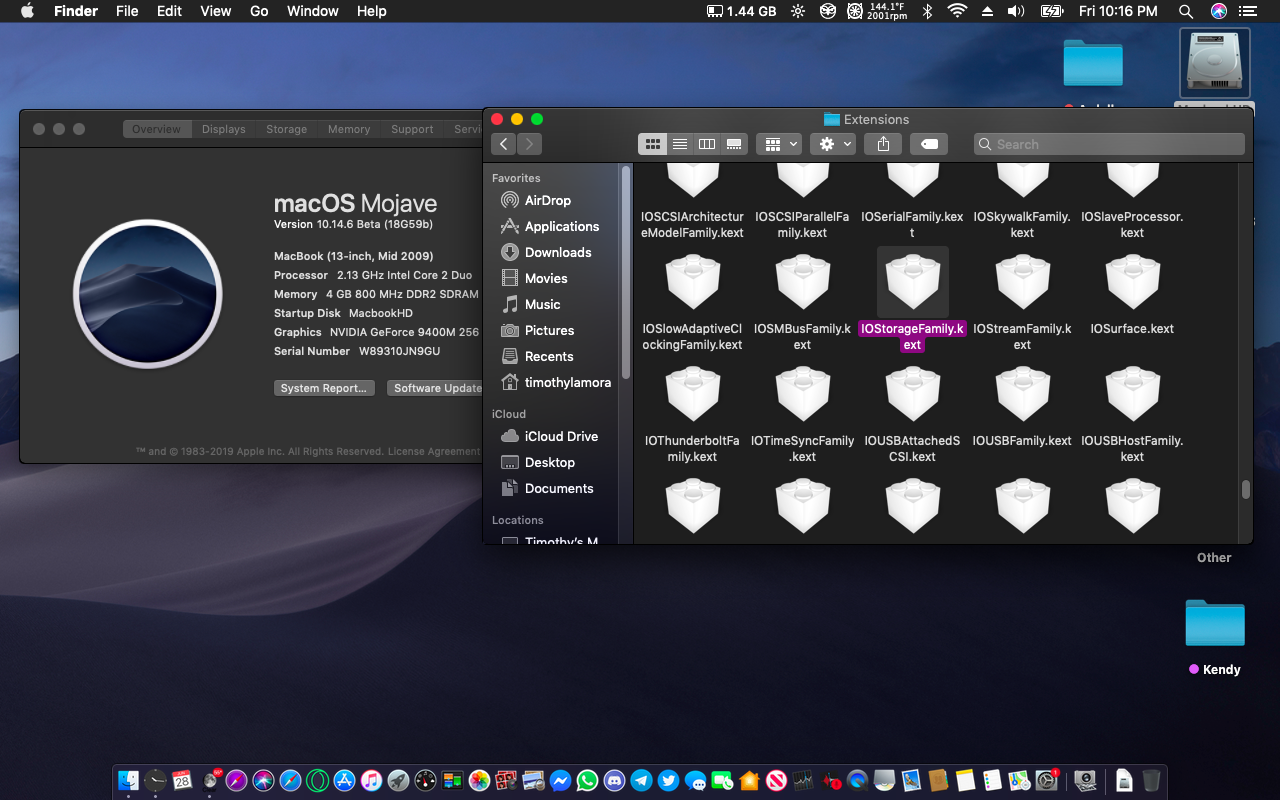

Hey @TimothyR734,
They appear to be from High Sierra, I am wondering how they ended up being in your Mojave 10.14.6 Beta 3?

Hey @TimothyR734,
View attachment 845575 View attachment 845576
The Info.plist and Version.plist of a kext most of the times are not updated by the OTA because they don't need, what matters is the Contents/MacOS's "Kext" binary exec that must be updated , so the files that @TimothyR734 has uploaded should be the 10.14.6 ones.
@avz on Mojave/Catalina the majority of my kext Info and Version plist are from 10.13 , because I often followed the OTA upgrade process, or upgrading over a previous OSX, so they are kept.
Reactions: TimothyR734 and avz
Yes, I found this very confusing as my 10.14.5 kexts have much later build numbers in info.plist and version.plist than the ones that he uploaded. The Catalina ones seem to have perfectly updated info.plist and version.plist. I guess I will just let it update itself at the next .6 Beta.
