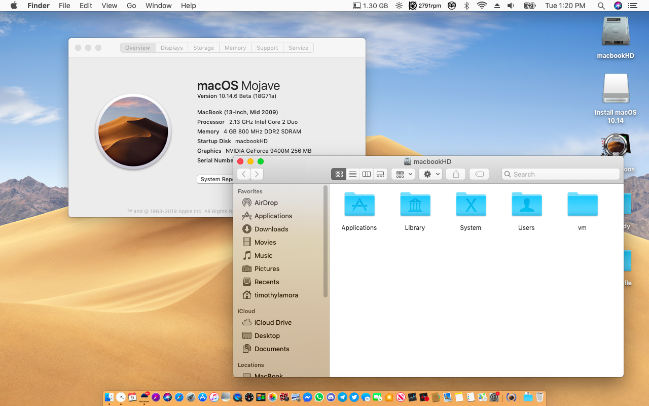

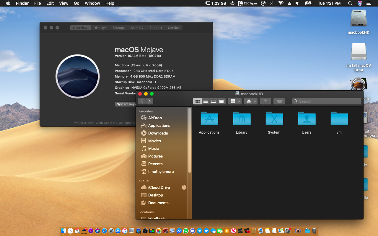

New macOS Mojave Dev beta available successfully installed but a bit more buggy got down to 2 mins of installation no process of the progress then went to 1 minute then rebooted so might be firmware updates with this one New+ taking forever to load FaceTime and iSight are working. iTunes , stocks, voice memo's work but beachballs while loading. Hybrid patches are working this one is the most memory hogging beta I have 4GB ram and with this beta I can barely keep 600 MB free something is eating it and much slower than 10.14.4 I think its worse 🙁

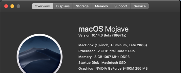

Successfully updated my MacBook5,1 to .6 Public Beta 4. For some reason the update came up as .6 Public Beta 3 in System Preferences/Software Update, but after the update it displayed as Developer Beta 4 in the Installations.
Could some please check the Gatekeeper, XProtect and MRT versions on System Information? A MRT update was issued last night and I want to make sure there was not another security update that might have failed to install (It has happened in the past on Mojave.).

All the latest security updates happened to be visible in my post above. There are no others.
